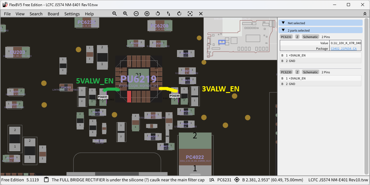

      Originally posted by m1ch43lzm
      You're missing both +3VALW and +5VALW, those are very important, if those are missing the power on sequence stops there
      Measure +3VALW_EN on PC6230 (may be missing from the board, that's ok)
      and +5VALW_EN on PC6231 (may be missing from the board)
      Those should be high level, 3.3V, if they're 0v something went wrong
      I've marked the location where you can measure those signals, in green for +5VALW_EN and yellow for +3VALW_EN
      PC6230 = 3.28 VOLTS
      PC6231 = CAN'T FIND (MISSING) ?

        PC6231 is also a missing component, but the solder pads are there, go back to post #131 on the previous page, the pictures are back , I marked it with a green line
        Ok, now the 3.3v are enabled, you should get now 3VALW
          Try setting your multimeter to volts, manual range appropriate for 3v, if it's auto range
          If manual range set to 20v range
          Just want to confirm if that chip is being told to enable the 3VALW and 5VALW outputs by the EC IT8227 (it's branded "Lenovo", a BGA chip which may have black glue on the corners, it it has the glue better not to try to remove it, as the pads on the PCB may become damaged)
          Inspect the area first for stray solder blobs
          Expected steady 3.3v on those enable signals
          Also check RE4501 and RE4505, should be 0 ohm resistors, or may be just traces, those feed 3VL to the EC

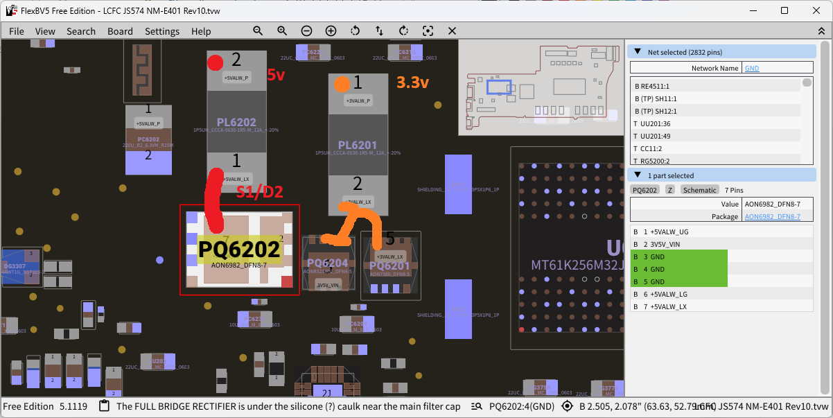

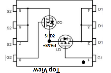

                                  #156
                                  Measure resistances between S-D, S-G, D-G on PQ6204, PQ6201
                                  On PQ6202 (it's a dual MOSFET, source from MOSFET1 is connected to drain of MOSFET2, referred as S1D2), measure resistance between D1-S1D2, S1D2-G1, D1-G1, and between S2-S1D2, S2-G2, S1D2-G2
                                  Measure voltages at PL6202 (5v), at the red dot, and PL6201 (3,3v) at the orange dot from the picture above
                                  The red and orange lines are where the MOSFETs connect to the respective inductors
                                  Also measure the resistances (in K ohms) across PR6209, PR6211, PR6210, PR6215, should be close to the value listed on the schematics
                                  PR6209: 13K
                                  PR6211: 20K
                                  PR6210: 30K
                                  PR6215: 19.6K
                                  Again check the enable voltages
Name:	5valw 3valw en.png

                                    #157
                                    Will do. Clarification: When you want me to measure resistance, this is with no power connected to the board right?
                                    When you want me to measure voltages, is this with just the charger plugged in, with the charger and the battery plugged in or just the battery?
                                    I want the info I give you to be as accurate as I can

                                      ⚠️ Warning, don't remove the MOSFETs or the IC yet, if you remove the low side MOSFET PQ6201 or the IC and apply power afterwards you will likely damage everything, as doing it will feed battery voltage to the 3v/5v lines
                                      On a buck converter circuit, all components should be present before attempting to power on
                                      I forgot to mention this, sorry

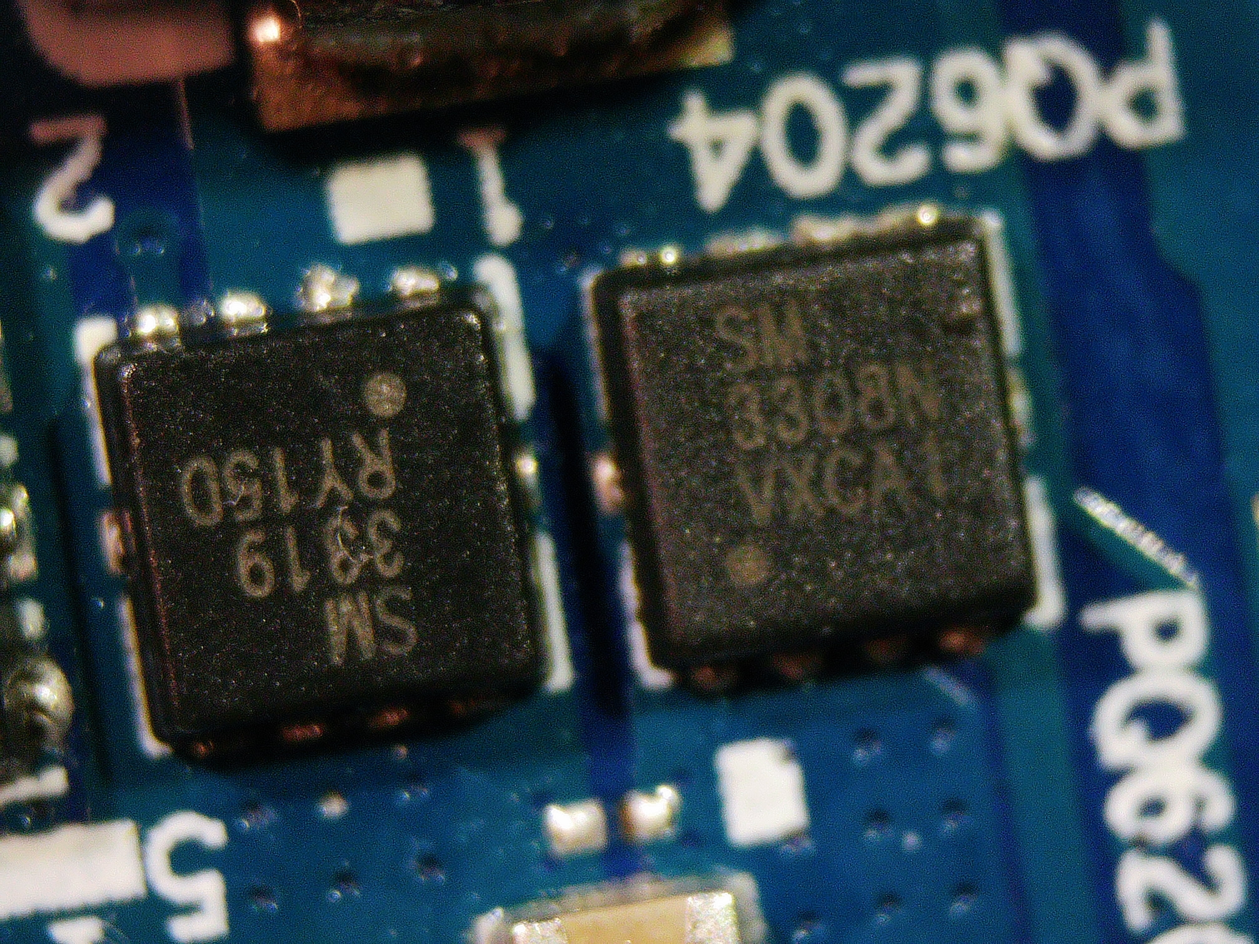

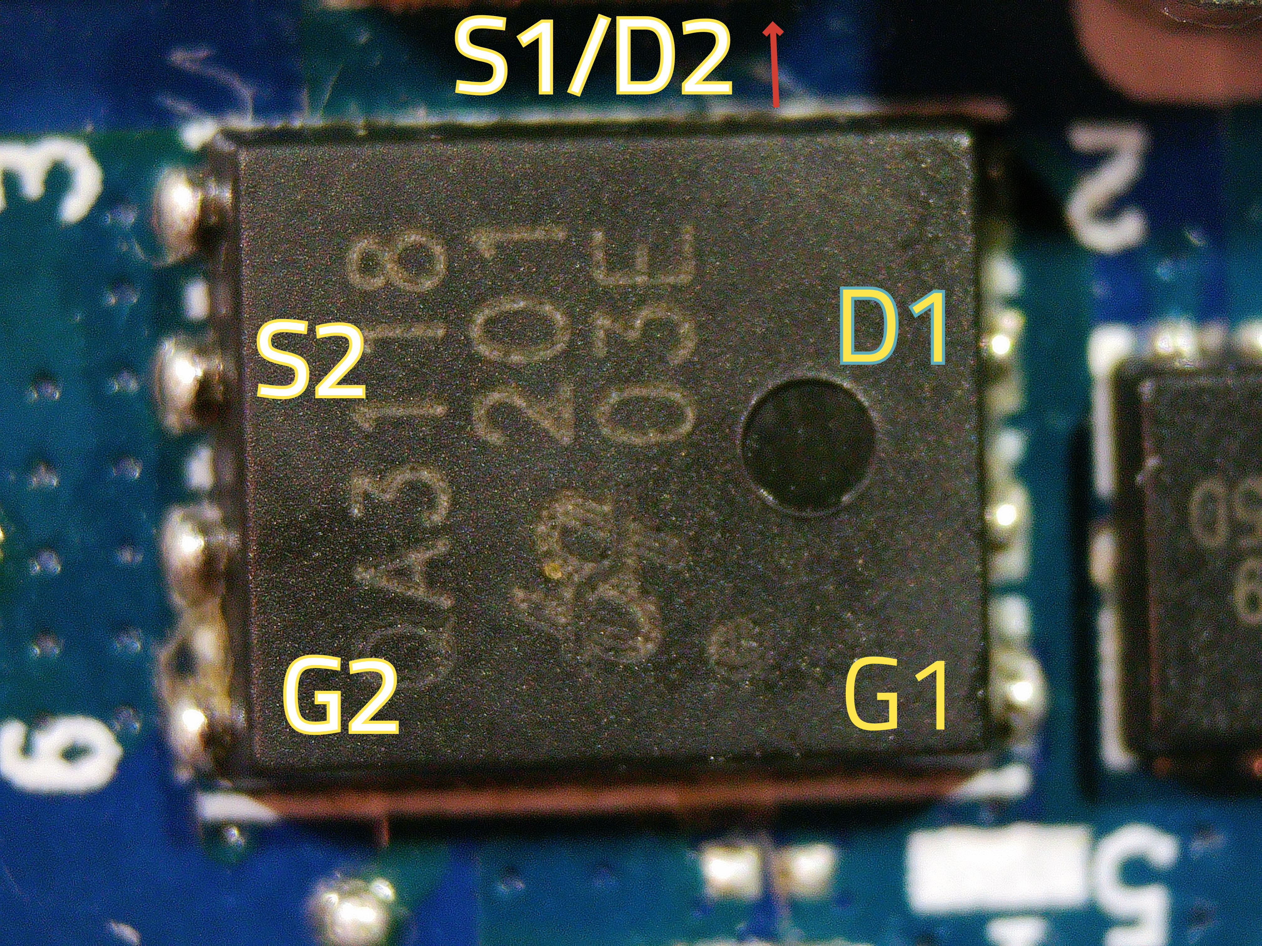

                                        #159
                                        Here are the resistance values you requested. The voltage values to follow After your directions from post Odd power issue related to bad caps? above.
                                        PQ6204 - S-D .7 MEG S-G 6 OHMS D-G .5MEG PQ6201 - S-D OL S-G 4MEG D-G OL
                                        D1-SID2 - 2.2 MEG S1D2 - G1 3.2 MEG S2-SID2 8MEG S2-G2 1.6MEG S1D2 -G2 3MEG
                                        PR6209,6211,6210 &6215, ALL WITH IN SPECS!
                                          That's bad if the resistance measurement is correct
                                          Click image for larger version  Name:	gate source.jpg Views:	0 Size:	200.0 KB ID:	3665844
                                          PQ6204 is the high side MOSFET, if it's shorted S-G hopefully the RT6585 detected the fault, that's why the 3.3V and 5V supplies don't work
                                          You can remove PQ6204 and measure it outside the board to confirm, set the hot air to 450-460 C
                                          With the MOSFET removed measure again S-G pads on the board, resistance should be higher
                                          If the MOSFET is shorted S-G outside the board, it's definitely faulty
                                          Always measure resistance without power applied, don't connect the battery/charger until the MOSFET is replaced with an appropriate one
                                          Charger won't work anyway as the TPS65994 is missing from the board
