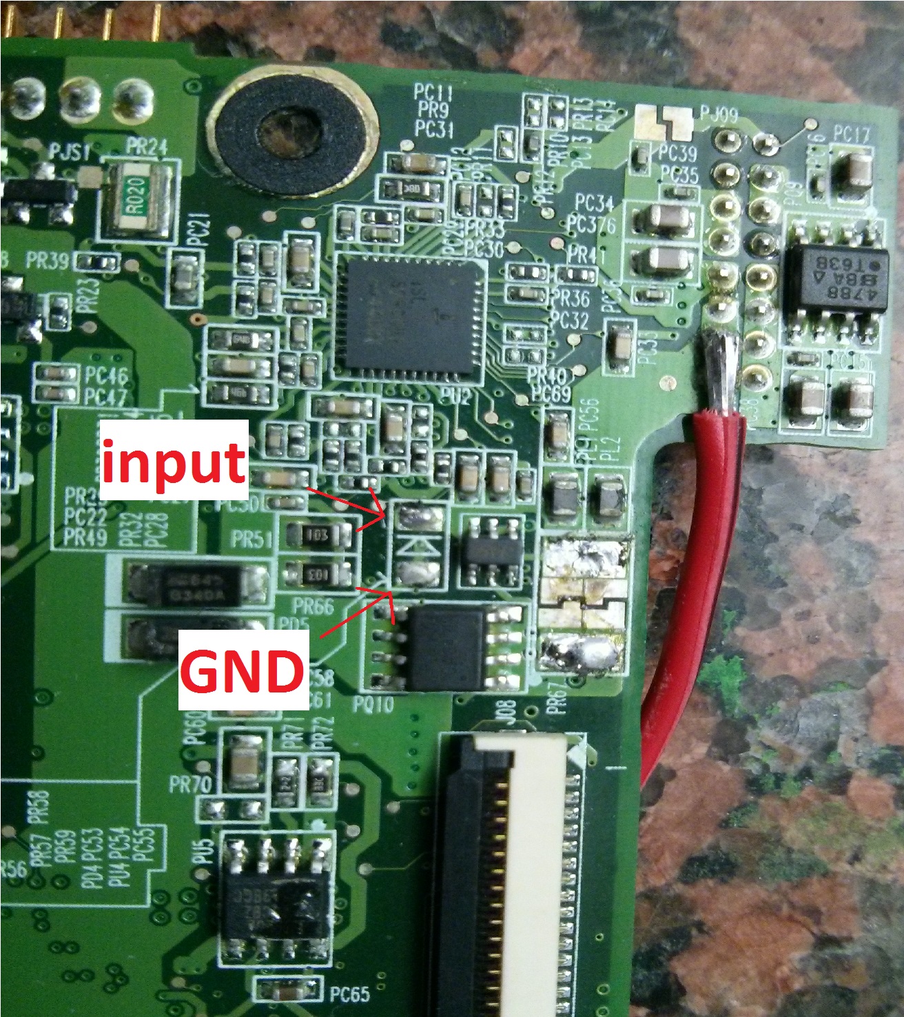

    Hi, I have this laptop and I need help to find with what to replace it
    Packard Bell mit-drag-gt2
    Motherboard Hannstar J MV-4 94V-0 0648
    It was in short-circuit and I found that the cause was a shorted diode. I removed it and it has no resistance no matter what direction (anode to cathode or reverse)
    With that diode removed, the board has no short-circuit.
    I haven't found any schematic for this board, and in the PCB under the diode is printed its symbol, so it's not a zener (attached pic)

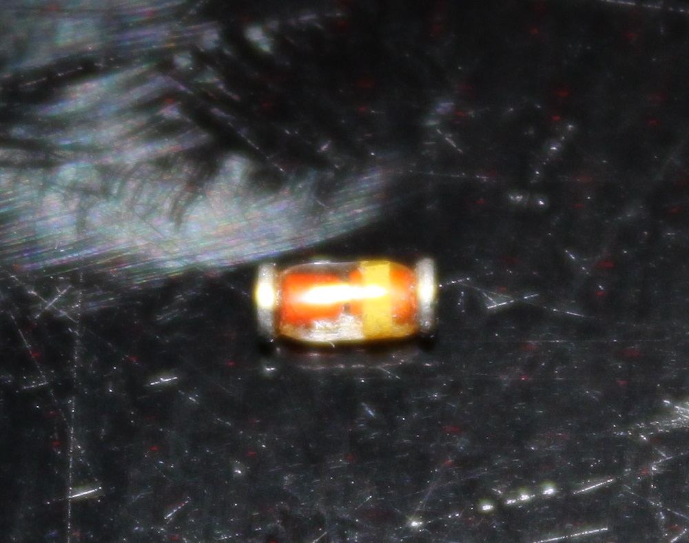

    The diode only has a yellow stripe on it. I found on other laptops what seems the same diode but with black stripe instead.
    Any help to identify it? Thanks

      Well looks like it may not be shorted - when you have worked that out this may help with ID
      http://www.marsport.org.uk/smd/sod80.htm

          The diode removed, shows 0 resistance no matter what direction. This is the same values measured when it was soldered, and what caused the short in the mainboard between the +19v input and gnd
          Looking in the link provided by selldoor seems that it should be a zener? but the symbol in the pcb where it was soldered is the symbol of a simple diode, not a zener
          Or could it be a switching one as that link says?

            So the anode is connected directly to ground and the Cathode is connected directly to the +19VDC input? Is that correct?
            • Ilyushin
              • Jun 2014
              • 11
              • Spain
              Re: Shorted diode, help to identify it

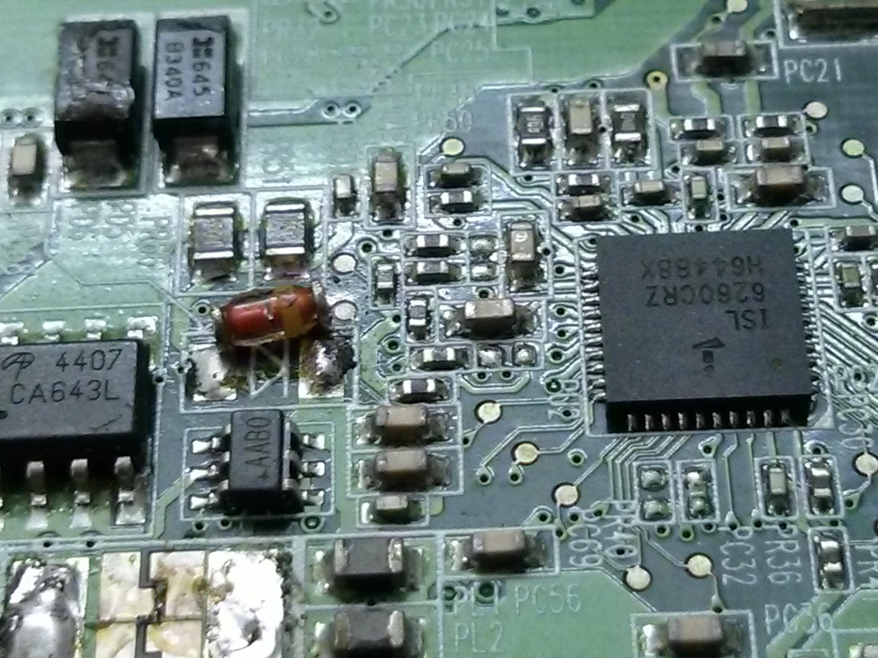

              Yes, Anode goes to GND and Cathode goes to the +19v input through 2 "PL" that are inductors if i'm right.
              Attached photo, where the red wire was soldered (for finding the short) is the +19 input

                      You have to ask yourself for why would a diode be connected to ground ??
                      Any chance you can follow and trace a circuit around it. It might help identify what its purpose was and figure out what it should be, rather than guessing what it was.

                            looks to me like it goes to r103 not to ground? there is a trace under your arrow?

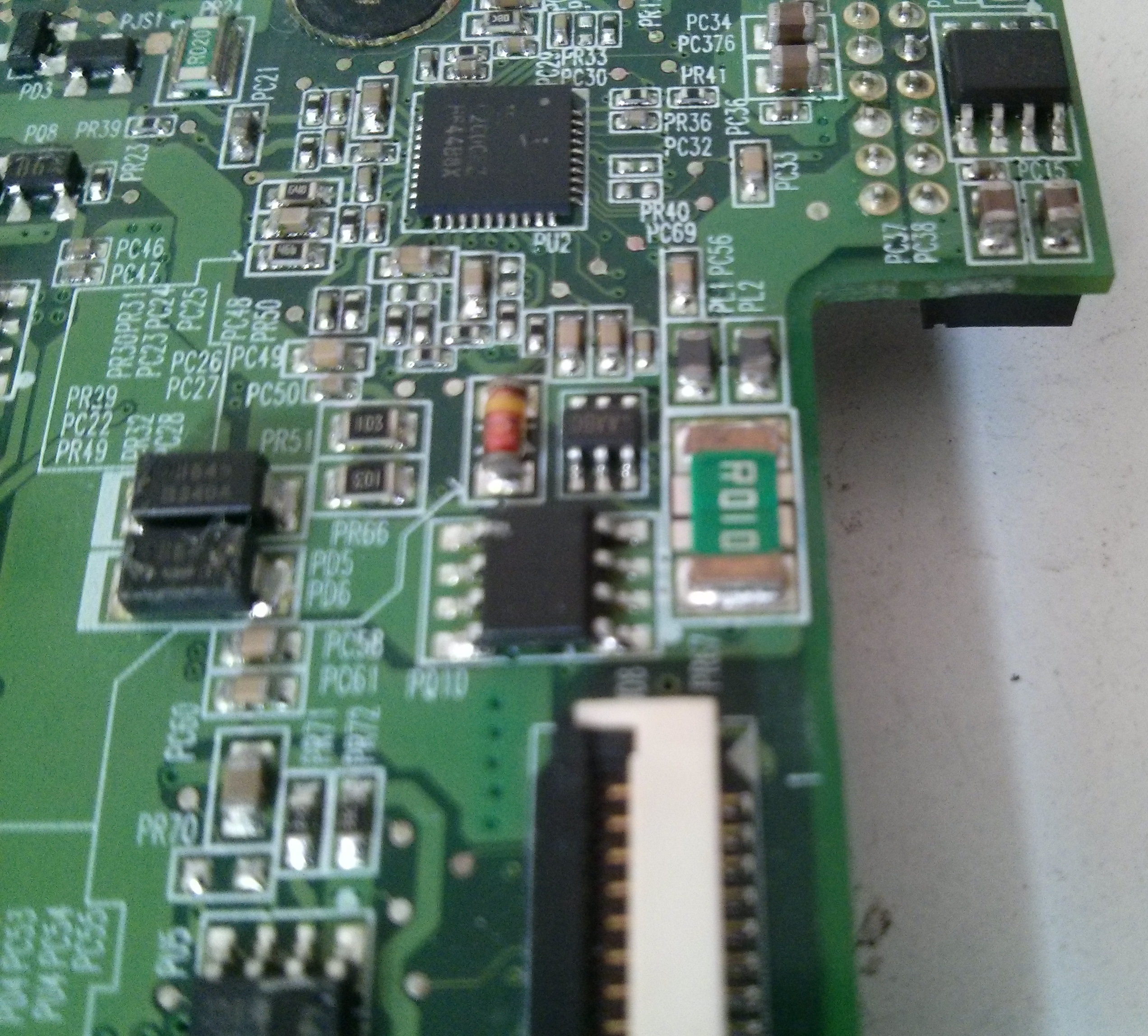

                                It looks to me from the pictures, the Anode is connected to two resistors (connected in parallel) PR51, PR66, the other two ends of the resistors are connected to the B+ large pad on the left side of the PQ10 (MOSFET?).
                                I doubt that this diode is used as a crowbar protection device in case the polarity of the power supply is reverse, which in that case, the Diode will be bias on and will cause the fuse to blow, the diode will be much bigger size to handle the crowbar current.

                                  Me too - I put the value instead of the board designator

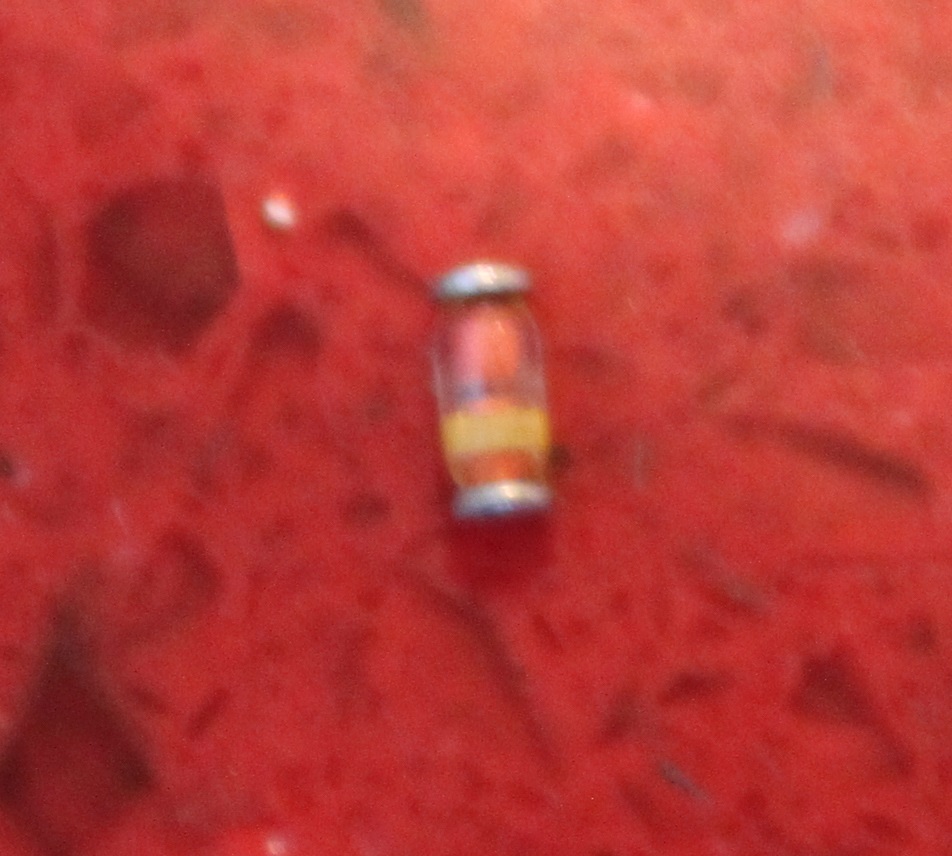

                                    So... I found in some monitor scrap-power board a diode that looked exactly the same, and that tested good when I removed it. (flow in one direction, not in reverse)
                                    I put in the laptop board and there wasn't any short-circuit. Then I ensemble everything, connect to DC adapter and there was a slight "click" sound.
                                    No power-up at all, and now the laptop board is again in short-circuit. I have done again the "method" to locate the cause of the short (bench power supply and where it got hot), and again is the diode's fault. Diode removed and no short
                                    So, any suggestions? what can be causing the diode to die "open"?
