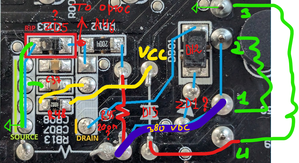

    Hey there guys. I've got a Corsair power supply that's come across my bench dead. I usually don't mess with power supplies, but it's a slow week so I'm giving it a whirl.
    Taking it apart I heard a screw rattling around inside, and when I got it apart I found a couple blown components near what I think is the 5VSB area.
    There's a 22ohm resistor that's melted and open, but it still has the bands.
    The other part is a zener diode and it's top went to jesus, so I can't read the marking.
    It looks like the diode connects the source and drain of a TNY284 through a couple of 2M resistors and a transformer winding.
    Does anyone know what a good value for this zener would be, and what it might be doing?
    Any help much appreciated!

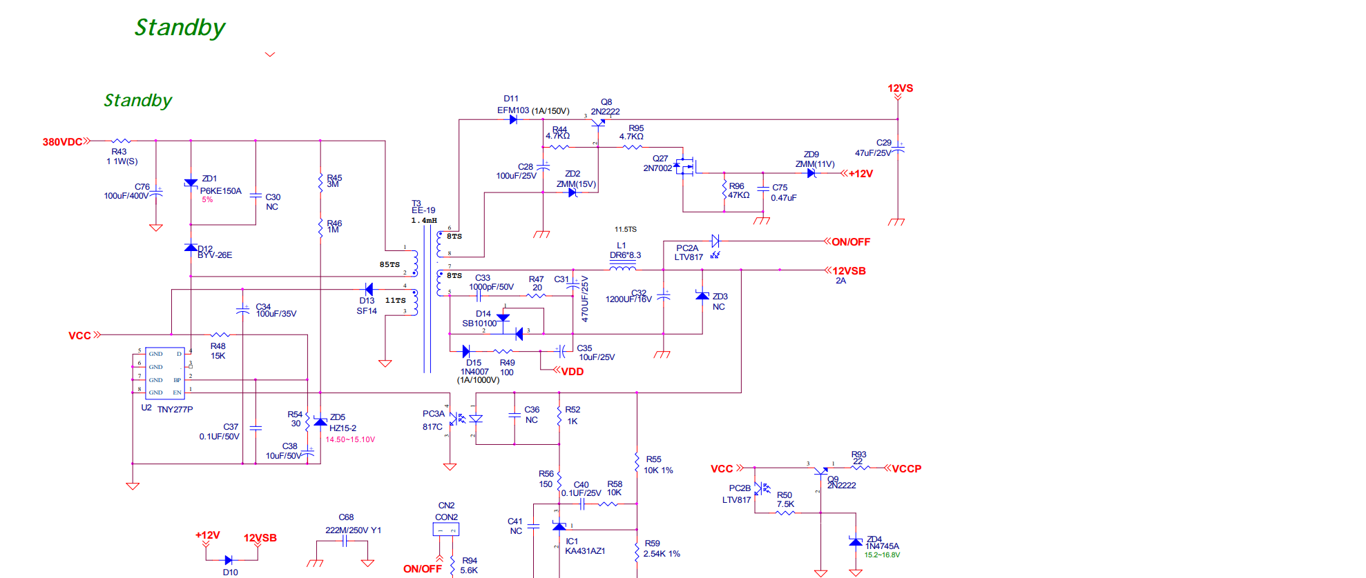

          I don't know will it help or not.
          This is from CM6502UHH PFC controller typical application circuit and it has TNY227P.
          Resistor is 2M (r45 + r46). On your photo something is behind.
          My wild guess it is sort of hz15-2. Enable pin should be connected to optocoupler.

              This is a big help. I'm away from it until Monday, but I'll answer the questions I can remember.
              To optoc? Yes
              20 oh? Bands on resistor are red-red-gold-gold-white. Which I think means 2.2ohm. (see picture)
              Source to gnd? I don't think so. I checked for shorts, and I think source wasn't connected to ground.

                I made a mistake on pic above. Its not 200M its 2M. But overall it fits.
                btw I cant find what is red-red-gold-gold-white. We need some1 to explain.
                  changed 200m to 2m.​

                    I think the resistor is a 2.2Ω fusible resistor, it looks like it did it's job and is no longer a resistor

                        I could be wrong of course, these "special" resistor bands take a bit of guessing: the best way is to have more of the schematic available.
                        Right now I can't see where it connects to so I have no way to make a better educated guess.
                        But if it is before or after the source or drain for example then it is acting as a protection if the MOSFET in the TNY284 gets stuck on...
                        (And if you look at the top-side photo above it seems the PCB around the drain leg is discolored so I'd say this is what has happened).
                        And welcome to Badcaps btw and good job so far with the circuit

                            It looks like the resistor is a 2.2ohm fusible. I couldn't find the exact one, but this is close: https://www.digikey.com/en/products/...52-2R2/2167125
                            That resistor is connected between 380V and Drain, so yup, it looks like it went pop as intended.
                            Source is connected to GND, and ZD5 connections match, so I think you found it! This looks like an OK replacement: https://www.digikey.com/en/products/...C15-7-F/755469
                            I can't find any shorts, so I'm going to order the diode, the resistor and a new TNY284 and hope for the best. Will report back in a week or so.
                            Thank you both!

                              Measure the optocoupler in diode test mode with your multimeter: since the failed ZD5 zener is parallell to it (talking about the example schematic that c1q3 posted here).
