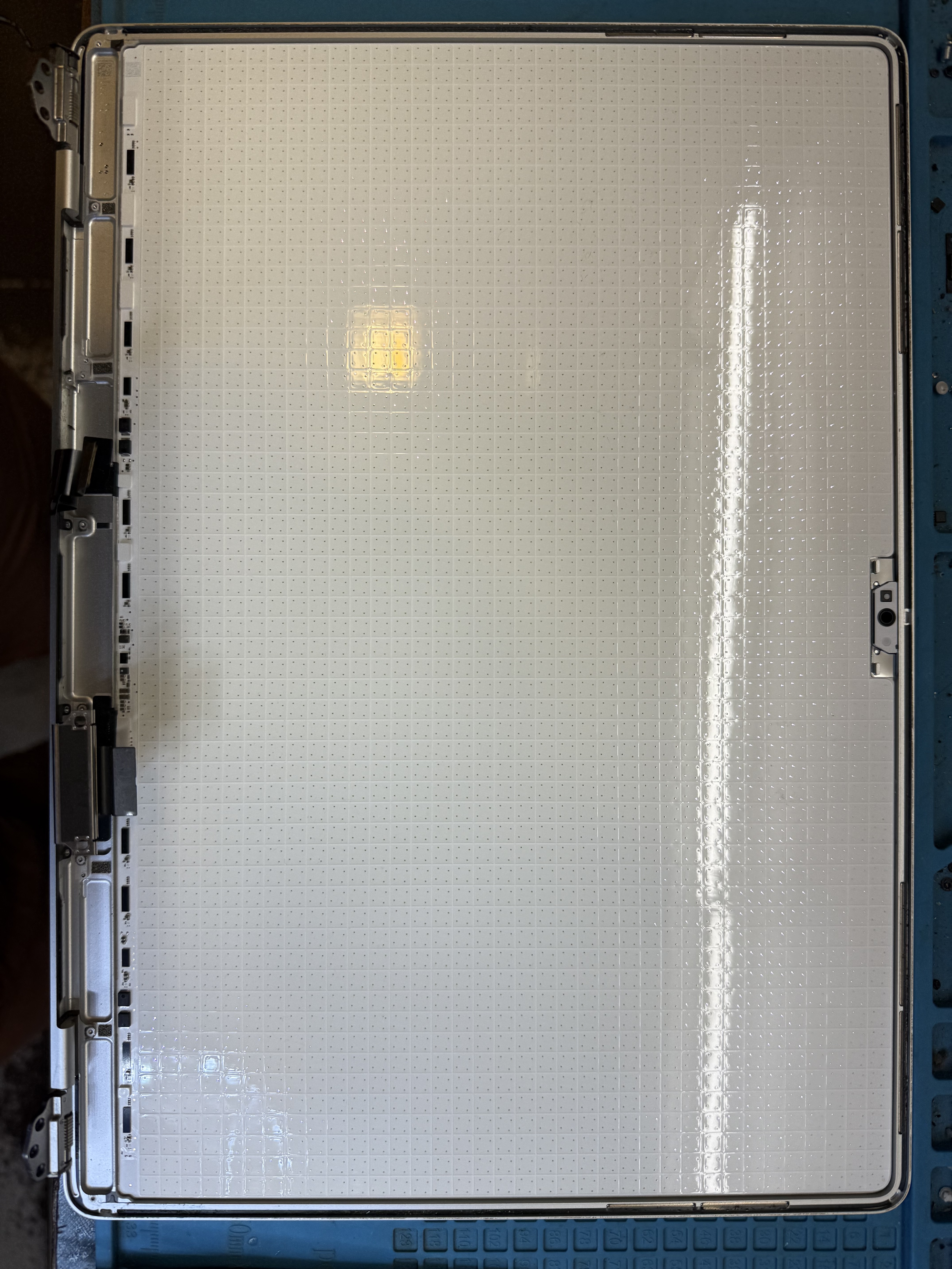

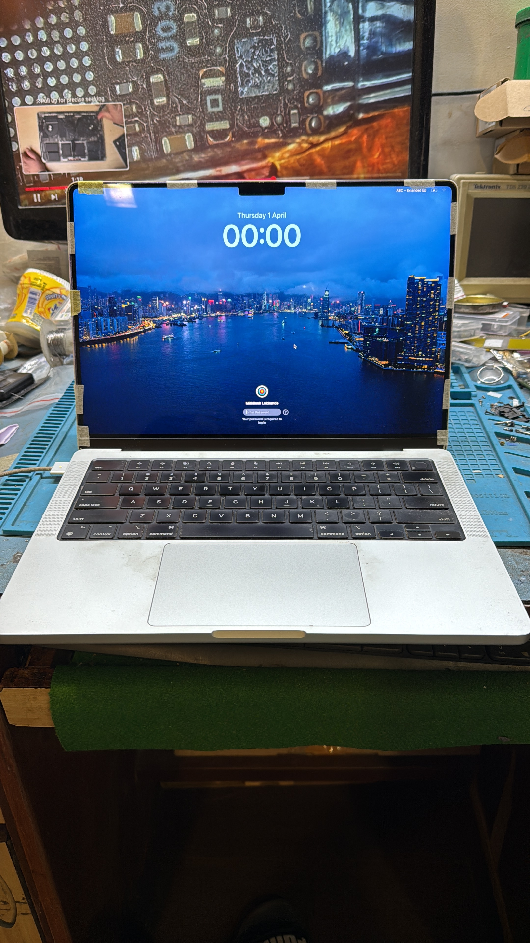

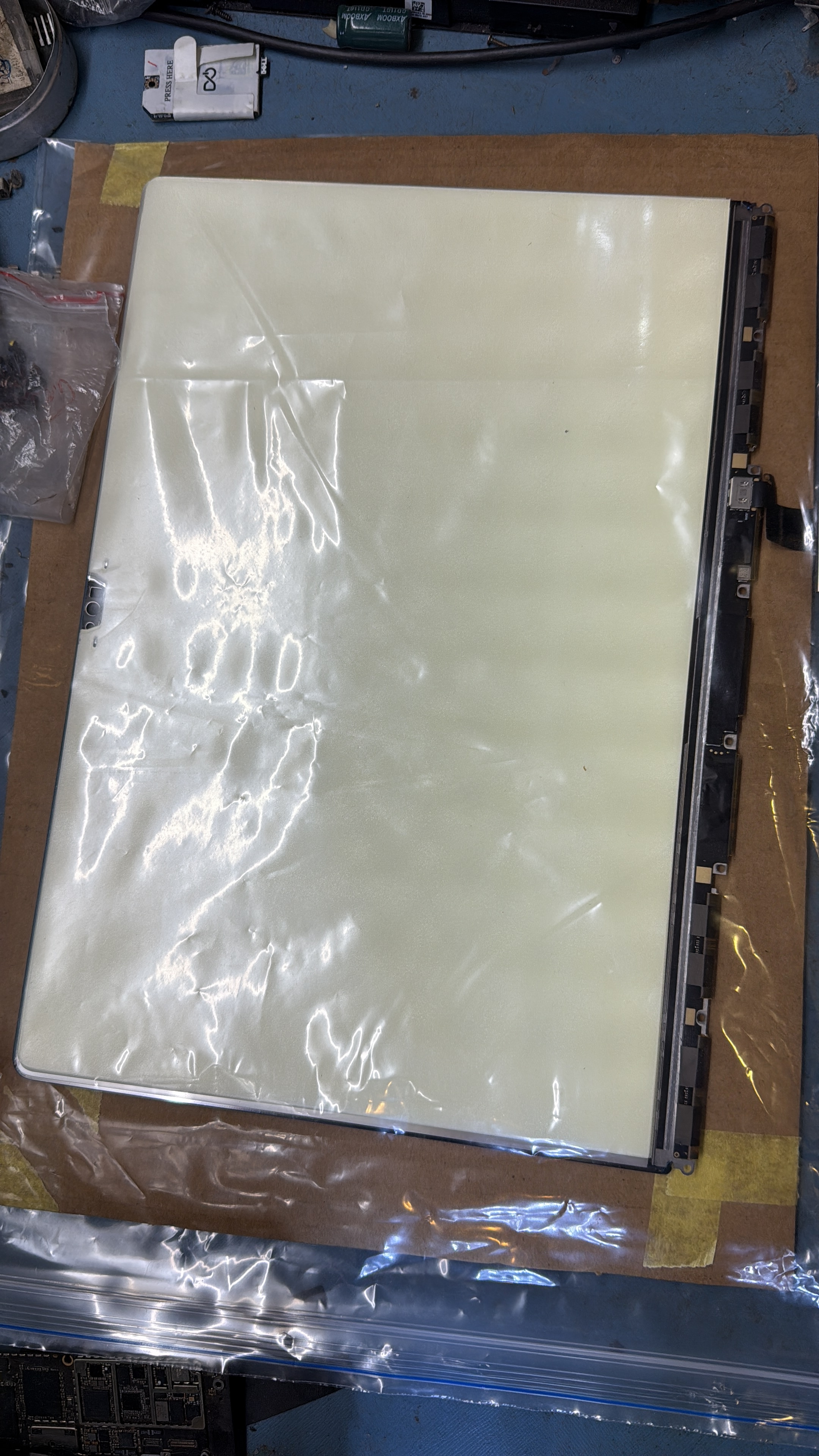

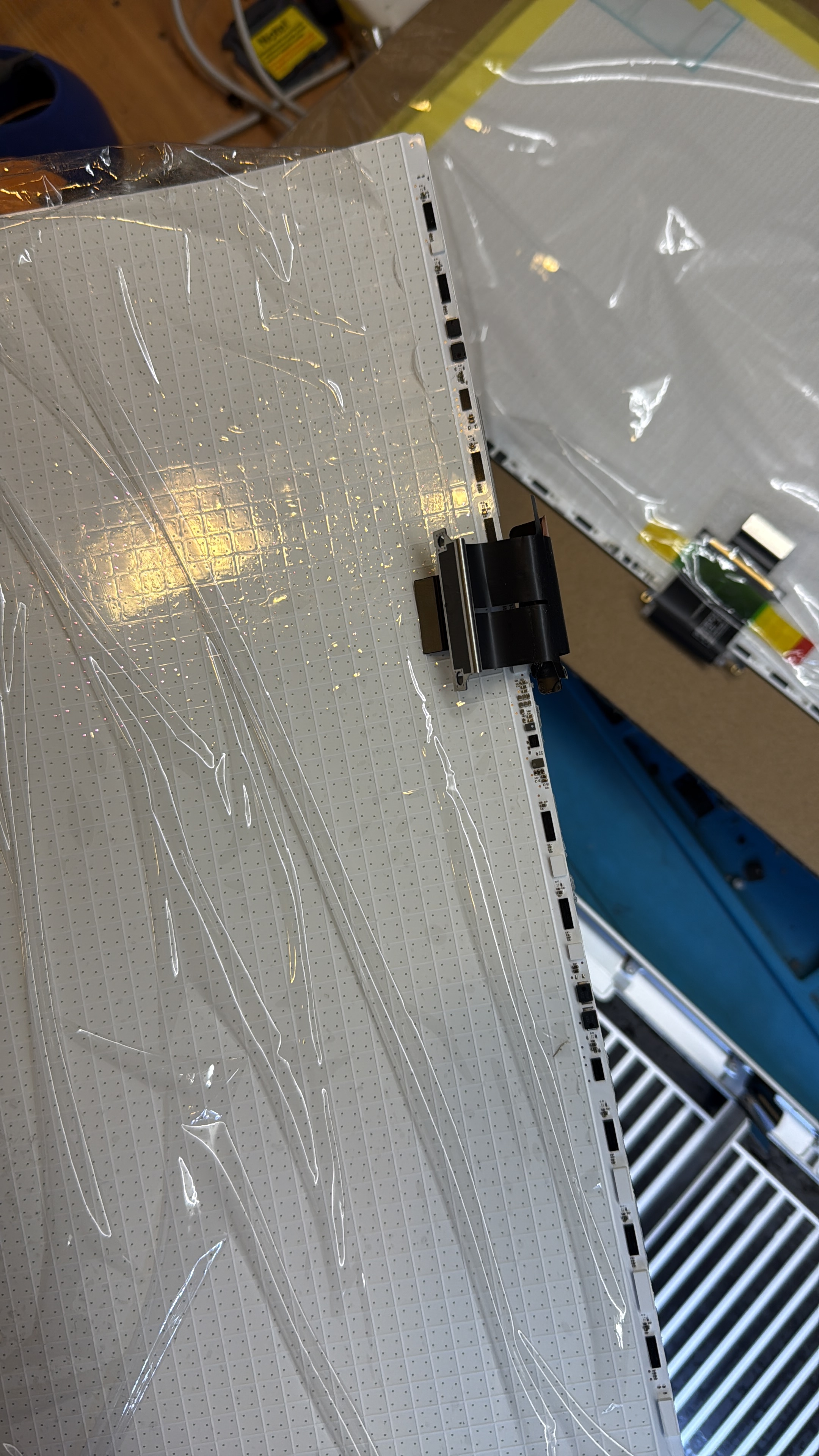

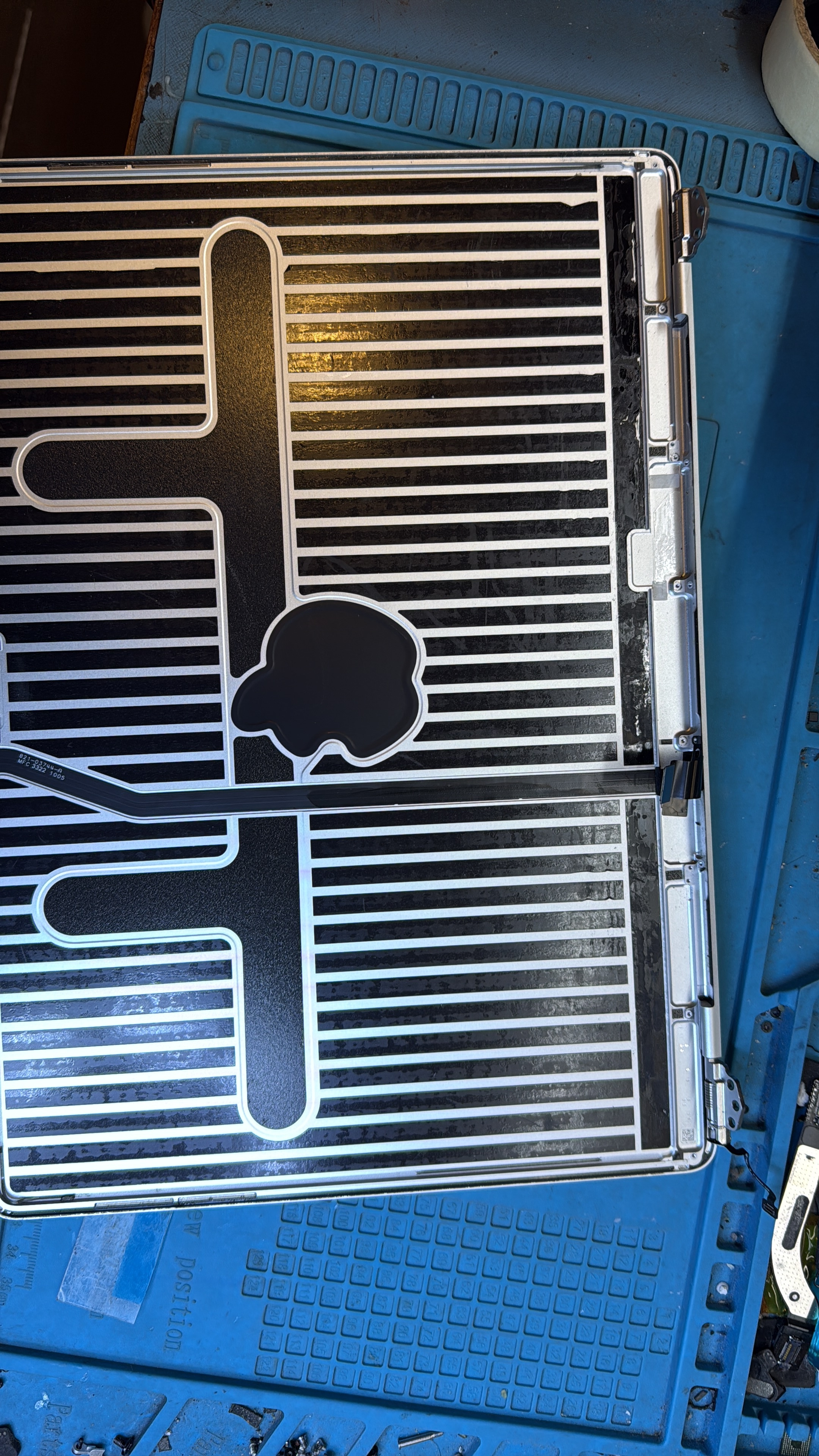

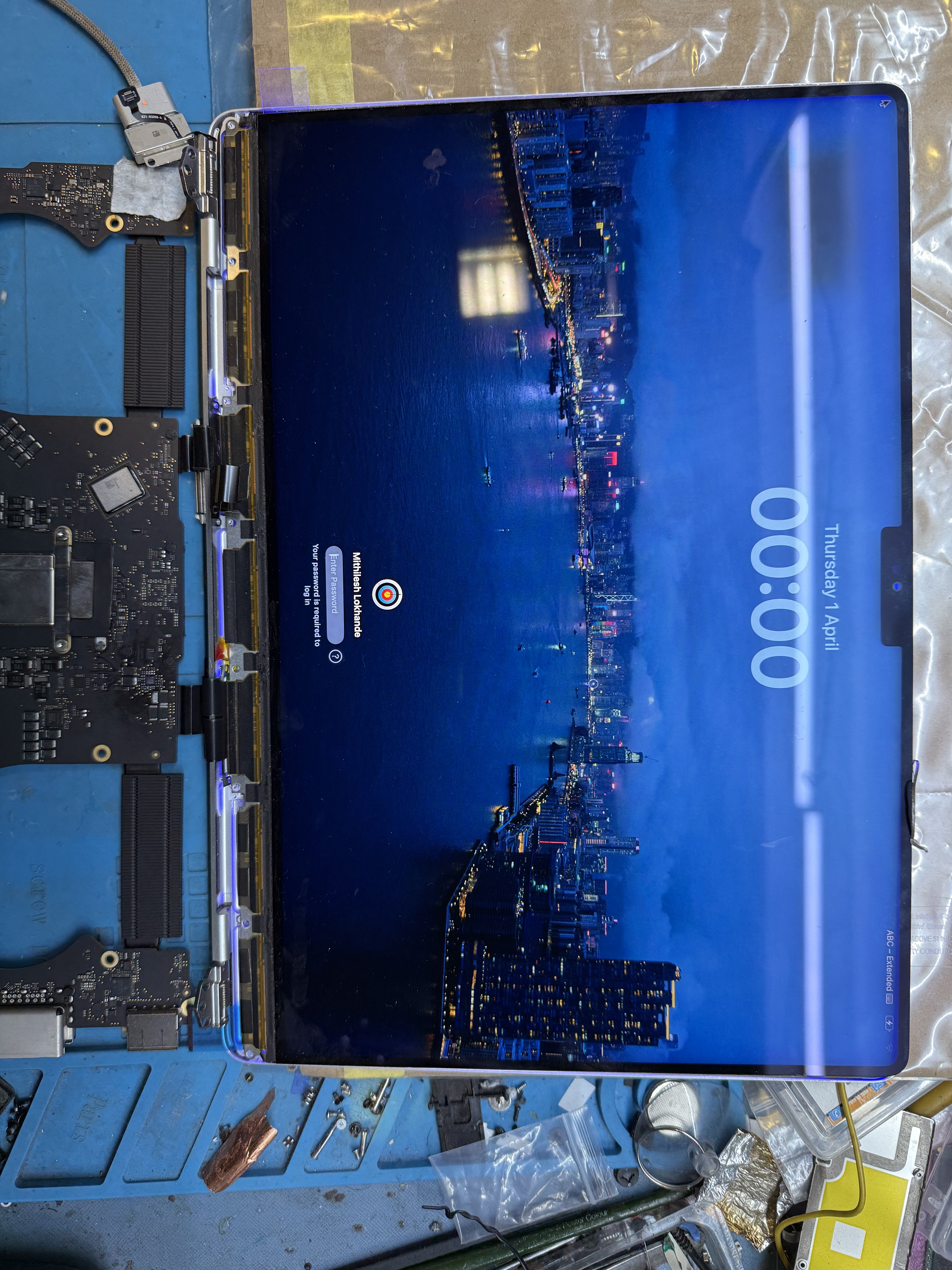

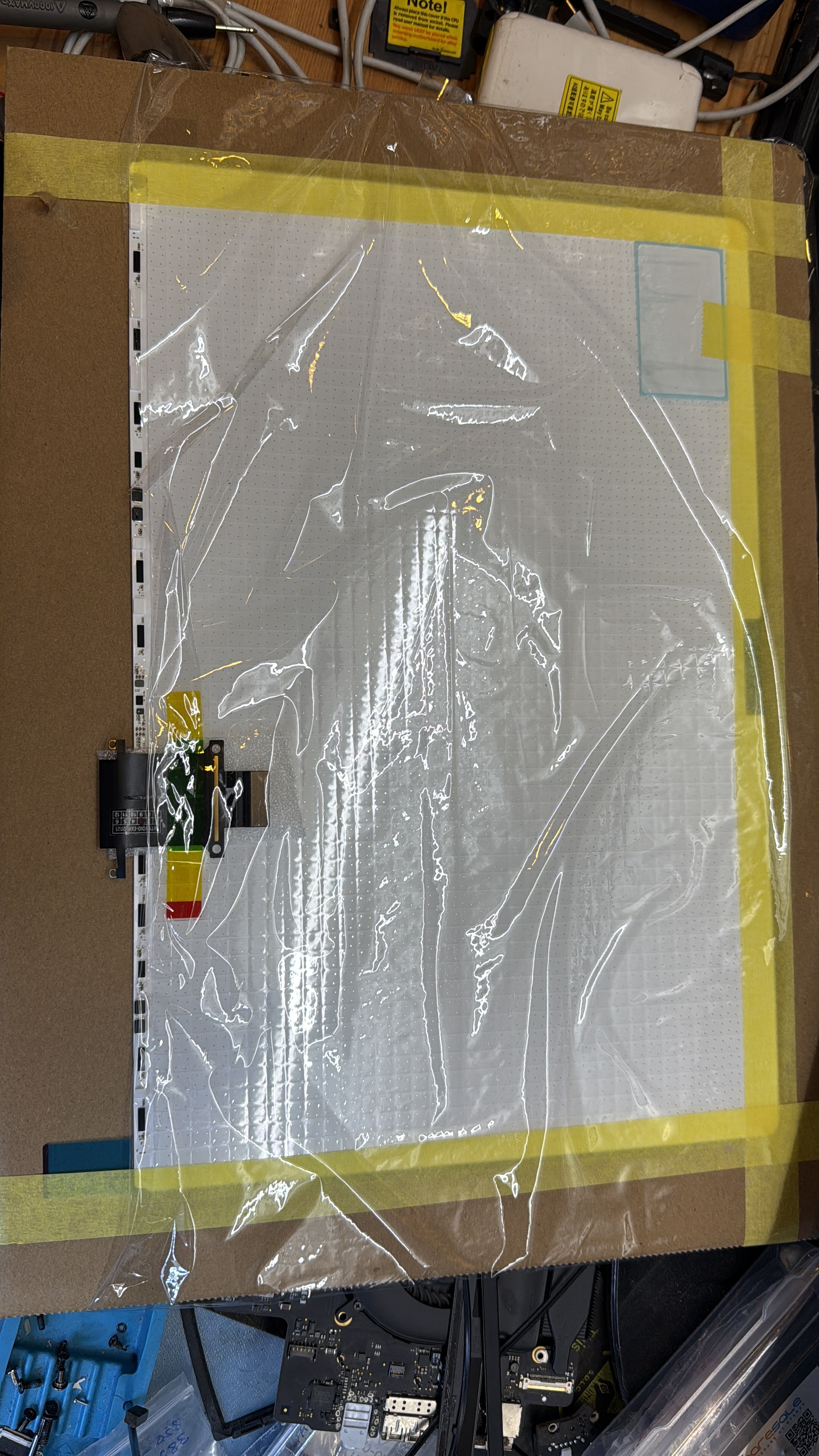

                                Hi all
                                okay this is very a complex backlight problem they have a very thin led backlight circuit booster inside . I have finally opened the screen carefully and now will change the backlight board inside. Attaching photos so most of us know how deep we are going with this .
                                cheers Click image for larger version

                                      Finally this led backlight they have made controls every cell of the led on the board like when we switch on the apple logo you have only the center led come on and the. The entire backlight lights up .also the colour of the led is blue.now the only thing is a need the right tape to seal can anyone tell me which tape and the size
                                      thanks all

                                        Also if the lid sensor is disconnected the backlight will come
