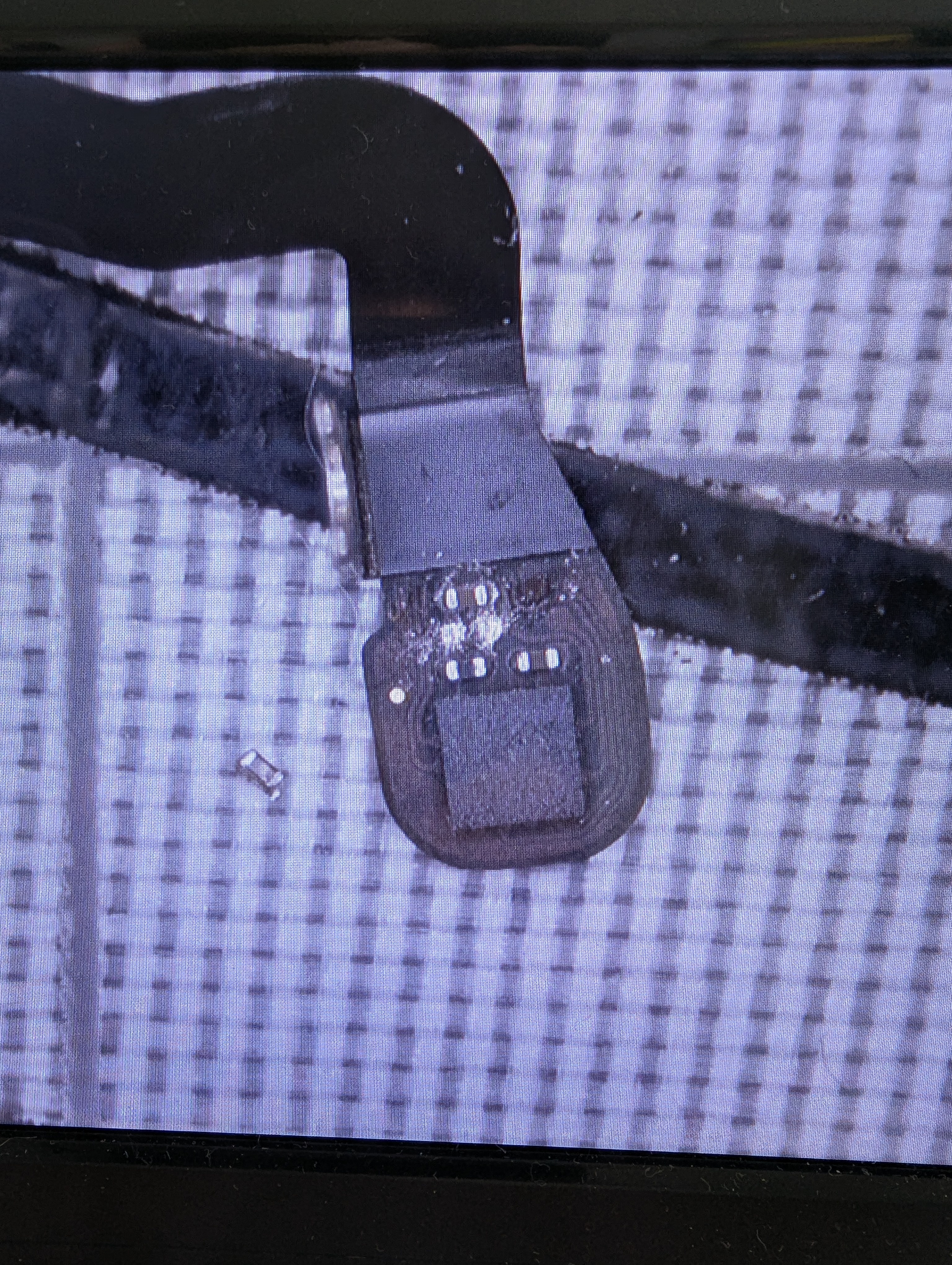

                              I took the sensor out and while testing a cap just came off. I will try to clean everything and solder it back first but maybe i have to get a new cable and transfer the chip.
                              And more observation i can't Start the MacBook with the power button. I have to use a USB or magsafe cable to make it boot. After this i can removed it and it works.
                              So does this also come down to a non working lid angle sensor?

                                Yes, the fault can be linked to the angle sensor. If my fading memory is correct, I recall an open-source (Arduino) github project to calibrate the lid sensor. Apparently you can also purchase these angle lid sensors from 3rd party but need to calibrate the replacements. There is at least one YT video on how to align the sensor without tools. Without proper alignment or operation of this sensor, the board will assume the lid is closed. I will try to see if I can hunt down the article but believe it is the nerd tool device. It is very possible that the project is no longer open source. Fairly confident it was ESP32 module based and full code was posted.

                                  So before i get any programmer getting a 3rd party cable and transfer the data chip from my faulty cable would also solve this calibration? Found some videos where they did this.

                                      My new angle sensor cable arrived, i changed the chips and with charger connected the Macbooks starts when i open it up but still no display. -.-
                                      Is there any way to make sure that i have to change the whole screen?
