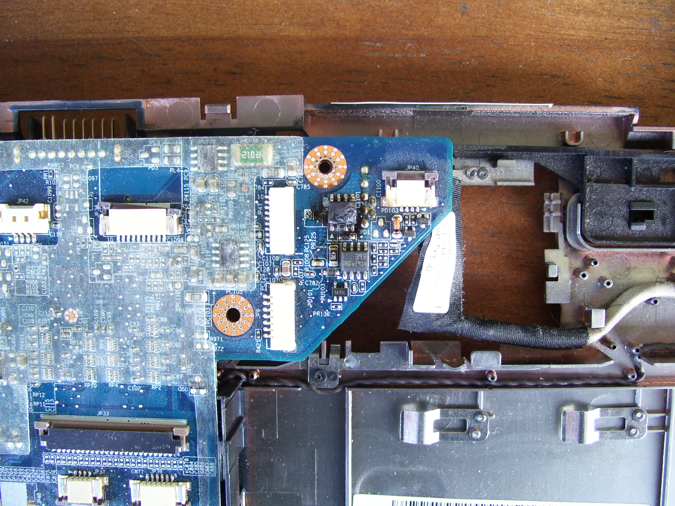

    HP DV4 no power, burnt component maybe get lucky
    I would like to find out what part number this is and replace it! I'm almost sure its a set of fets in that little 8 pin package...
    Anybody out there got one of these boards in the scrap pile and could verify part numbers maybe?

    Re: HP DV4 no power, burnt component maybe get lucky
    and the mobo code?
    how can you read a schematic if you don`t know the motherboard code ?
    and when its PQ usually (for me was always a 30v N-channel mosfet)
      These tend to come in pairs so possibly the same as the one below in your picture
        If the mainboard is LA-4101P then it is P-channel mosfet.
        http://html.alldatasheet.net/html-pd.../AM4835EP.html

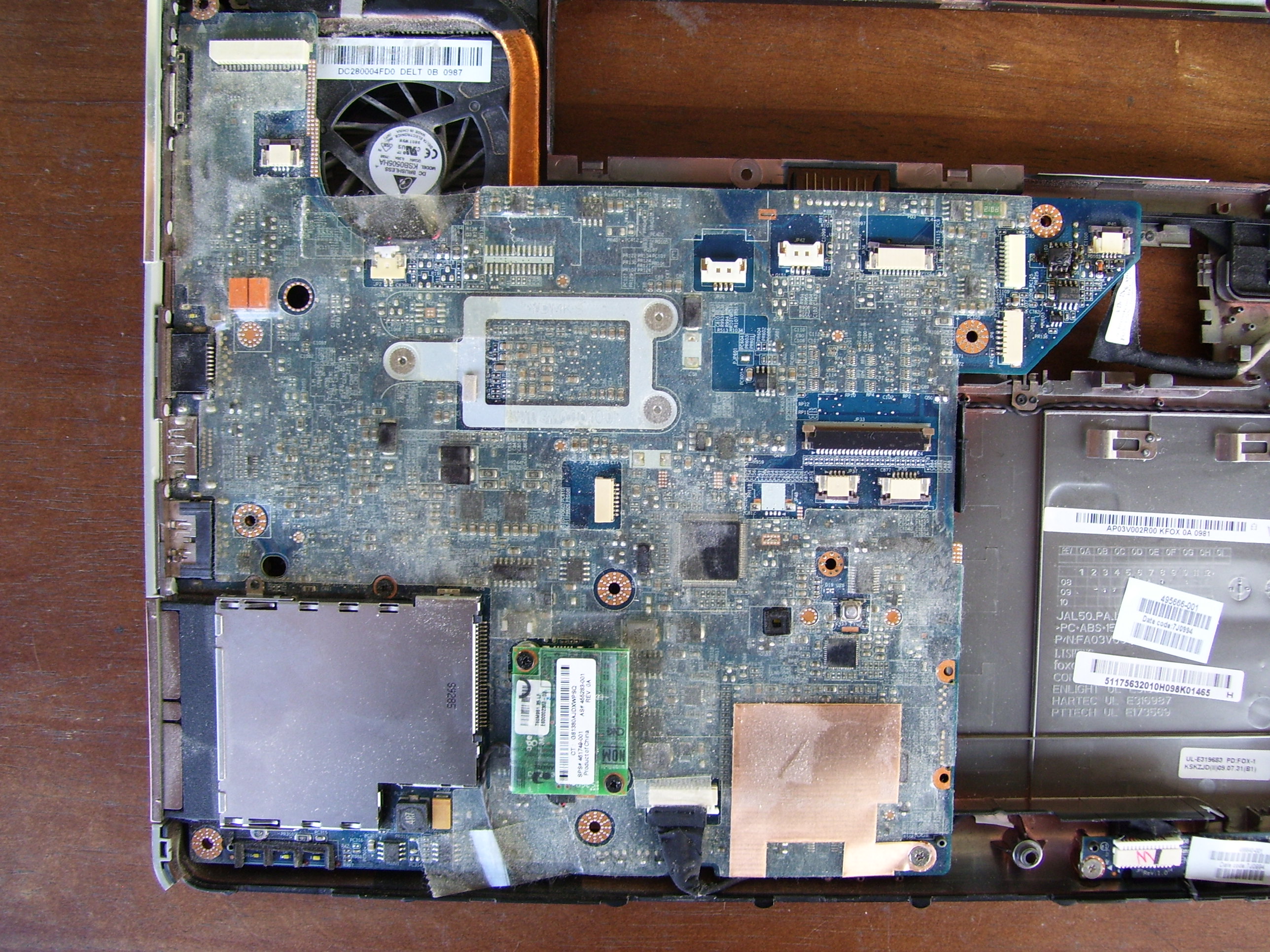

          Originally posted by dj_ricoh
          and the mobo code?
          How can you read a schematic if you don`t know the motherboard code ?
          and when its pq usually (for me was always a 30v n-channel mosfet)
          la-4111p
            that code its for HP compaq CQ40 :|
              AM4835EP Analog Power P-Channel 30-V (D-S) MOSFET
                  its main power switch mosfets.
                      on the other side o board is power conector, so yes im sure its main power mosfets
