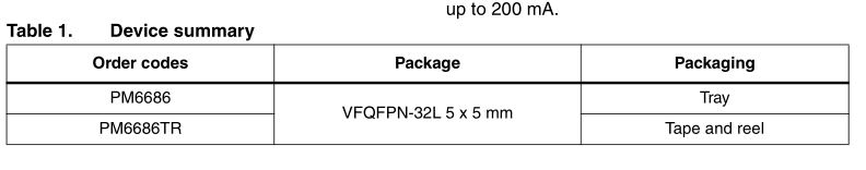

      Re: List of pin compatible Laptop ICs
      Good day guys. I just need to confirm if ic PM6686TR and PM6686 are the same? Coz I want to substitute it for this sn0608098. it takes 20 plus day to order the correct replacement. Thanks
        • 21641
        #223
        PM6686 and PM6686TR are the same, the TR means Tape and reel ,its just the type of packaging that the IC`s are supplied in .

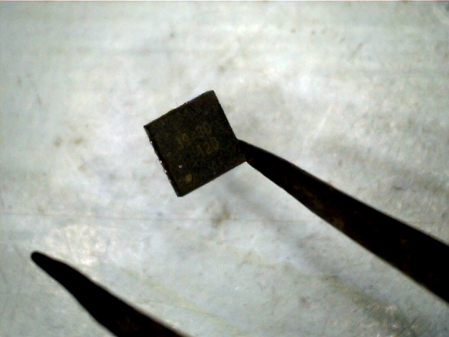

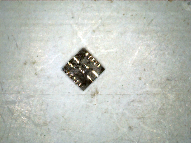

          anybody knows replacement for RT8248A ?
