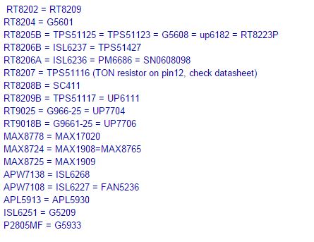

    Found this one here http://ns-comp.blogspot.com.au/2014/...lity-list.html Some have already been listed but there are a few new ones.

      Thank you, that is pretty good. Keeping this thread at the top so people can see it.
