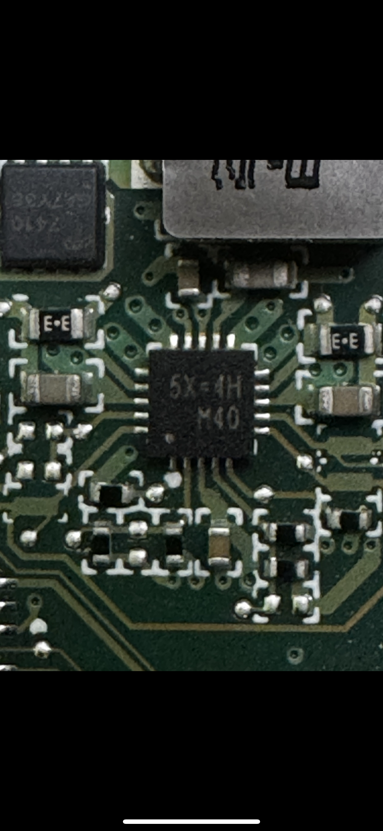

                  • Ellvin13
                    • Dec 2023
                    #329
                    Is there any chance to know what is the substitute for IC 5x=4H

                      • Jun 2013
                      • 55
                      • Greece
                      #330
                      Probably a RT6575DGQW...

                                #335
                                Click image for larger version  Name:	IMG_3127.png Views:	241 Size:	4.55 MB ID:	3175188
                                Rt6575 Serigrafía de seda 5X=2K 5X=2B 5X= Qfn20 Ic Chip Rt6575dgqw
