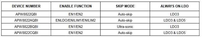

        Re: List of pin compatible Laptop ICs
        TPS51225C = APW8822C
        https://cdn.badcaps-static.com/pdfs/...fbe5ca52e1.pdf
          • 20303
          #204
          Originally posted by SMDFlea
          Added more info about EN1/EN2 , LDO
