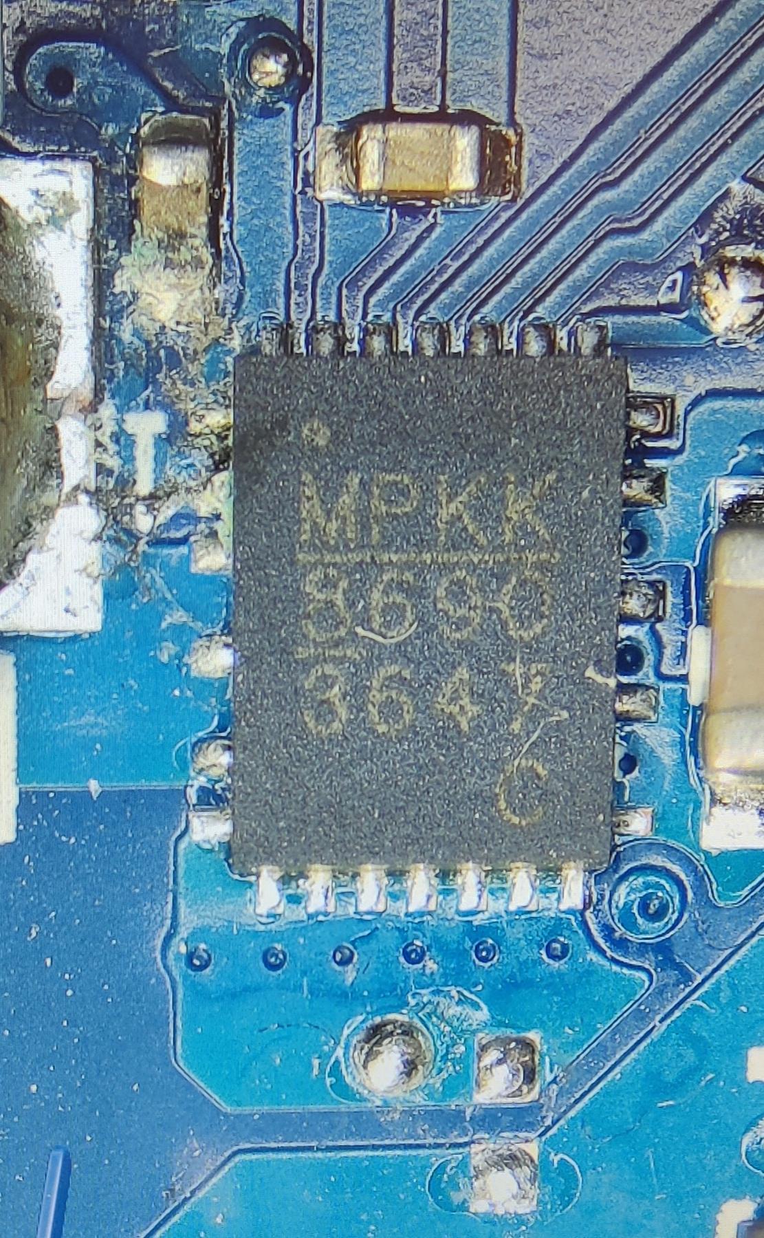

                                    #317
                                    Re: List of pin compatible Laptop ICs
                                    Hi If I'm going to get hold of a similar one as in the picture below MPKK 8690 3647 C, which numbers and letters are important
                                    Is it correct that something like this will work MP8690
                                    https://www.aliexpress.com/w/wholesa...55630&origin=y
                                    Why is there an underscore under 8 and what does the C in the lower right corner mean?
                                    I thinc this is the Electronic Components Datasheet
                                    https://www.monolithicpower.com/en/d...n/sku/MP86905/
