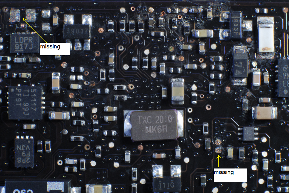

        Hi Did you ever have any luck with this board? I have a similar issue. There is a white fuse that seems to be blown, it is near the display port, one side seems to go to ground. I don't want to short it as i am not so sure it should be going to ground and perhaps something else is shorted.
        I'm looking for help and trying to understand how to get a board view and the diagrams i need to trouble shoot it.

          There is a number marked on the board 820-???? Looks to be next to the fan wire in that photo.

            post a picture of ur white fuse and look for schematic in this forum. should be already there. 820-2565

              Hi Thanks for the reply. I had also sent you a PM regarding this issue as you seem to have helped quite a few others in similar situations.
              If you look at the photo Quickbird144 had posted above my board looks very similar. I did find the schematic but not the board view. Also i am new to reading this type of schematic and without the board view it seems tricky.
              If you look in his photo near the display connector (sorry, not port) you can see the white fuse (just to the left) I am not sure how to use the schematic to locate this fuse to see it's value and where it go's to.
              On a similar board view i did find that it looks like it might be very similar to diode D9701 (at least it is in the same position on the board)
              I found that on a boardview for a 820-2879 and D9701 appears to be linked to the backlight.
              My board is an 820-2565-A I noticed several people looking for a board view for this board but it appears with no replies.
              EDIT: I have added an image i found online of the same board but with someone else's problem so please ignore the missing component and look for the white fuse in the top right side of the photo. Also i tested voltage at R33F the 3 legged component. And it had 3 or 4 volts on the 2 legs on the left, i think the one leg on the right was also shorted to ground as far as i can remember.

                ok, 2565 is magsafe code. look near fan or hdd connector for an other code like 820-xxxx .
