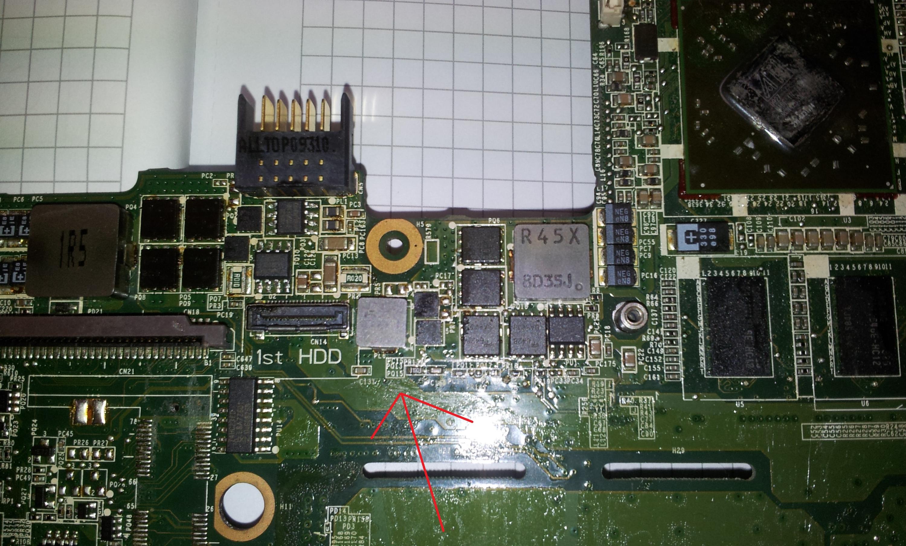

                              • grahamw01
                                • Jan 2013
                                • 256
                                #35
                                Re: HP Envy 15 cannot charge battery!
                                by the way is PR155 a diode? on both motherboards I am getting 100k-ohms each way on this.
                                I also checked some voltages around U33, getting some 3.33V on both motherboards, but PR155 on the charing board is 3.33V and on the non-charging board is 3.03V

                                    I tried to solder a tag onto the U33 pin 102 but its too small, i got it once and realised I did the wrong pin, doh!

                                      #38
                                      Also check PQ15 I think is bad that's why you're getting 19v on that bus line. PQ15 is an Nchannel mosfet so place DMM in diode mode and place neg- prove on pin 8 and pos+ prove on pin 1, you should get around 500ohms. Now flip the proves aorund and you should get no reading. If you do get a reading replace it.
                                      • grahamw01
                                        • Jan 2013
                                        • 256
                                        #39
                                        okay thanks, I will check it out tomorrow
                                        • grahamw01
                                          • Jan 2013
                                          • 256
                                          #40
                                          what does PQ15 refer to? I have attached a picture, I found the text but can't really see what it points to.. I think it is one of those legless squares, which I will not be able to test, but I can try to replace..
                                          Cheers
