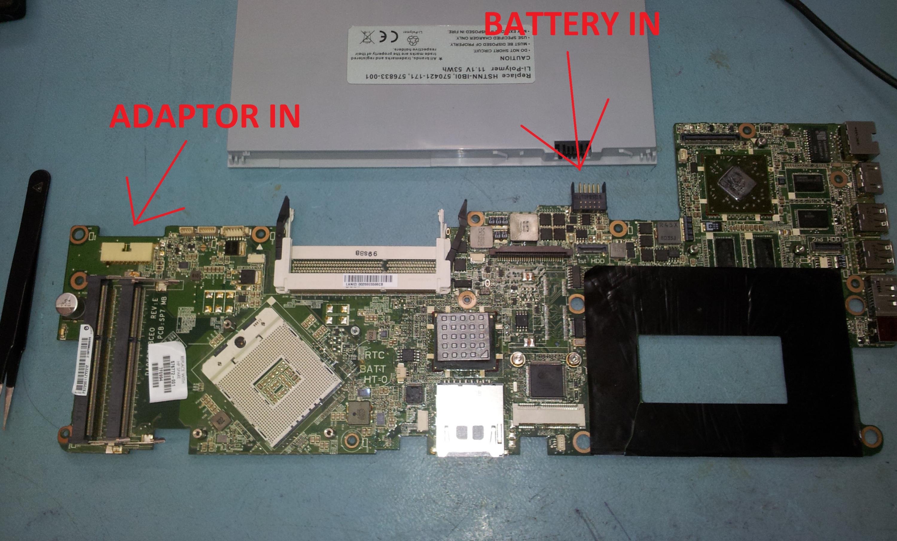

    Hi everyone,
    I would much appreciate some help with my laptop!
    I am having endless unfortunate problems with this laptop. First it just died and would not turn on what so ever, I got fed up of trying to repair it so just purchased a new motherboard from China. At first I assumed everything was fine again because it worked perfectly, although I did not have a battery, it was working fine off the charger.
    I purchased a new battery for it from China and it arrived just a few days ago. Initially I still thought everything was fine because the battery arrived 80% and it seemed to work perfectly, then as the battery ran out I got the most frustrating problem of all, it would not charge.
    When I put the AC adaptor in, it just cycles through charging and not charging every few seconds. I assumed the charger has gone, because I know this is a common problem with some laptops (it will run fine with the adaptor plugged in but will not charge the laptop)
    But just before I wasted more money on a new charger I did a few tests. I still have the original motherboard, so I hooked up the AC adaptor and put the new battery in it, and it charged fine! Went back up to 100% within a few hours, and I was able to run the new motherboard off it again until it died.
    So, I have narrowed it down to the NEW motherboard also being faulty! Would anyone happen to know how to fix it? I am sure it is possible to exchange some components related to charging from the old motherboard on to the new one, does anyone know what could be wrong?

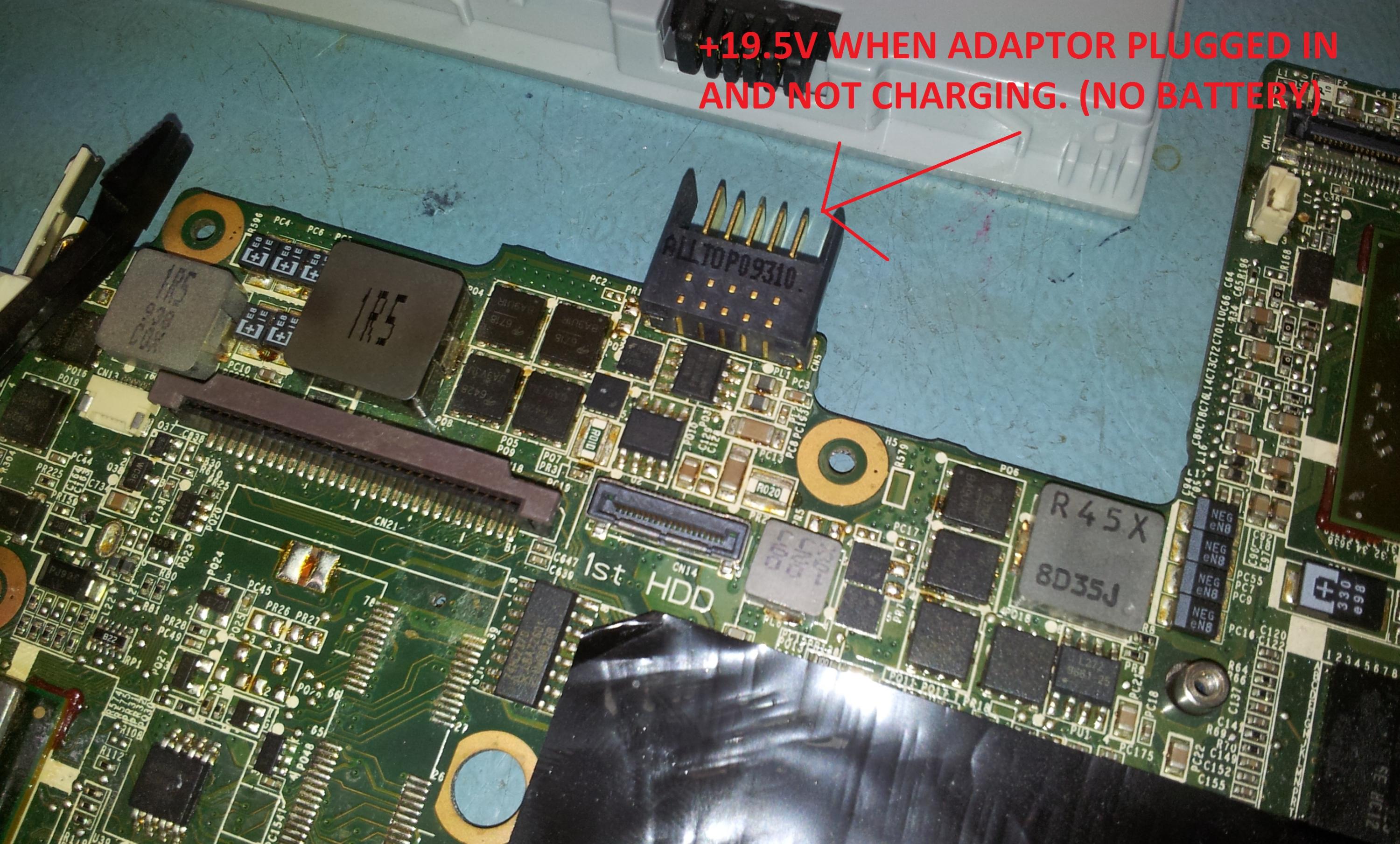

    I checked the voltage on the battery connector when the power cable is plugged in, on the one that wont charge it is constantly 19.5V, which is the full power of the adaptor and seems very wrong when the battery is only 11.1V.
    The motherboard that will charge has -0.3V on the battery pins, until charging is activated and it goes up to 12V.
    I apologise for this essay, but I would be so grateful if someone could help me. I want this laptop back!!

          Hi again,
          What I mean about replacing components is I am assuming as the motherboards have the same model number then the components are the same, therefore each component and its equal component on the other motherboard should have the same value of resistance when checking right?
          So when I came across some transistors that had different values, I swapped them to see if it would make a difference, but it didn't.
          I only have a picture of the top of the board as I left it all at work for now. I have good facilities to quickly swap components, I just hope it is 1 component that can be replaced and someone can help me identify it!
          Please note the images attached are of the original motherboard, that has a working charging circuit but does not work in general.

                  Thanks for all your responses, I will try what nish has suggested. At first I believed it would be the pin in the adaptor cable that determines what the adaptor type is, I know if the motherboard in some laptops does not know the power output of the charger, it will only power the laptop but not charge the battery.
                  It would make sense then if there is a dry joint on the socket for this wire, so the motherboard is unable to determine what the adaptor is and will refuse to charge the battery. I chose to ignore this though when I discovered there is 19.5V on the battery connector when there should be nothing. This seems extremely wrong. The battery is only 11.1V, and I think when its charging it goes to a maximum of 12V on these pins, and that is only when the motherboard turns on battery charging.
                  The IC's I changed were the 2 8-pin ones located next to the battery socket, they can be seen in the picture. I believe these are not important, the original motherboard was able to charge the battery even with these removed.
                  I will try to resolder the connector tomorrow as kindly suggested by nish, but since there is 19.5V coming out of the battery connector I think there is a bigger problem.
                      those just switch power from battery to adapter to adapter to battery but since that motherboard is dead you don't see any difference because the system does not power on to notice it's gone....these are for run switching... hence power run mosfets....what you want to watch out for is voltage regulator for some reason its max out on one board and being told 0 volts on the other...in theory...

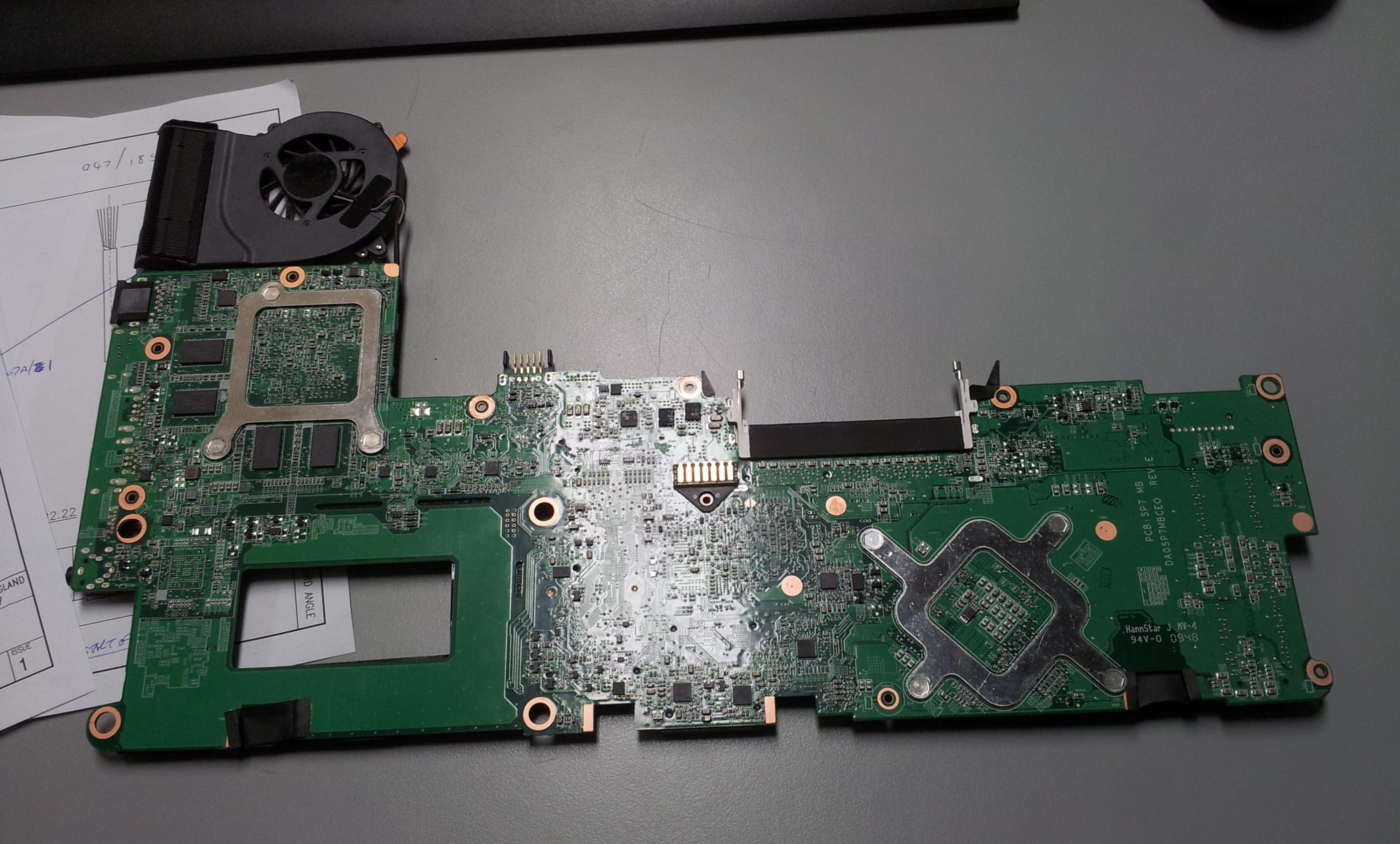

                                And by the way, have you been able to locate an ISL ic on the other side of the board? And if time allows please post a picture of the other side of the board.

                                  bottom of board attached, I don't have time to play with it at the moment (I should be working!)
