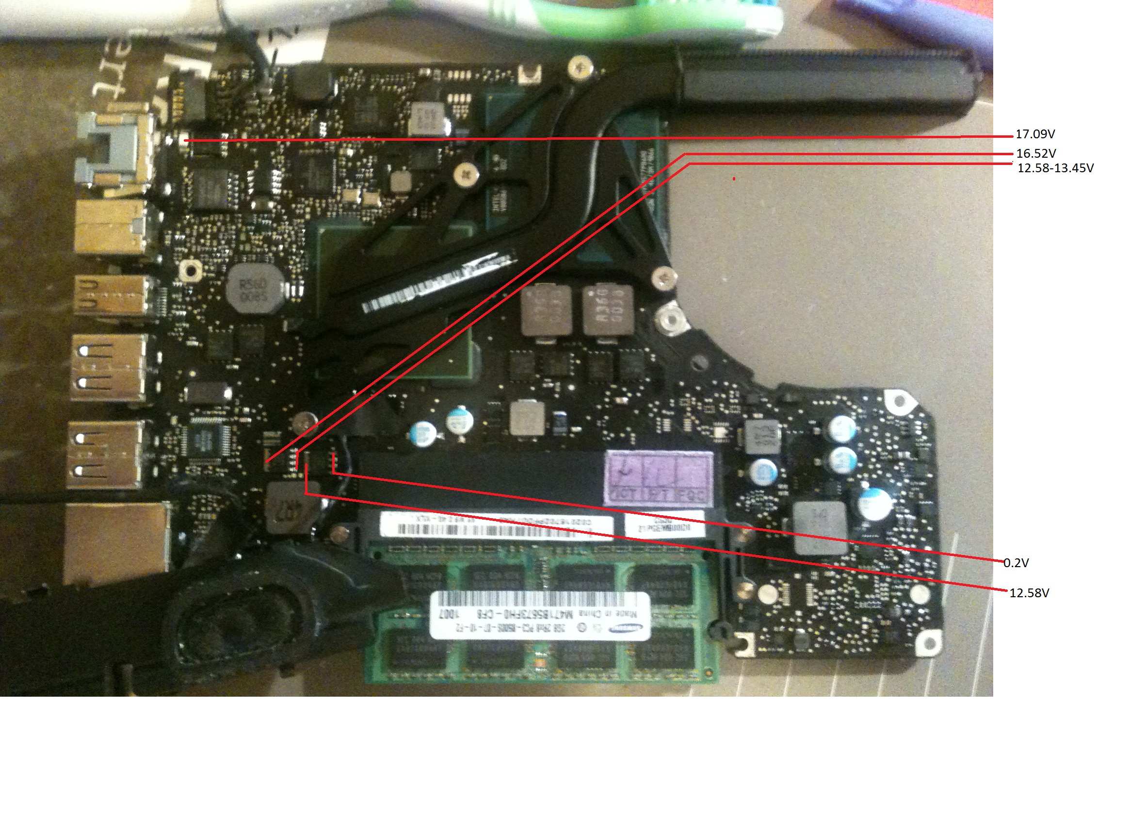

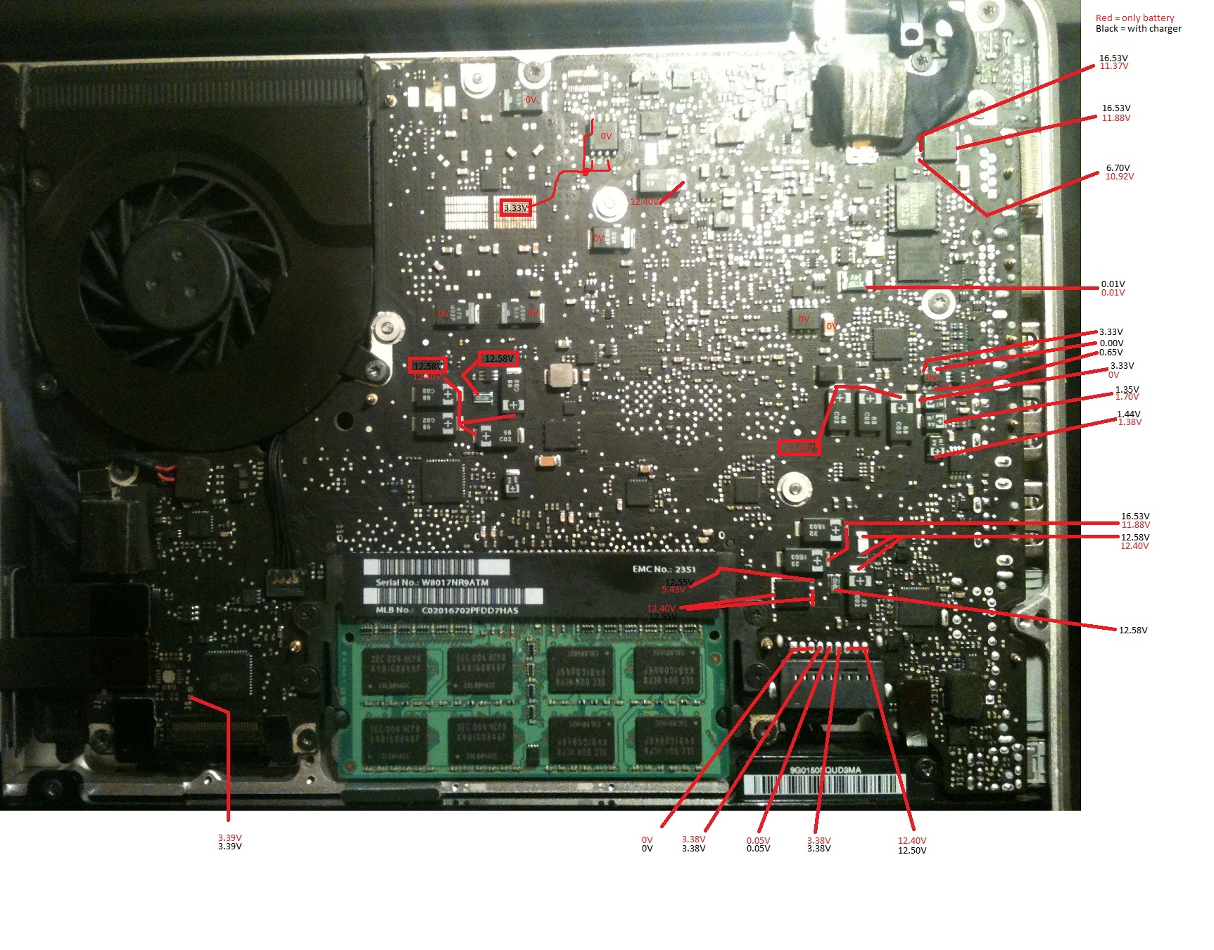

    Iam working on a water damaged macbook pro 13 2010 A1278 EMC:2351.
    The mac charges the battery and G3hot is good. But it wont start Great if someone could help me out where to look.

    Well, I didn't yet worked on these newer macs, but i can see that you don't have 5V anywhere. Are there components on the other side of the board?
    Try to measure resistances on the caps that have 0V.

      Re: Macbook Pro 13 2010 A1278 EMC:2351 wont power up
      Thanks I think you are spot on when you spotted that I dont have any 5V but I have problem to find out where the 5V supply is on the PCB.
        Did you measure what i told you in post #2?
        Aldo measure voltages on all the coils. The coils next to a 3.3V coil is the 5V coil. Then check the mosfets near it.

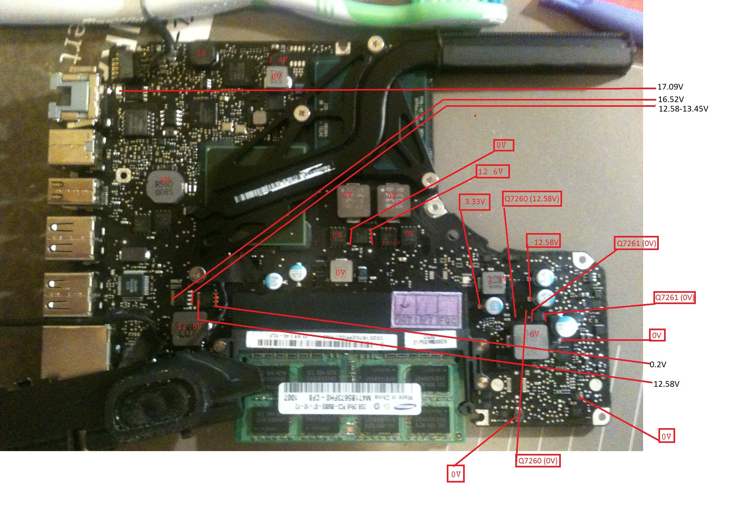

          I think I have found one of the problems, there is a chip (TPS51125) that makes 3.3V and 5V and this only produce the 3.3V. So I have ordered a new one and hope this will make the macbook happy
            That chip doesn't make 3.3 nor 5 V. It can control the components that do.
            Also are you sure that the chips output is 3.3V not the input?
              Iam not sure. Here is a schematic of this chip. I mesured (12.38V on VIN) and (3.3V on V02) and (0V on V01) is V01 the output of 5V?
              I mesured (4.99V at VREG5)
                https://cdn.badcaps-static.com/pdfs/...c3b552ae45.pdf
                Here is the datasheet for your chip. VREG5 is the 5V output.
                This is the explanation for the VO1 and VO2 (page 6):
                Output connection to SMPS. These terminals work as fixed voltage inputs and output discharge inputs. VO1 and VO2 also work as 5 V and 3.3 V switch over return power input respectively.

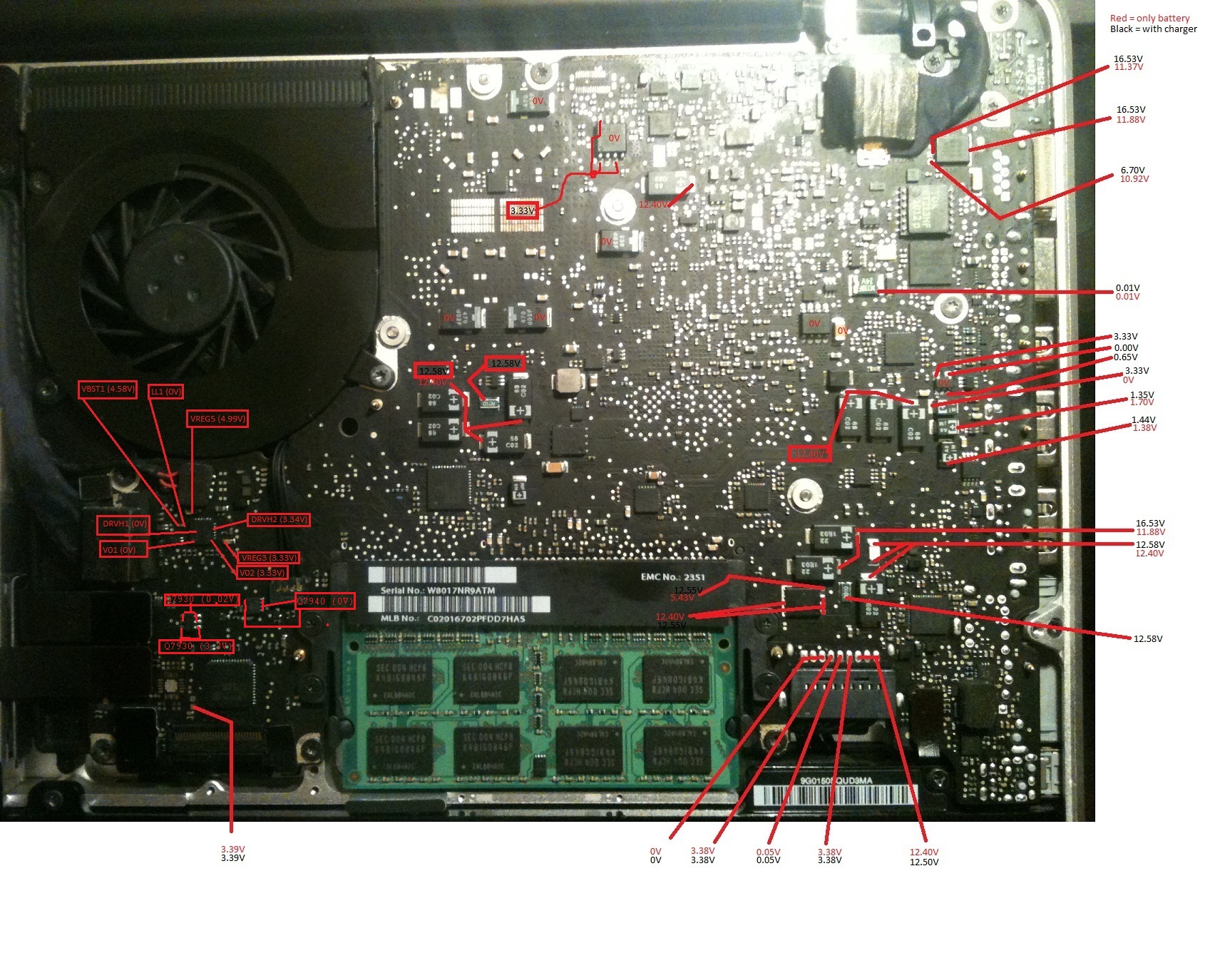

                  This is tricky. I have taken some mesurements you guys can have a look at. Thanks for helping me
                      I had a MacBook Pro that wouldn't show any charging led or power on. I used a light prober on the board to see how far power was flowing through to the end of the board. Turned out power would stop at the charge board at a very specific small doohickey. Cleaned the thing very carefully and it now the laptop works perfectly.
                      So, my advise is to use a light prober and see which areas on the board are receiving power and go from there.

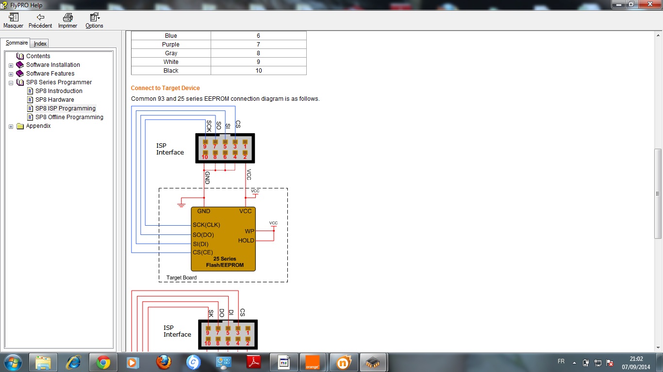

                              hi,
                              before starting the flash, the bios chip is programmabe in place
