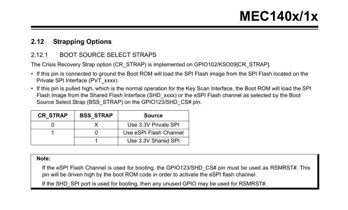

                Does anyone have info how to obtain the firmware for MEC1515-NB (Let's suppose programming is possible) and which size is it?
                I don't provide help for people using CH341A and a clip.
                  • 24614
                  Here`s some info from the MEC140x datasheet about a crisis recovery .
                  Premium supporters get full download access and other benefits.
                    • 24614

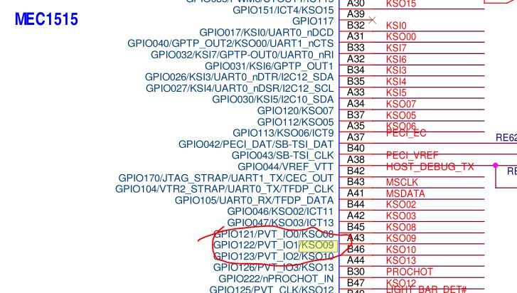

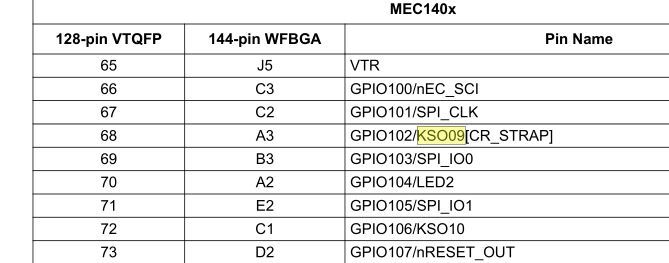

                    #29
                    MEC1515 KSO9 on PVT. What will happen if KSO9 is shorted to gnd at boot i don`t know.

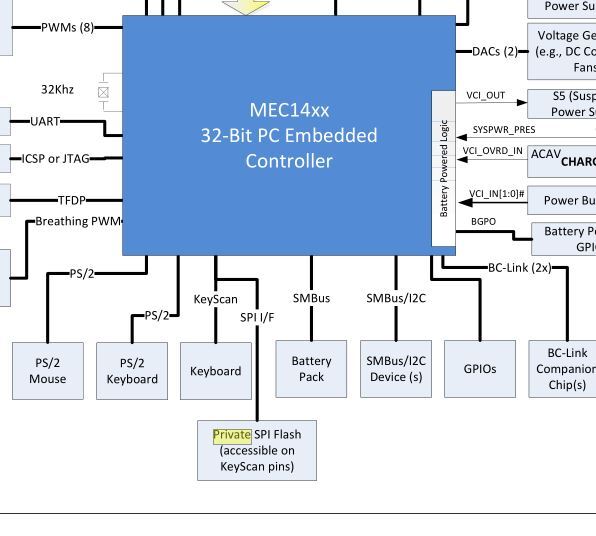

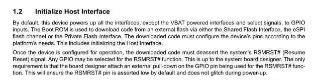

                      #30
                      So if I understand correctly, if the chip goes into crisis recovery, it should pull the firmware from the main bios? Although I'm not sure if 14XX have the same principle as 15XX, the datasheet for 1515 seems impossible to find.
                        • 24614
                        #31
                        Forget what i posted .A blank chip wouldn`t boot without the boot ROM
