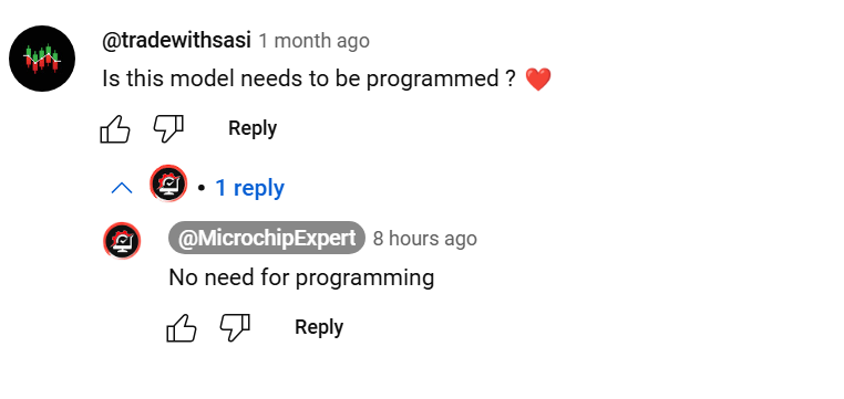

                    • mon2
                      • Dec 2019
                      • 14142
                      What is the full p/n of the original EC?
                      Is it MEC1515-NB or MEC1515-NM?
                      According to this YT video, no programming is required:
                      Dell LA-L241P MEC1515-NB IO controller replacement process (youtube.com)
                      Click image for larger version  Name:	comment.png Views:	0 Size:	39.9 KB ID:	3466100
                      • mcplslg123
                        • Jun 2015
                        • 7262
                        • india
                        I dont believe the YT video from my own experience. This MEC1515 is programmable and as mentioned by@ tuan tong, there is no programming solution yet atleast in public domain.
                        The so called programmed chip from whatever source you buy will never work as they are all fake or not programmed with the target mb as claimed.
                        Only a MEC1515 from same/similar scrap mb works.
                        Thats what i've experienced so far. Thats why i fear repairing LA-241-43/46 etc series.
