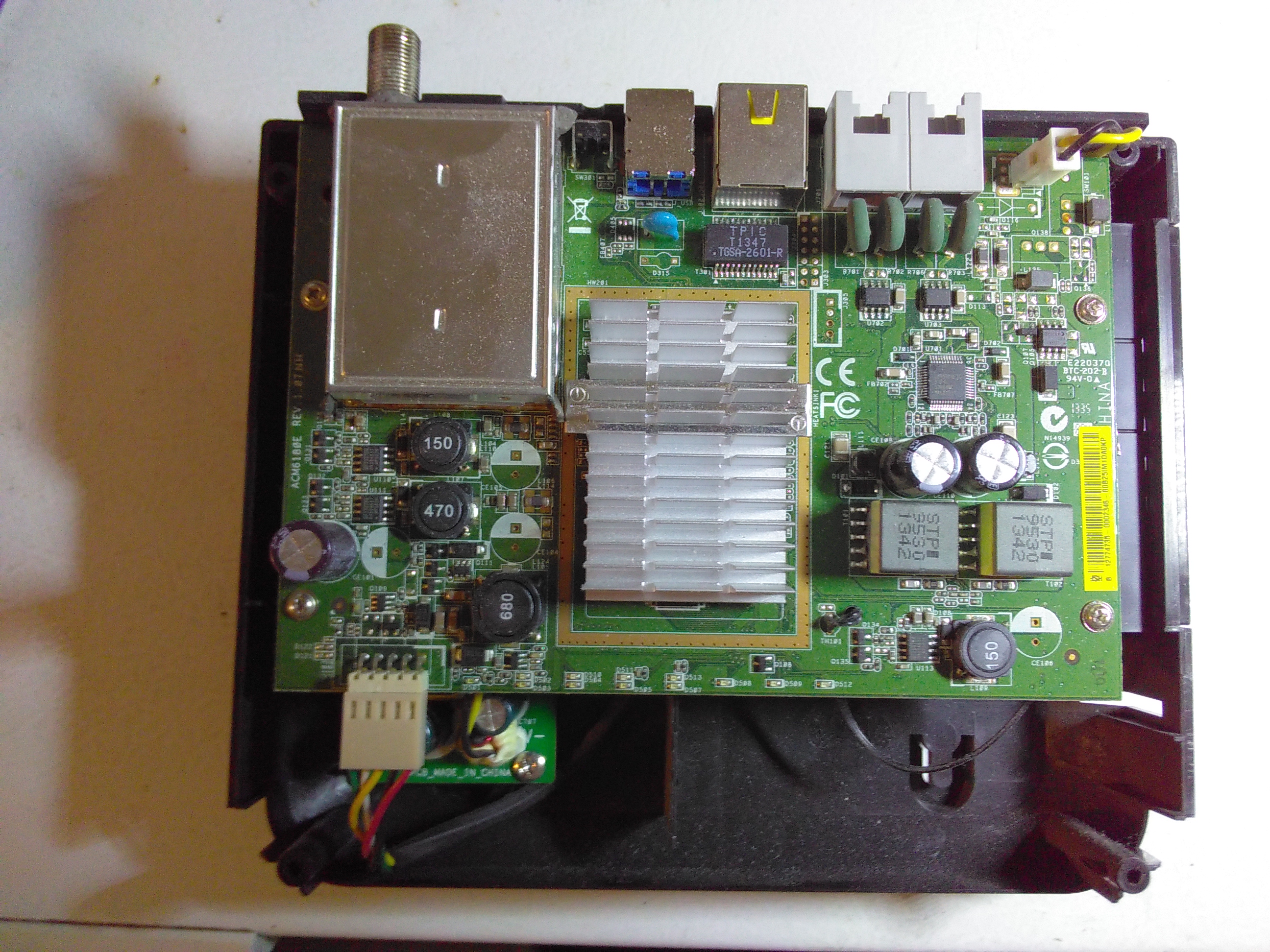

    I want to repair my cable modem instead of paying far too much for a new one, that will only fail after 4 or 5 years anyways. So I have some questions:
    Since cable modems (and also routers, for that matter) tend to fail at almost predictable intervals, I'm interested to know if anyone can tell me what electronic components inside the units tend to fail. Does anyone know?
    (Please note: I am not looking to troubleshoot my internet connection - I am interested in repairing cable modems only.)

        Cisco DPQ3212. It's a Cable data/telephone modem, from Cox Communications. It has started intermittently going offline and resetting. I can't find any rhyme or reason to it. It's always run very hot, but temp doesn't seem to be a factor in it's intermittency... although I don't doubt that high temps have likely contributed in no small way to it's overall degradation.
        It belongs to Cox, but it's so old (DOC SIS 3) that they will let me keep it if I want it, since it's gone bad anyways. To get the latest HSI cable modem standards, they run around a hundred bucks in the US. I would rather repair this one, if possible and cost-effective.
        I haven't done any testing on it, other than to try and correlate certain environmental factors with it's intermittent failures.

          Open it and post some pictures so we can see what's inside it. If it's not bad caps in the modem and the power supply, we will need to dig deeper.
          Could also be bad/noisy signal coming in from your coax cable. Sure the Cox guy can come and test the signal strength and quality, but that's just an instantaneous test that doesn't really tell you much. A bad connection (typically at a junction or splice somewhere) can come and go as it pleases - sometimes with variations in the weather (and moisture) outside, and sometimes due to other factors. Intermittent drop in signal = intermittent drop in connection.
          BTW, DOCSIS cable modems should be pretty cheap and easy to find now. Could just get another and just call Cox to register the new one.

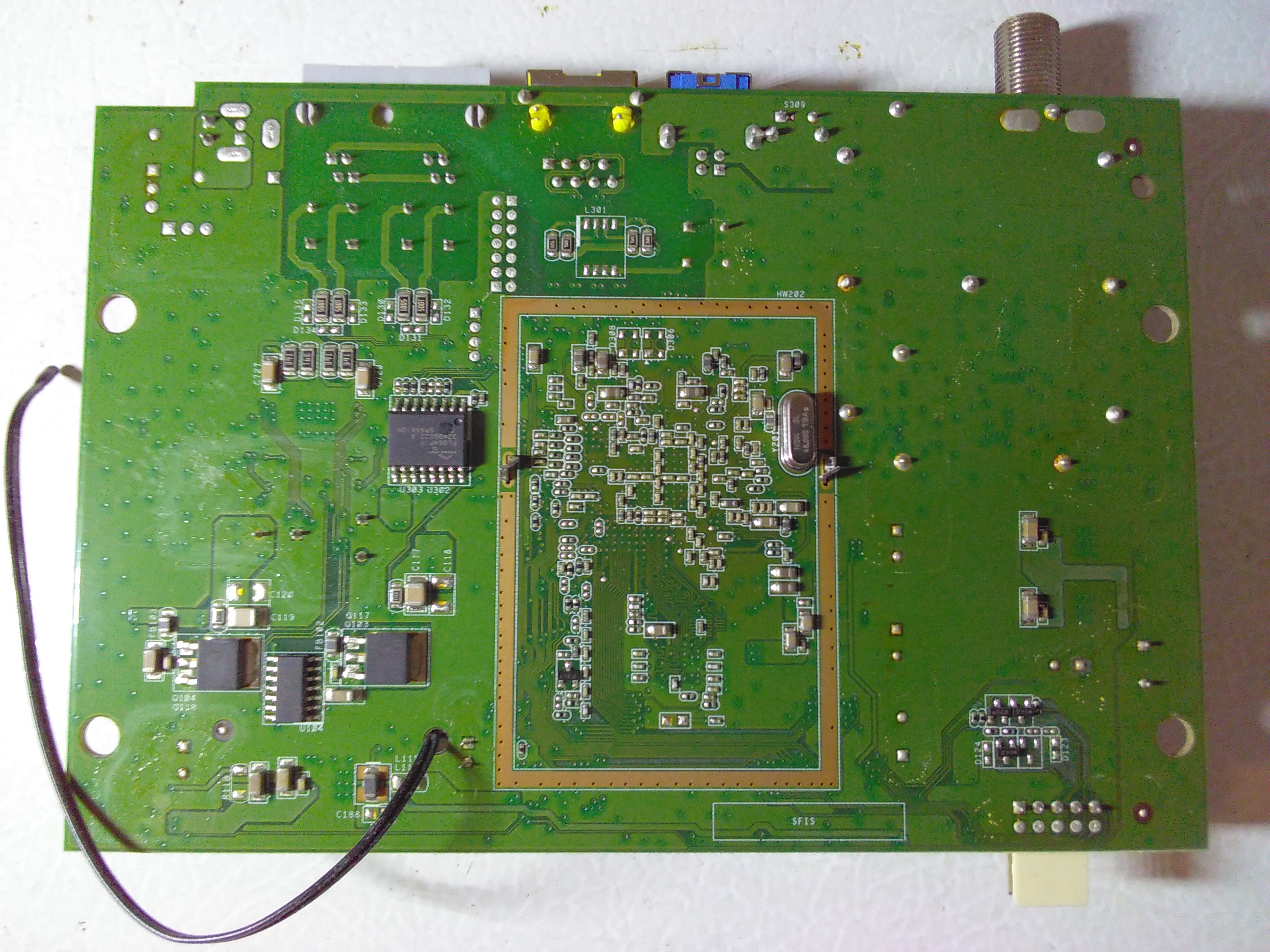

            Cox rents them, and they cost $120/year. Could buy one for that, but would rather repair this one if possible.
            Looking at the PCB layout though, I'm doubtful it's possible or practical, as it appears to be populated by 90% SMDs.
            Please see attached images:

              whats the temperature rating on those caps? if they're 85°C rated and since u say it runs very hot, could be the caps are toast. many cable tv set top boxes and cable modems run hot. no surprise they dont last.
              could also be electrical surges and lightning strikes on the coax cable killing the set top box and/or modem.
              what is under that heatsink? are there any bga chips under there? if it runs very hot and there are bga chips under that heatsink, its possible the bga may have gone bad just like a gpu. if the bga chip is bad, it isnt practical repairing/reflowing it.

                I have a feeling a lot of these cable modems are just poor QC when designing the chips and they go bad. Only repair is replacement of the BGAs. However without proprietary knowledge of how to test these things, it's difficult to tell for sure.

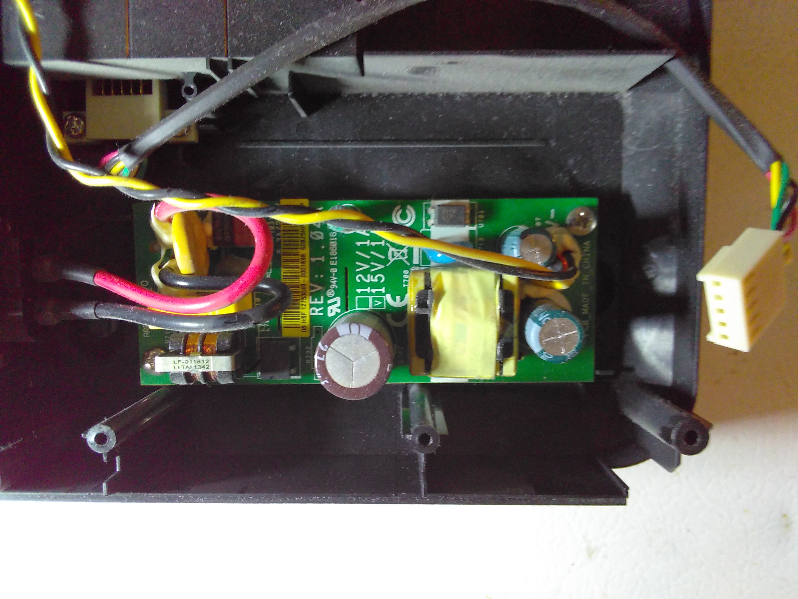

                  The power supplies are more likely to fail as it's a device plugged 24/7 in the mains so constantly hot... some have relatively high standby power consumption... the boxes can become full of dust...

                      It appears this thing is not repairable, based on what the circuit board looks like - with the extensive amount of SMD devices on it. So I guess I'm giving up and am gonna go get ripped off at Fry's Electronics and pay too much for another worthless P.O.C. that's going to burn out in a few years. :-(

                          Look to the power supply in particular the output capacitors if devices become unstable. Electrolytic capacitors are affected by temperature and age, SMD devices not so.

                            I see electrolytic caps on the SMPS and even a few on the modem board PCB. If any of these are bad, that could well be the issue. I haven't ever had a cable modem with decent caps go down. Our current Verizon one is maybe 10 years old now. The Scientific Atlanta I have from Cox is even older. We used that one for 2-3 years, then switched to Verizon, then I used the Cox one at my college dorm for another year or so, and now it's boxed back up.
                            Oh, and worth mentioning is that neither of these were treated nicely, in terms of ambient room temperatures. My college apartment peaked past 90F (over 33C) many times in the summer and late fall. The Verizon modem is exposed to 83F Ta all summer long and most of the fall (plus a month in the spring too.) That's usually fairly hot for most consumer electronics to cope with.
