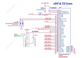

    Hi everyone,
    My 30-pin eDP cable from the mainboard to the LCD screen got cut and damaged at the screen connector side. I found another cable and took the screen-side connector from it, but the wire colors are different. So I really need the wiring diagram for both ends of the eDP cable to solder it back properly. If anyone has the diagram, please kindly help me out. Thanks a lot

    eDP 30 pin connector wiring should be common but you can google for full details.
    Which exact laptop are you attempting to use for this display? Do you have a schematic? Silk screen markings off the logic board?

      I see that the number of wires is also different compared to the diagram I found on Google.

        Which laptop? Motherboard details? If known, which lcd panel? Maybe some lcd sticker or brand name with part number? LG or similar?

          Mainboard dell g7 7588, LCd 15” slim FHD ,30 pin, BOE.

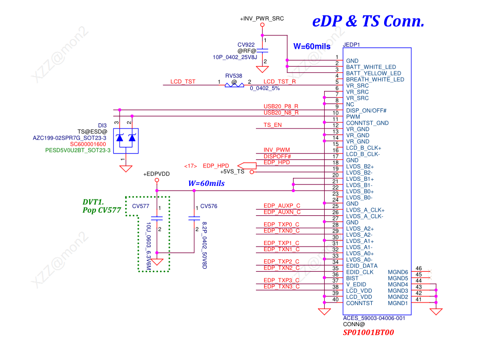

            See attached. The E993P schematic shows a larger eDP connector on the motherboard.
            Does this connector match the one on your laptop?

              Yes, it matches my computer perfectly

                Ok. Now search for the datasheet for the lcd by BOE on panel look website or similar to find the pinout on the display. Then wire up the 2 ends to match. You should also be able to find a pre-made replacement cable for the same purpose since the eDP is an industry wide spec. Maybe on AliExpress.
