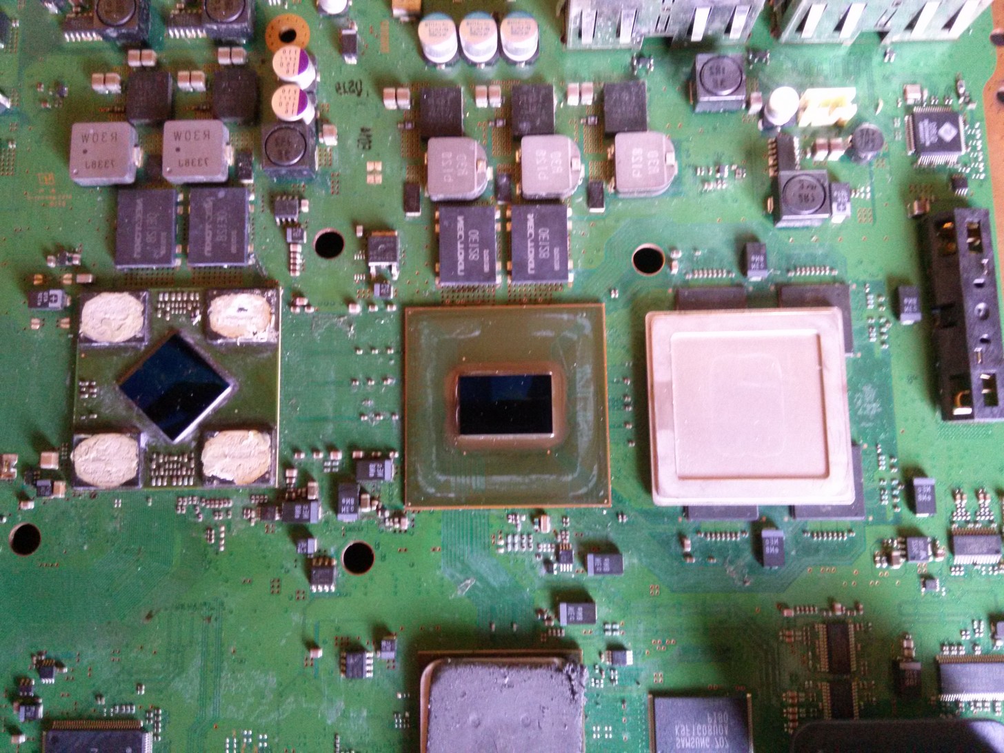

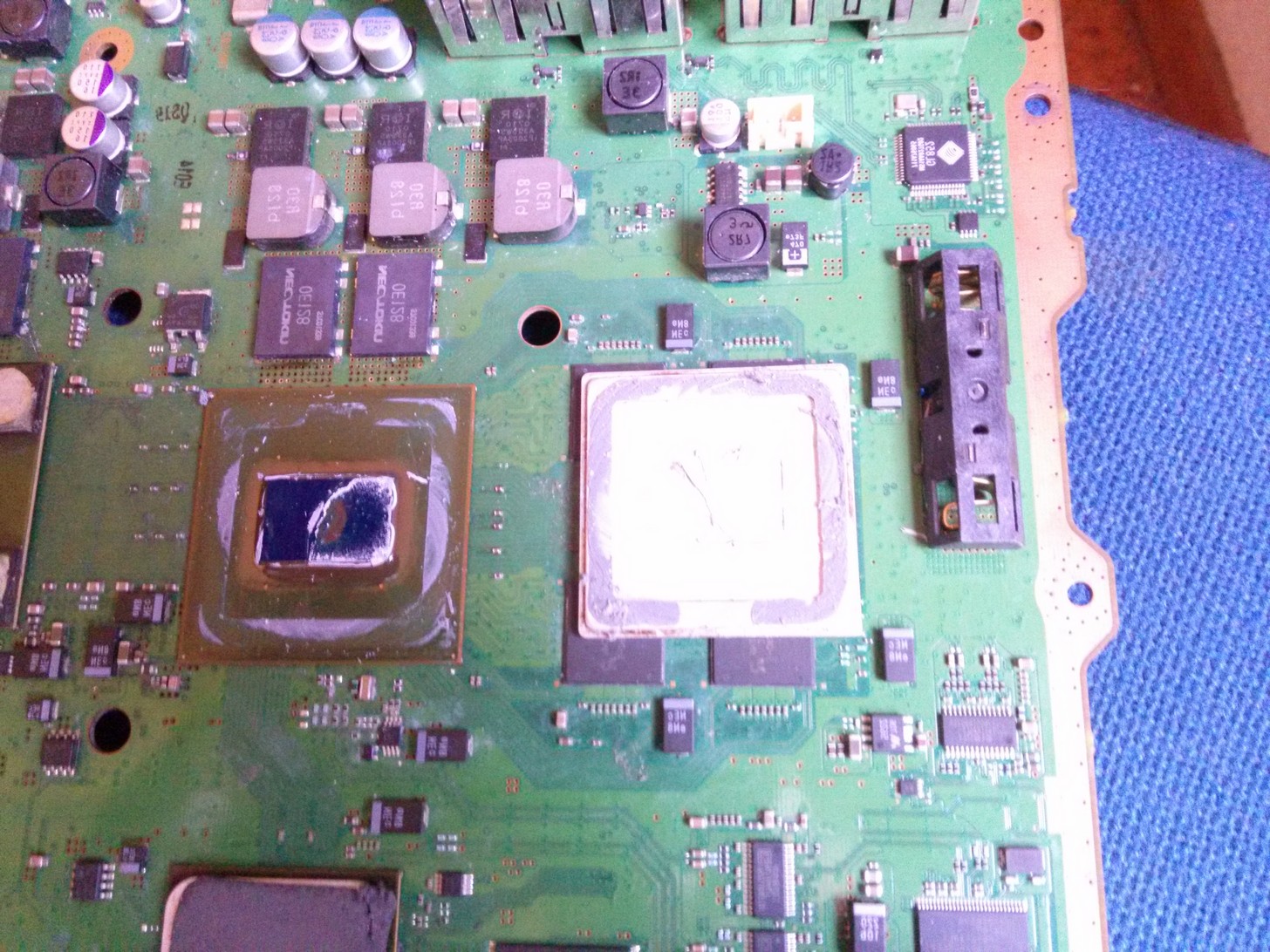

          Well, started to figure how to get that CPU IHS out of there without damaging anything...

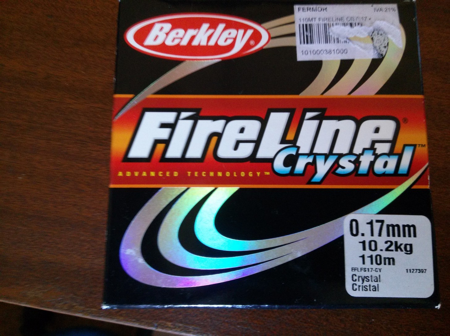

          And after searching what I had at home, decided to go with ... a fishing line !
          A good quality one, and ... it worked !
          Just placed it on the corners and started working it arround like a chainsaw.
          It starts slowly cutting the edges ... and even slower on the middle ...but it's safe and some minutes will do it!

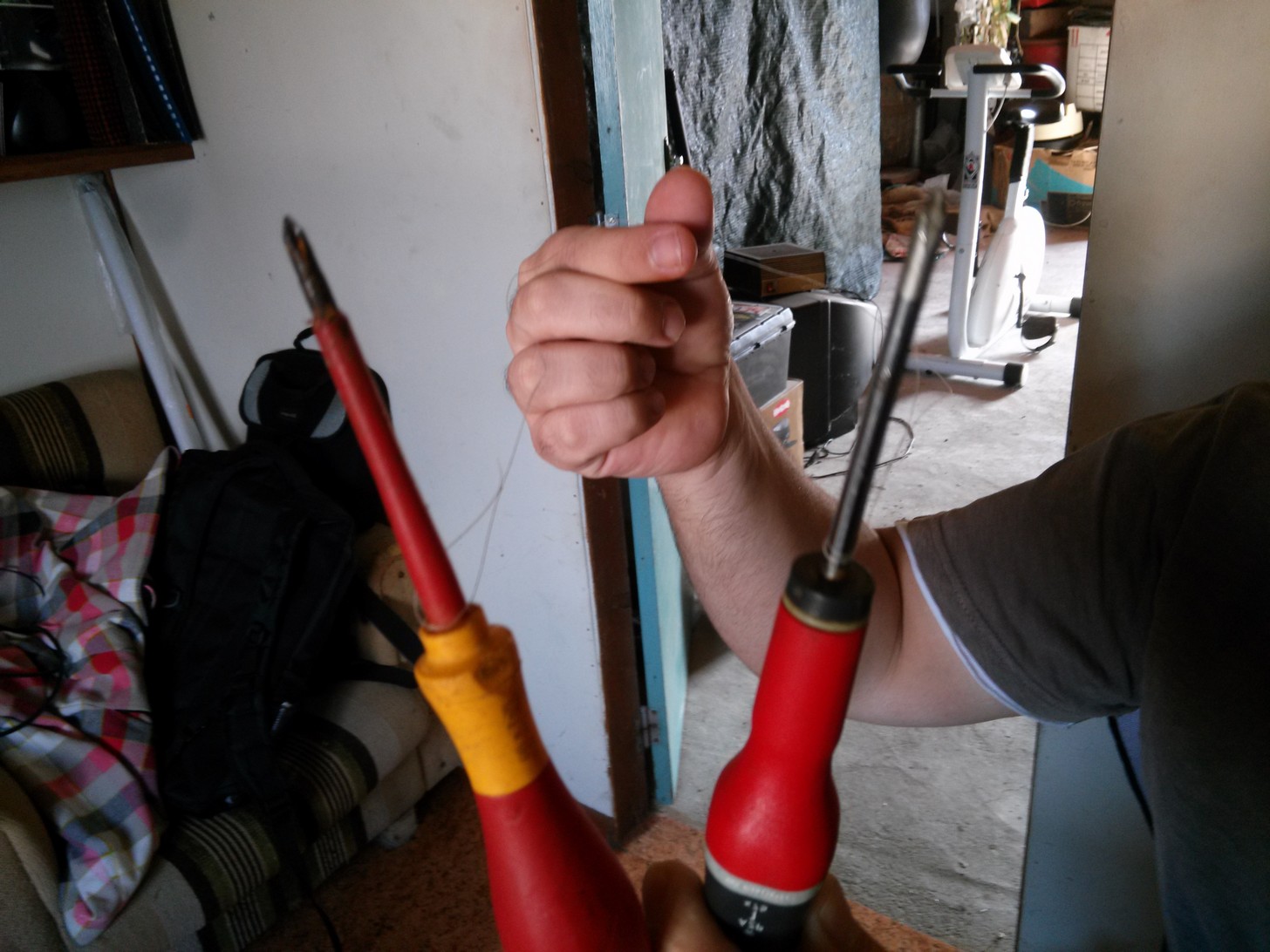

          Some pics are attached ... on the first one, we cant see it well, but its just two tools with the fishing line attached to permit to work it arround the IHS without hurting our hands
          Now some cleaning, some good paste ... and ready to test!
          I'll post back results!
          Hope these results can help anyone with this problem!
          Cheers

            Re: PS3 Fat RLOD reflow and now overheating message
            cool! i will adopt your method for my next ones. the chip looks really intact, with a modified blade there always were scuffs and cuts.

              Well, applied new Thermal Paste, assembled it just for testing, and
              it turned without problems for about half an hour!
              Now I see the way to close this console!
              Gonna assemble it completly tomorrow and fire it up for a couple of hours and confirm that the repair is good.
              Thanks to all who gave the precious inputs!
