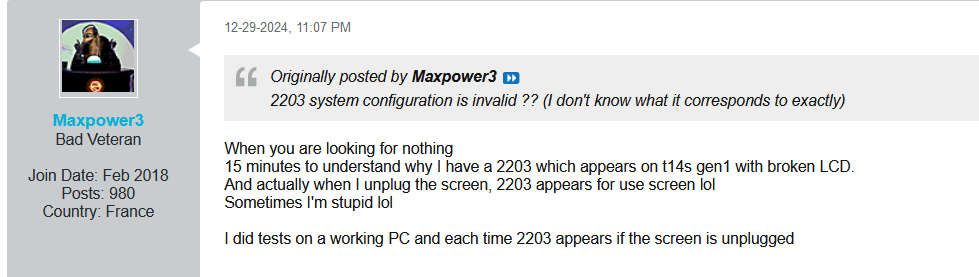

        2203 hardware problem
        sceen missing or others
        Click image for larger version  Name:	image.png Views:	0 Size:	44.1 KB ID:	3552791
        https://www.badcaps.net/forum/troubl...id#post3537692

          yes, I was aware of that. There are also some other reasons for this error message, but none of these apply in my case.
