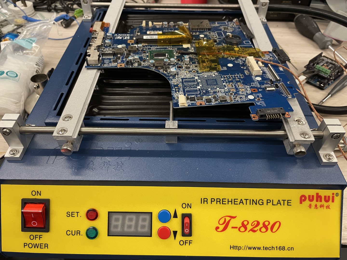

    I am experimenting a bit with reflowing larger components - ideally I'd like to reflow a PS4 APU or a GPU for example.
    I know it's impossible to reflow such large components with just hot air so I bought a pre-heating plate, T-8280 classic Chinese machine, which seems to be working fine besides it's a little slow, which shouldn't be a big deal.

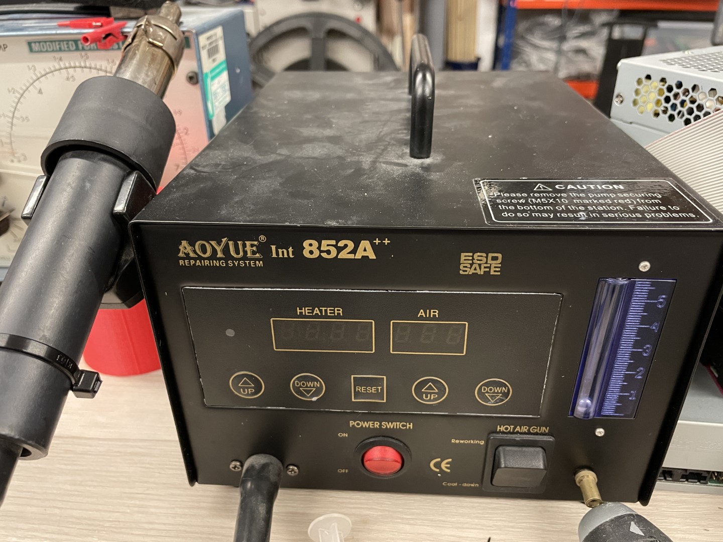

    Now, my hot air station is a Aoyue 852A++ and I feel it's a bit weak when used with larger nozzle. I tried reflowing a laptop chipset using one of those large, rectangular, nozzles and I failed miserably, burning the whole thing.

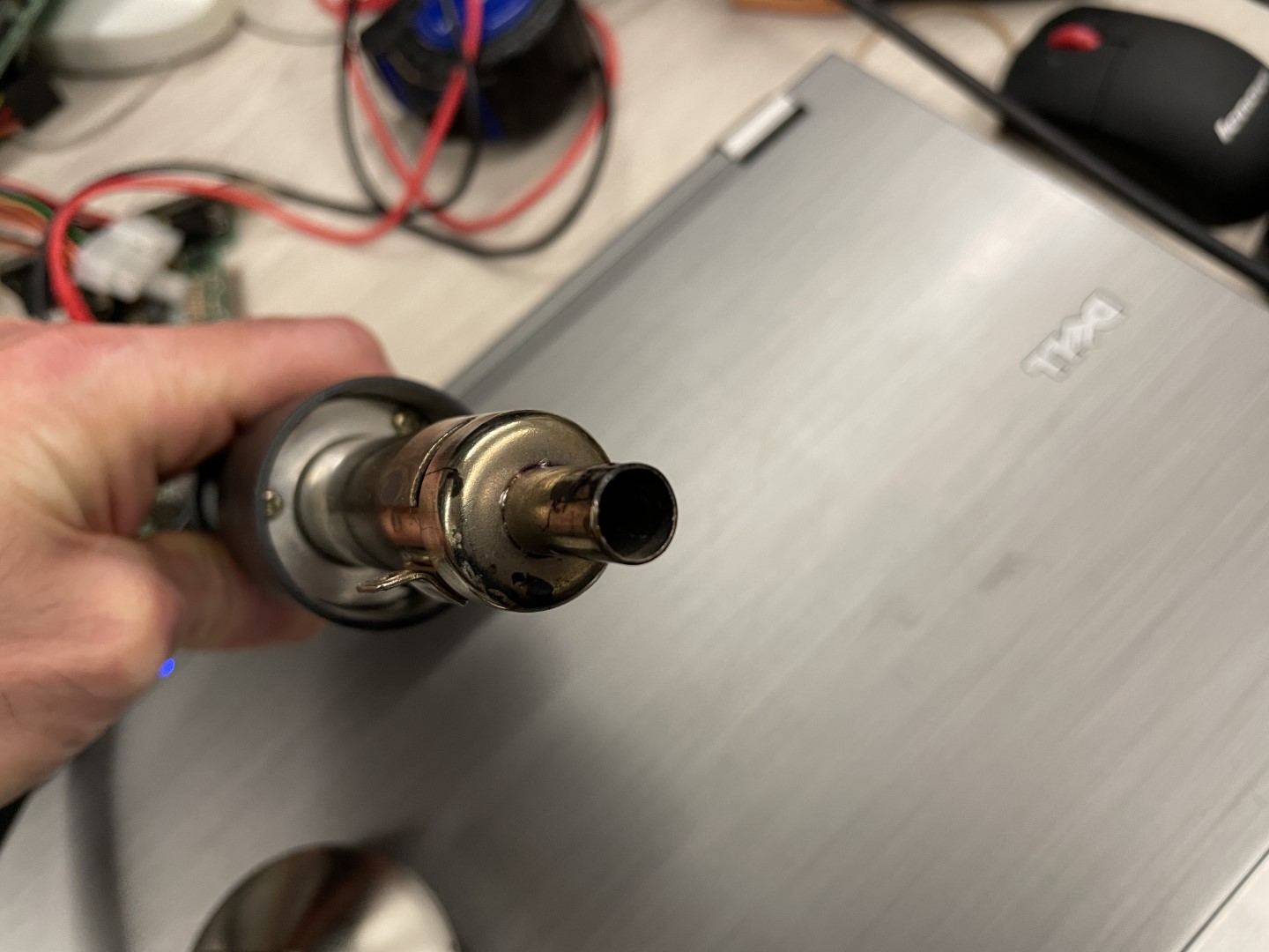

    I'm aware my SMD station is awful at blowing an even stream of air out of those large nozzles so I made a little "propeller" modification to the wand (which I think it's now standard with the newer version) but still it did not work.

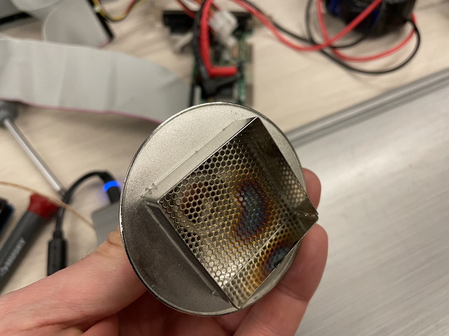

    You can see from the pic below a test I did when brand new before installing my mod, you can clearly see the unevenness of the temperature on the internal grille
    I tried with my largest round nozzle and it worked like a charm, but when I attempted to reflow the CPU, which is a bit larger than the chipset, I couldn't really reflow it properly.
    I have two thermocouples which are monitored by a laptop and also an IR thermometer to monitor temperature. I wait till the board/chip is 180 degrees, then I apply hot air (set to 310 degrees) to reflow. I see many people online using much higher temps on their hot air machine but that's without a pre-heating plate and I'd like to keep the temps as low as possible to avoid damaging components.
    Now, I appreciate the proper way to reflow a large chip is NOT by using a hot air station. However, I don't want to invest in a proper reflow machine simply because I won't be using it a lot.

                  I can reach 480 degrees with my station (I think?) but I'm trying to keep the temps as low as possible to avoid damaging the components - considering I have a pre-heating plate.
                  Using larger rectangular nozzles, I can barely feel any air coming out of them so I feel that my station is not suitable for them.
                  I feel that a bit more air and a larger round nozzle may be enough to reflow with more success. I am also well aware that blowing 200L/m air on a board will probably blow half of the components away!
                  Basically my question is: would I ever need more than 120L/m - this is imagining that I may want to reflow, say, a PS4 APU using the square nozzle which is pretty big?
                  And has anybody ever checked the temperature evenness of the air coming out of the Atten/Quick? The Aoyue tends to blow a massively uneven flow of air which makes it impossible to use with the BGA nozzles.
