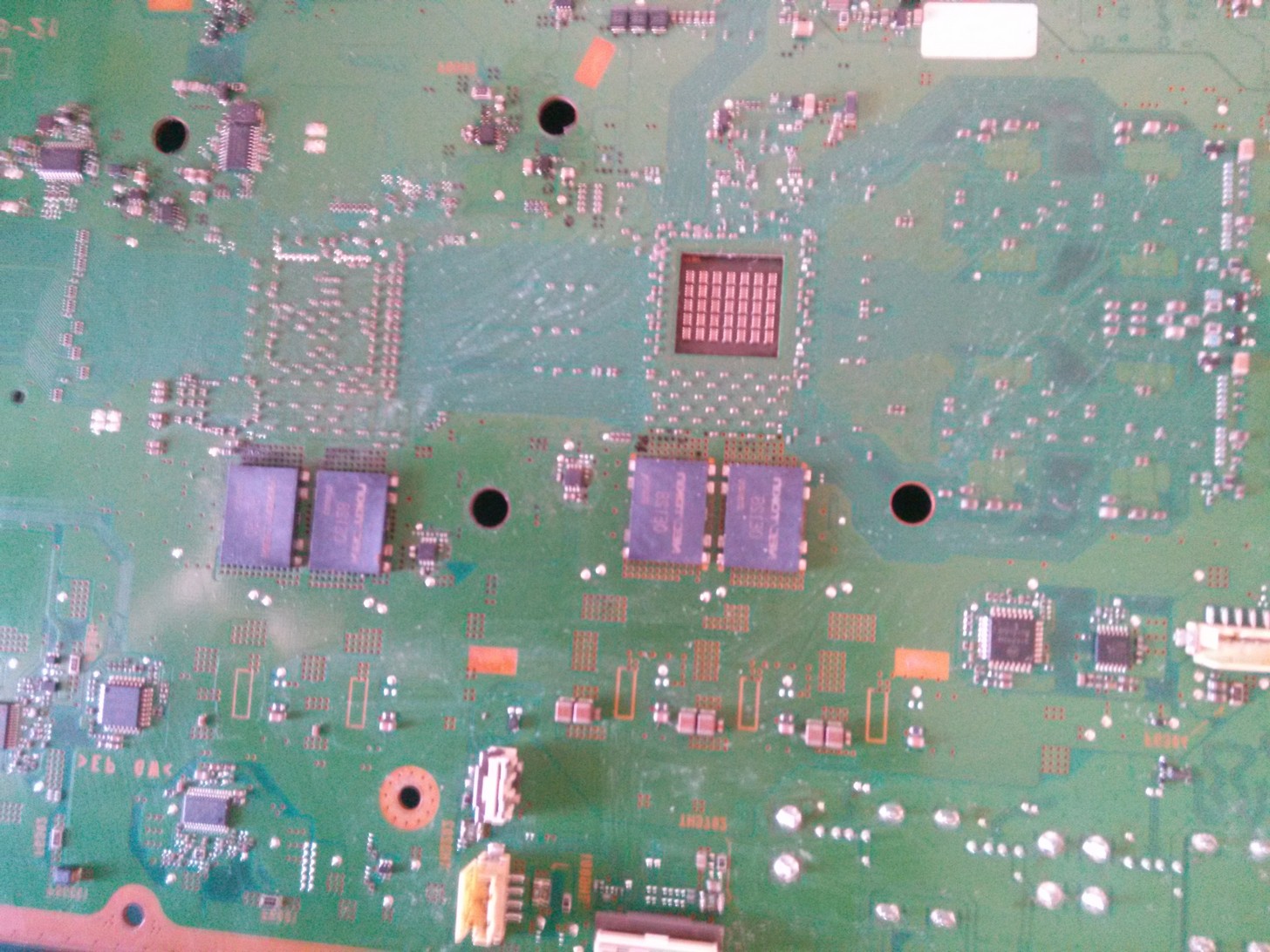

                Re: PS3 Fat RLOD reflow and now overheating message
                Hello!
                Just opened back the PS3 and looked for the "badcaps" NecTokin
                Found 8 of them (!) , 4 on each side of the board.
                Some pics are following.
                Should I change'm all?
                If I must do so , I need 32 (!) 330 uF 2.5V ??
                Or should I start by the 4 that feed the GPU and test?
                Thanks for any inputs to know the best approach to this issue!
                    Start at the GPU and then CPU with the NEC/TOKIN caps. I kinda doubt it is a bad thermal probe - otherwise it would display the overheating message from the start.
                    A working TV? How boring!
                      So I should change the 2 of the top of the board near the GPU?
                      Or should I change 4 of them, 2 on top and 2 on bottom?
                      And then test it?
                      Gonna spend all tantalum caps in tha house !

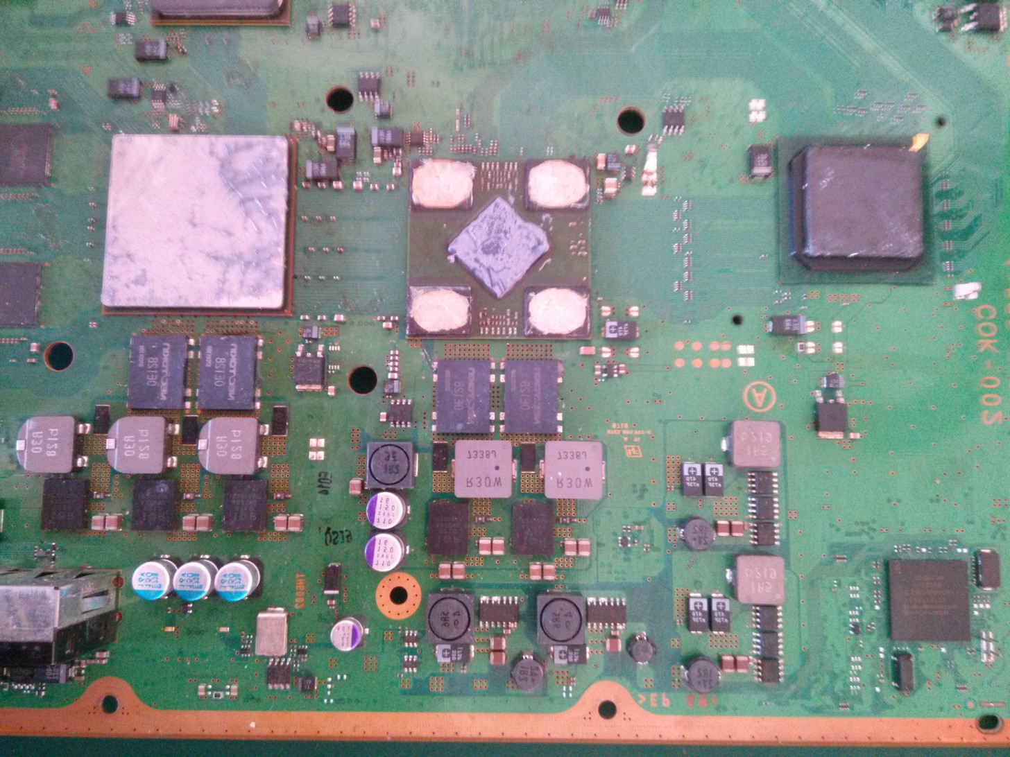

                        Please dont touch components after trying this!
                        the PS3 rsx (gpu) and cell be (processor) uses these ugly ihs to dissepate. the problem of overheating lays under the ihs which is a pita to remove. i see you have managed somehow removing the gpu ihs. now, you need thermal paste, preferably as5 for the gpu chip and THERMAL GLUE for the ram chips.
                        If you jailbreaked your ps3, thats another story, you can show the temperatures using multiman and several othe homebrew softwares. In most cases you will notice that in fact its the CELL BE which overheats. removing the cell ihs requires maximum efforts http://bgamods.com/forum/viewtopic.p...it=ihs+removal
                          Thanks for yur inputs Senndogg!
                          But now I'm in a dilemma.
                          First of all, the gpu ihs came allready like this when it came to me.
                          The PS didnt turn on, just blinked the red light.
                          I've reflowed GPU and now it turns on, but when on main screen to choose HDMI and video source, if I let it 2 mins without pressing any button, the fan starts to increase speed step by step, until overheating message.
                          Now that I've recieved some opinions regarding changing the NecTokin caps, I was going to do so.
                          Now that I've read your post, I'm kinda lost.
                          The PS isnt jailbreaked so I cant see which chip is getting overheating problems!
                          How can I proceed correctly from this point on?
                          Thanks for all your help!
                            If you applied thermal paste enough and the fan is still kicking in loud then the issue is probably the thermal paste under processor CELL BE IHS.
                            Dont get me wrong The unique but this is typical if Fat Nand consoles. (In this case CECHC 4 usb and mem cards)
                              The fan starts normally...and about 1 min after turning it on I can hear it going to stage 2-3 and finally maximum fan speed in about 2-3 minutes.
                              It doesnt start at full load.
                              So you recommend removing the other IHS and apply new paste right?
                              Gonna see that post and try to do it ... do you recommend applying heat during process?
                              Cheers
                              • senndogg
                                • Dec 2011
                                • 383
                                • Albania
                                Nope, no heat for the cell be. just follow the tutorial like the one at bgamods, the one i linked you. NEVER use a razor or edge like knife. In contrary to the rsx, the cell be ihs is glued with soft silicon, you need to cut it in less than 1mm space without touching the chip, crazy thing. whatever you do, dont rush, even you havent cut 10% in 30minutes.
                                than apply quality thermal paste to the sole chip and try to fix it just for a try. dont worry, the 2 big screws will tight that securely.
