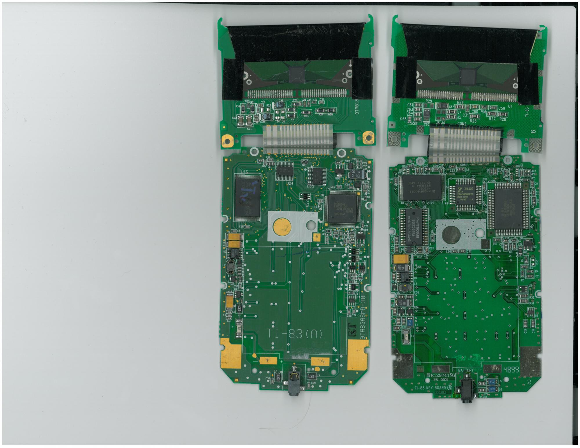

    My girlfriend and I each have a broken TI83+ graphing calculator. One night I boasted that I bet I could fix both of them; she laughed and said that she didn't think so. Anyways, long story short: we have a very lucrative bet going on now. This is not about money, or if it is "worth it" to fix these. I NEED to win this bet (if you get my drift.) I've got good soldering skills so that won't be an issue. I need advice where to start. I'm fairly lost with these surface mount devices. I've attached a high resolution scan http://www.imagebam.com/image/978df4175166479 of the PCB and greatly appreciate ANY and ALL suggestions. Thanks in advance!

      Wow, I'm an idiot. When powered on, one does not respond/turn on at all and the other has a completely black screen (as if all pixels are turned on.)
      Is there anything else I can tell you?

              I see the boards are different. That means you won't be swapping any chips. The ribbons look like they are glued on with anisotropic paste so you won't be swapping those.
              I think this one will be won by subterfuge. Buy two new calculators and put the guts into the old cases. Be sure to fix them at different times so it looks like you're hardly working--I mean working hard.

                Re: TI83+ graphing calculator
                At minimum contrast, there will appear to be nothing on the display. At maximum contrast, it will look like every pixel on the display is turned on. It appears that you checked the contrast already. Maybe you could look for any activity from the CPU or the custom chips. I don't know what activity the custom chips would produce, but the one on the right has a standard Z80 CPU.
                Also, Imagebam was the first image host I encountered that attempted to download malware onto my computer. I am not going to open that link to see if that still happens.

                  Iti: I'm more than willing to host the pictures any place you feel safe. I use imagebam a lot because it doesn't require an account and holds a fairly large size image. I wanted to be sure to preserve the detail.
                  What about replacing the capacitors with new ones? Can anyone help me identify whats what on this board and where they are at. I can start there and if I don't succeed I can move onto the chips next.

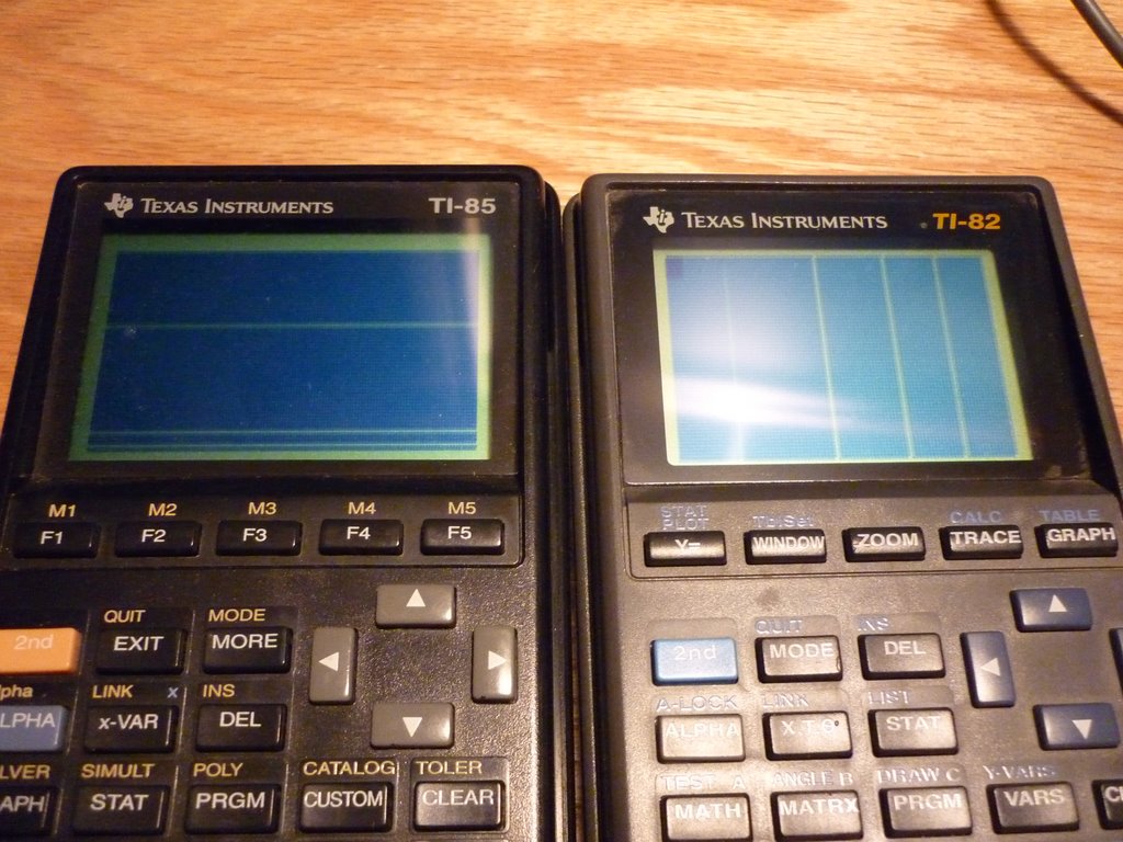

                                I can also vouch that the screens are problematic. Here is my trusty TI-85 and also a TI-82 that I picked up at a yard sale for 75 cents. The TI-85 has 3 dead horizontal lines (as a result of letting my sister borrow it) and the TI-82 has 3 or 4 dead vertical lines (as a result of leaving it in the cold garage).
                                The 85 didn't seem fixable. No ribbon cable just the rubber mat connection between the glass and the board. The 82 probably has a ribbon but I haven't cracked it open yet.

                                      You should get circuit diagrams of these, and check the voltages of power rails.

                                        Do you have a scope or an LA? The one on the right has a discrete CPU (it's probably an older revision) so you could check if there is any activity on the address/data pins, and that the clock inputs are OK.
                                        As for schematics... a quick Google search proved futile, but a hint I got was to get the FCC ID (if there is any) and look that up on the FCC website. You might be able to find schematics there.
