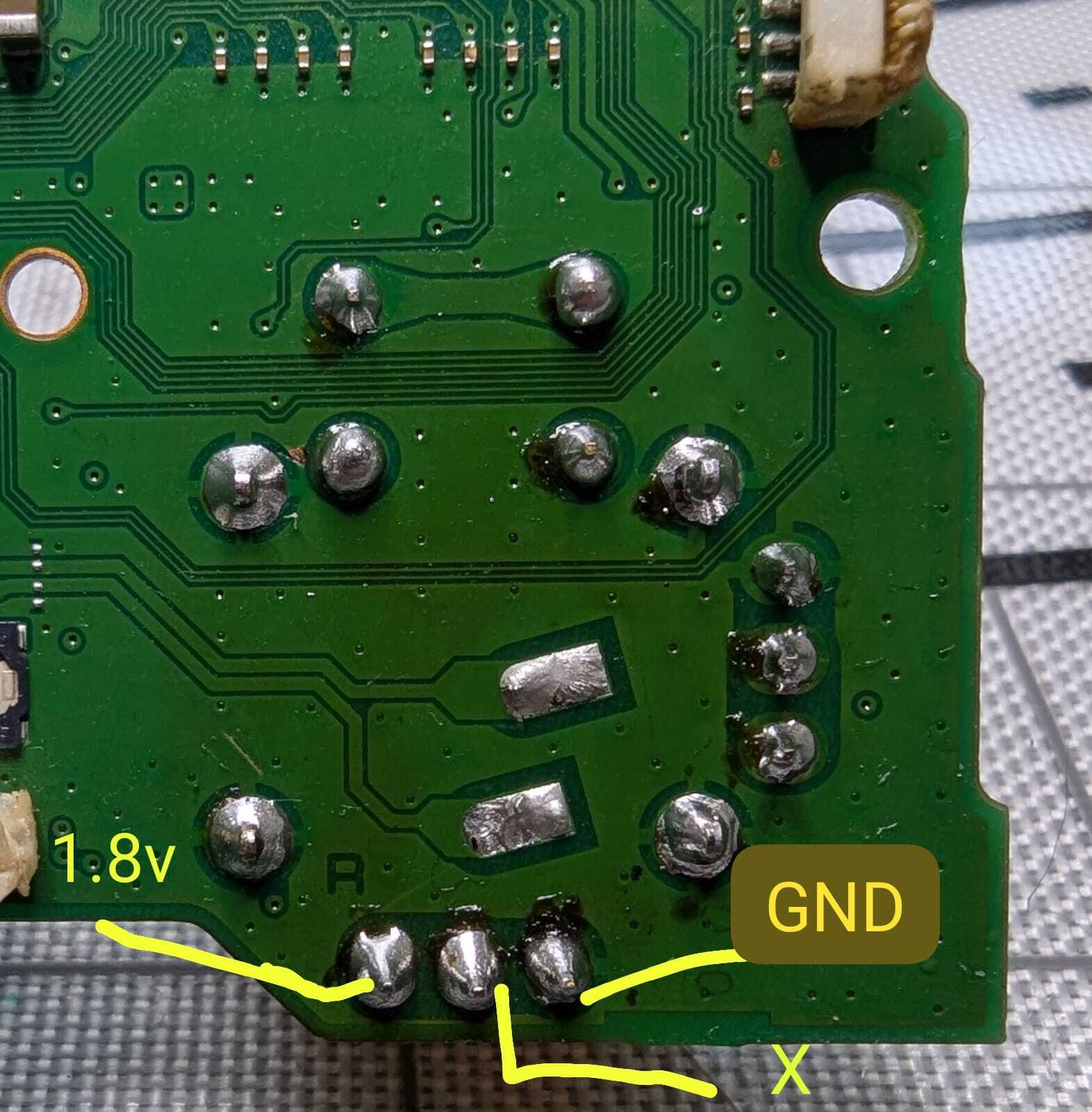

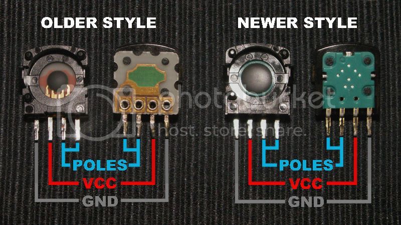

          Some things to try
          Check the middle pin on the left stick X axis potentiometer
          If using regular potentiometers, measure resistance from the middle pin to both outer pins, with the stick in the center position it should be around 1.15k, the potentiometers are 2.3k
          The potentiometer acts as a voltage divider, the aftermarket hall effect and TMR sticks send a voltage instead that corresponds to the position on the stick
          On one end you have GND, the other end is VCC, I think is 1.8v for the dualsense, not sure
          Check diode mode on your multimeter with red probe on GND, black probe on the middle pin on the board, you should get a reading there

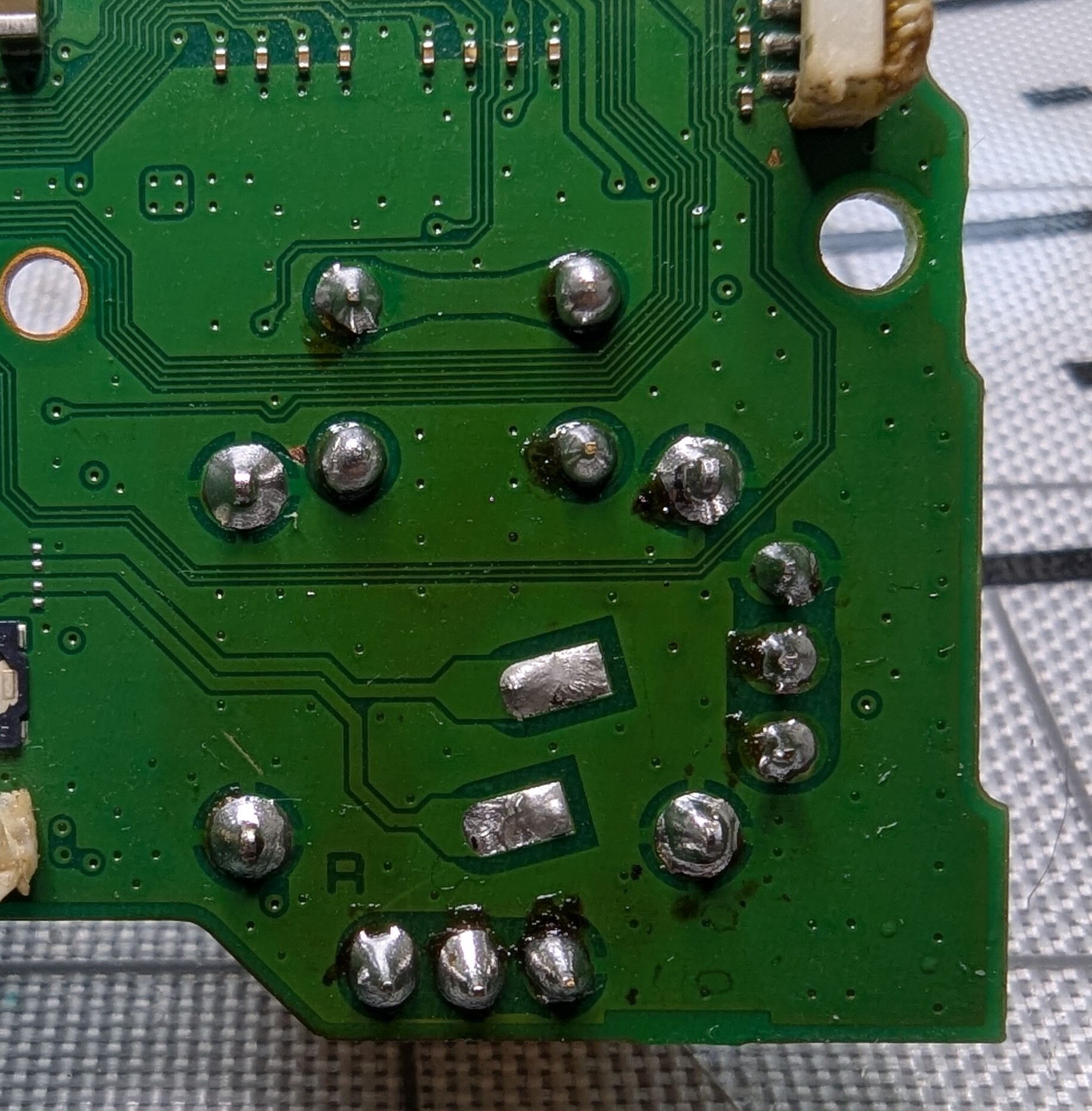

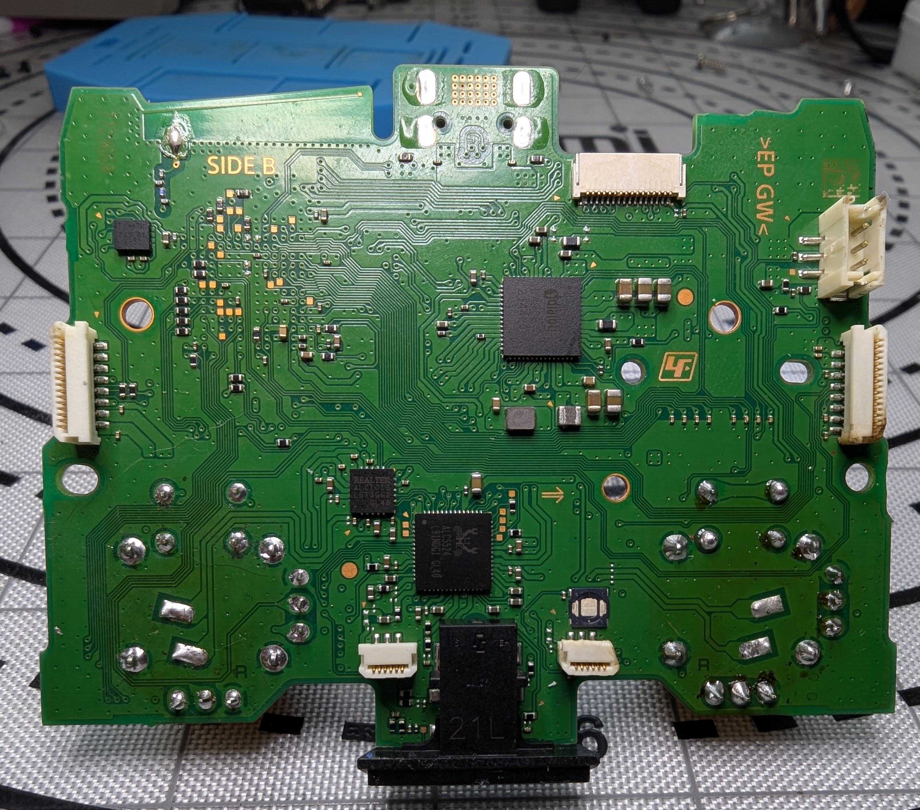

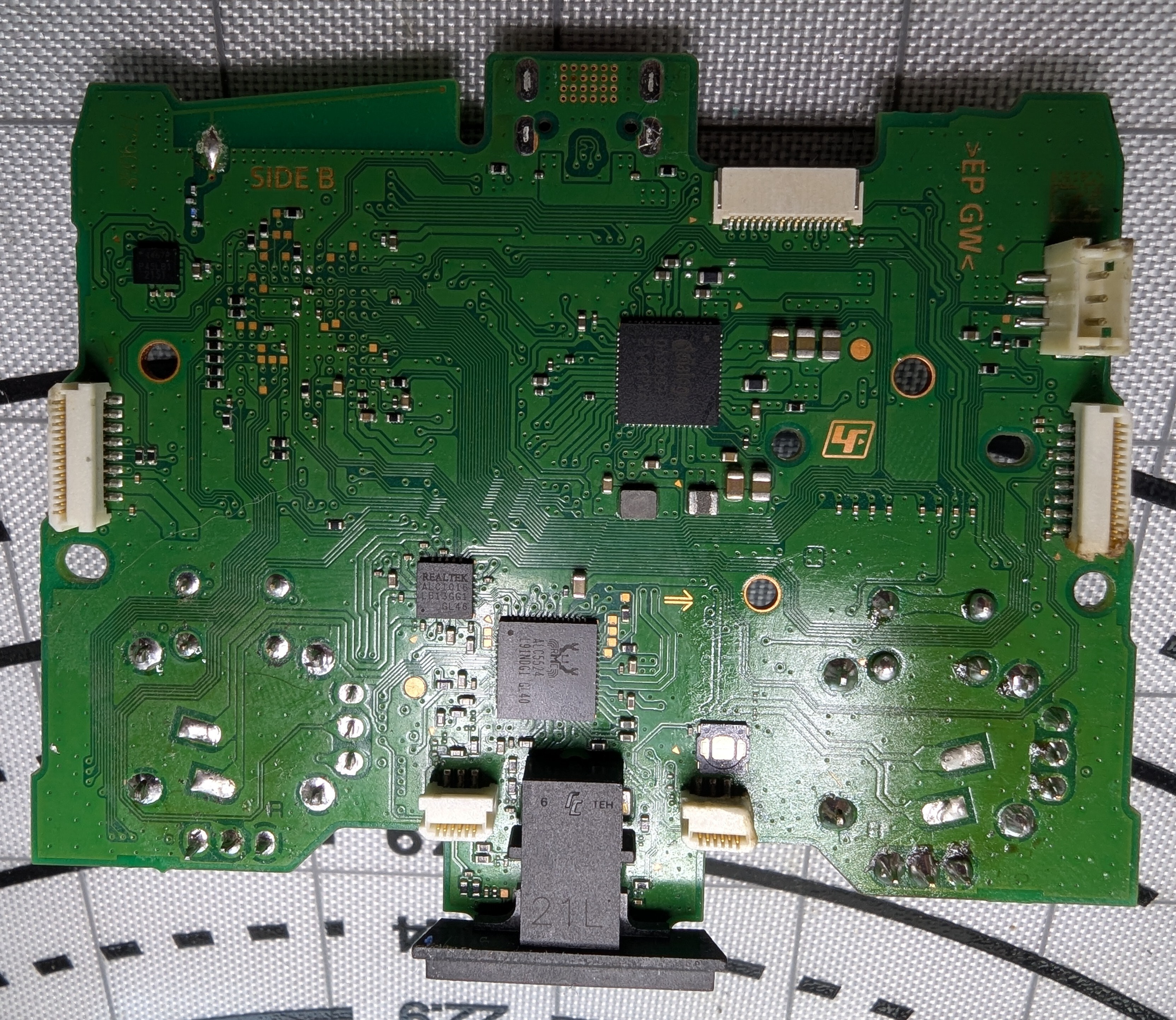

                Hi, Please post pictures of both sides of the board, there are 5 revisions of the dualsense (BDM-***)
                Also a close up picture of both sides of the board where the left stick is located
                The traces from the sticks go directly to the main MCU, it may be broken somewhere

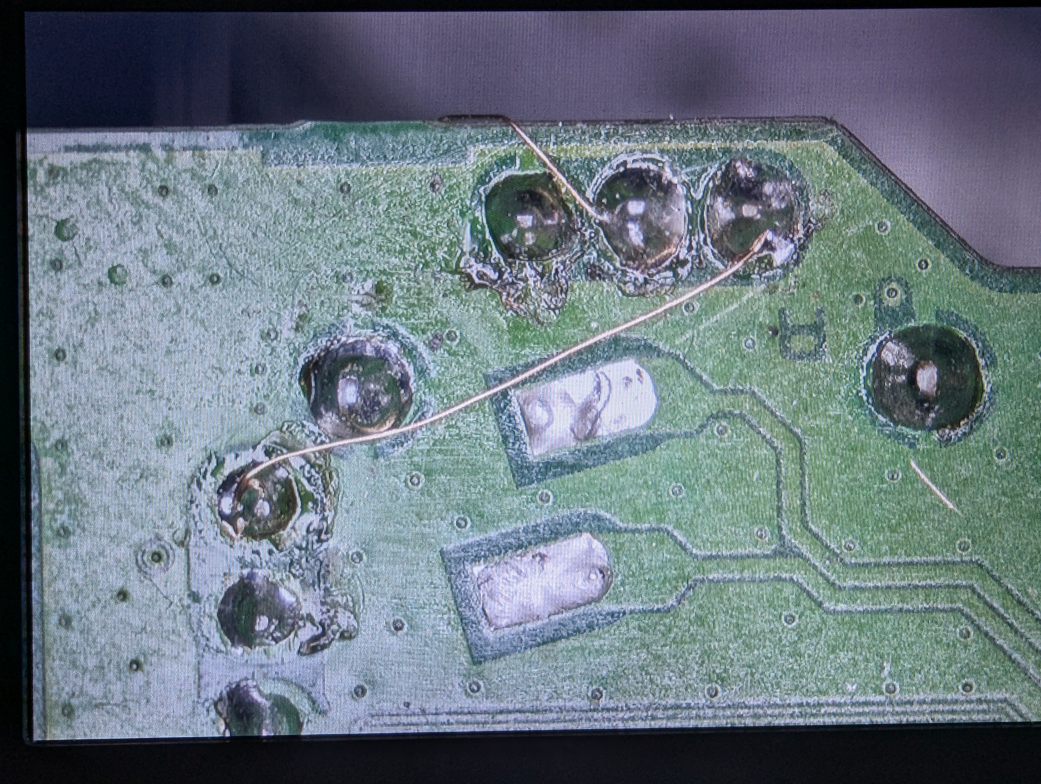

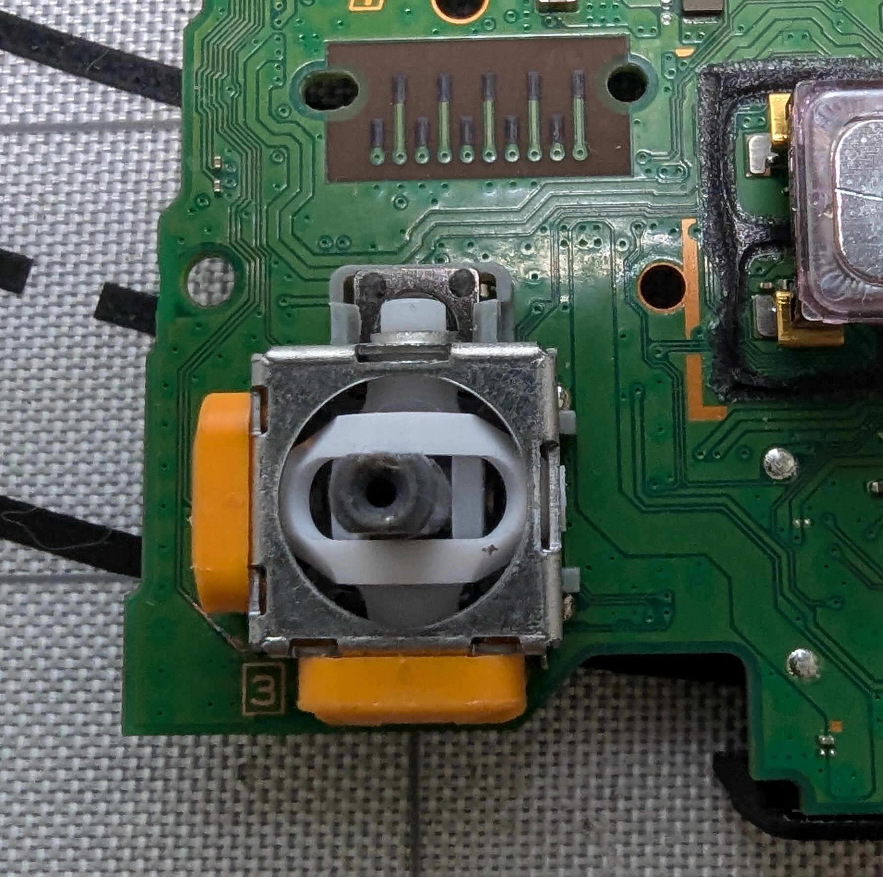

                  Please find pics attached. The copper trace in the front was scratched by me because there was a lot of dirt and wanted to check for damaged. But the fault was already there.

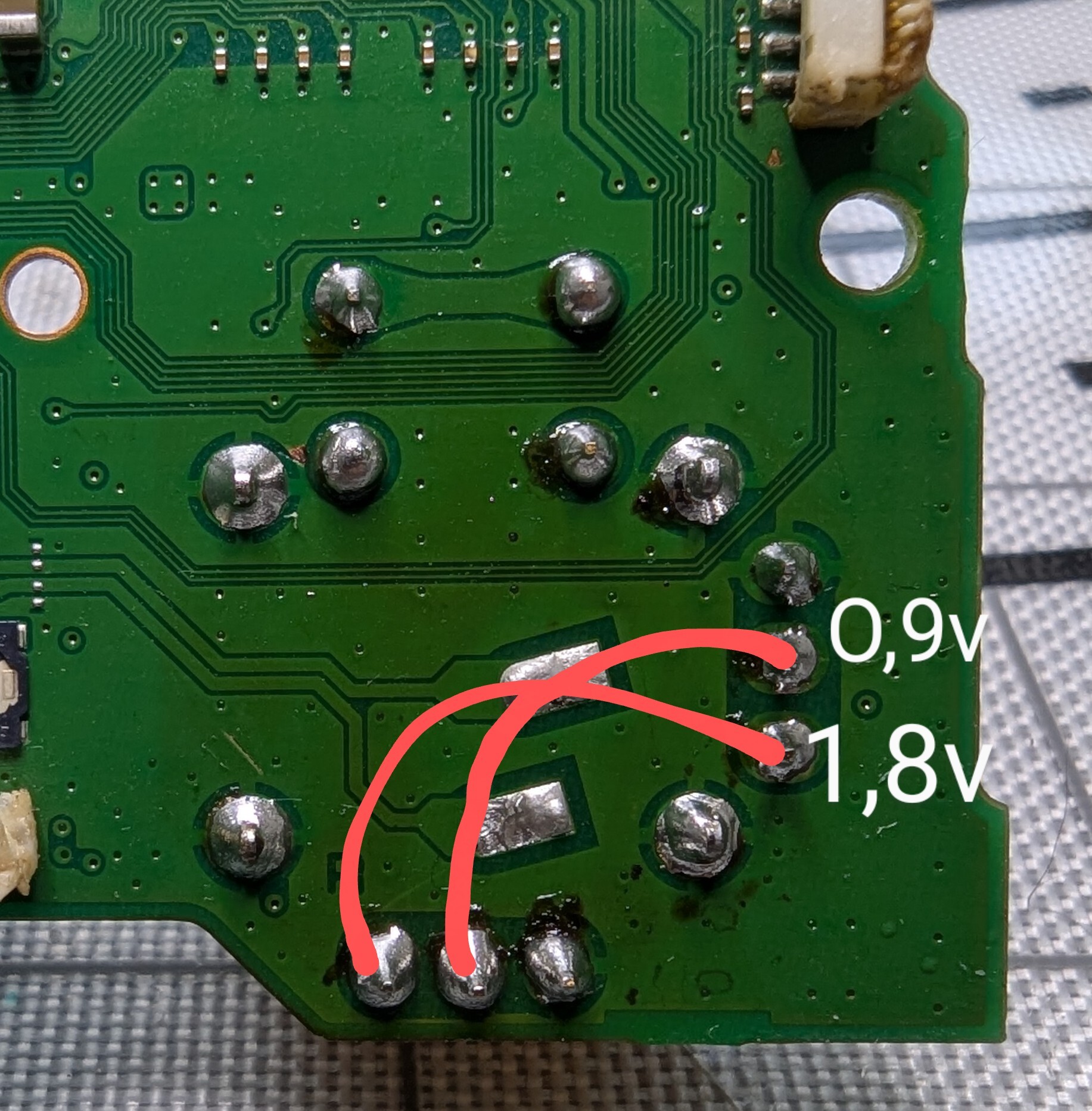

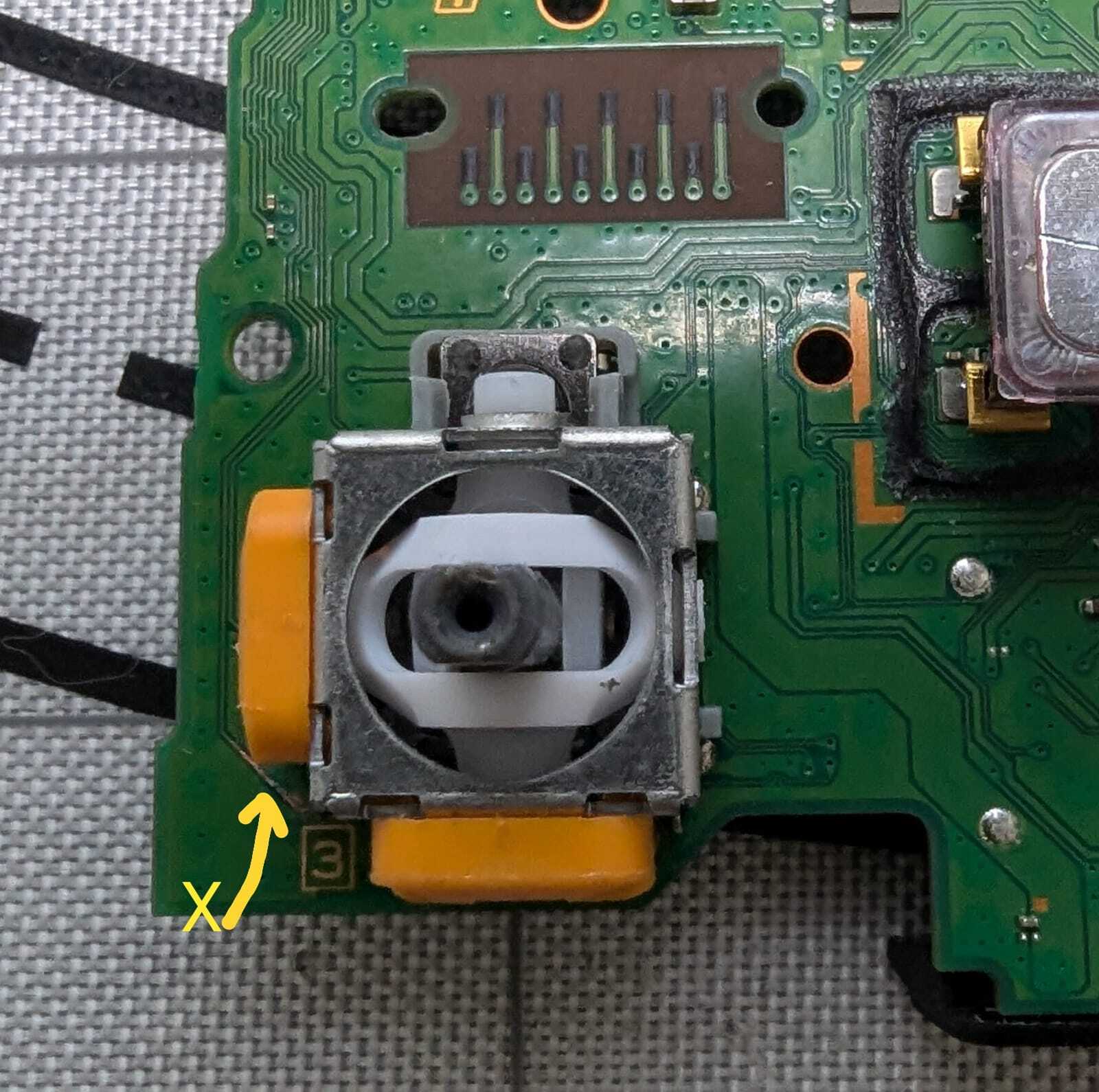

                    Measure voltage at the place where I marked 1.8v on the first picture, also measure voltage at the middle pin, marked "X" on the pictures
                    With the stick centered, voltage should be around 0.9v, moving side to side should vary from 0 to 1.8v
                    Also check continuity between the two points marked "X" (middle pin, and where you scratched the trace), it should read 0 ohm, if not, solder a jumper wire from the middle pin and the exposed trace

                      Thank you for the Input buddy!
                      All lines show no voltages. Also soldering a wire between the X points didn't help even If there was no continuity.
                      Can i solder jumper wires from the marked points to get the voltages?

                        Bridge only the 1.8v if it's missing on the X axis potentiometer, the "0.9" is the output of the potentiometer, measure it after you fix the 1.8v
                        Moving the stick left to right should vary the voltage at the middle pin (where I marked "X")

                          @dbuergi: Inspect the soldering on the 1.8v line. The trace damage in your photo shows missing solder mask and it is easy to accidentally solder across the trace to the nearby traces.
                          Also, why so much melting damage to nearby plastic components? did you use a heat gun? There is a lot of melting to some of the white plastic connectors where flex ribbons go, and your reset button switch is destroyed.
                          A heat gun could also melt the plastic internals of the joystick so it will never work properly.
                          These joysticks have orange pots. Are you sure these are hall effect sensors? or are they TMR sensors? If these are TMR, they may operate differently than resistance pots or hall effect sensors.

                            i got this controller in a bunch of non working return shipments. Already looked like this.
                            The dealer on ebay offered them as hall effect sticks but the problem was there before.
                            Main fault was a damaged USB port which i repaired and now i try to fix the stick.

                              It's fixed! One wire did the trick. It's insulated copper but i will also ad a UV mask.
                              Thanks for the help of everyone!
