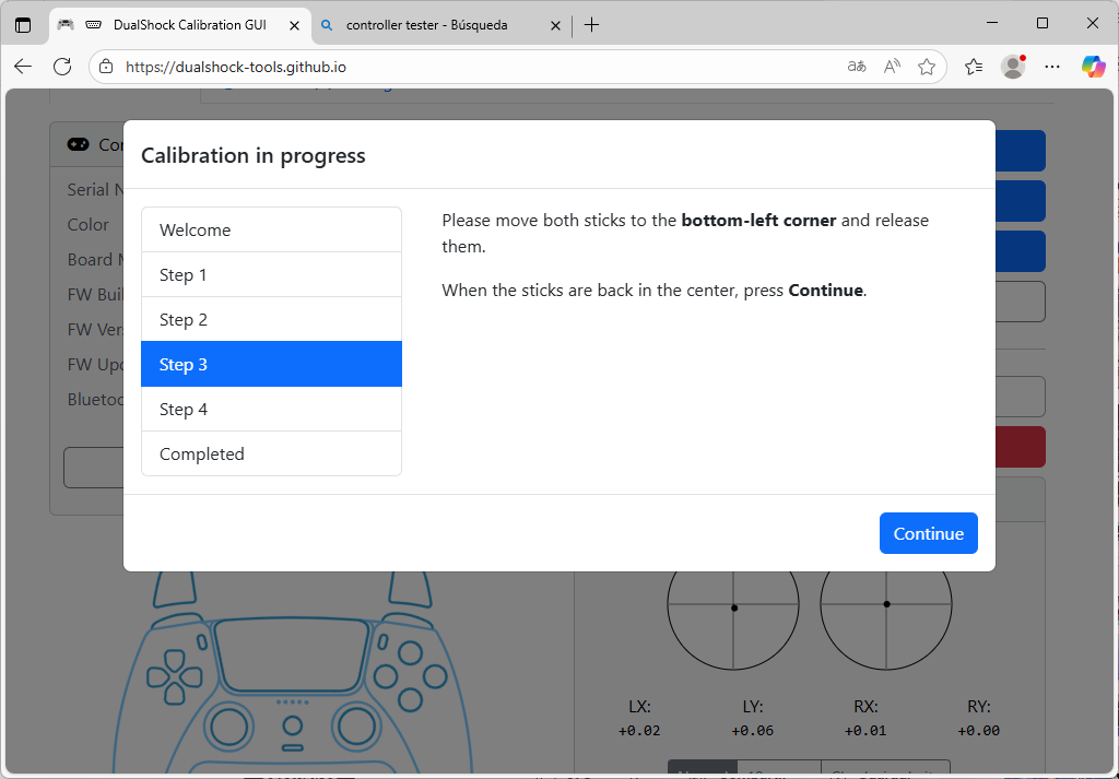

    I’ve been dealing with some stick drift issues on PS5 DualSense controllers. I’ve replaced the analogs on 4 different controllers using parts from 3 different suppliers (Mobile Sentrix and some from eBay), but I’m still getting slight drift, around 0.01 to 0.05 — only noticeable when zoomed in on the DualSense test GUI.
    Anyone else had this happen even after replacing the sticks? Not sure if it’s the parts, or fault with the controller, or just how sensitive these are. Would really appreciate any tips or suggestions!

      You need to calibrate the controller, as the sticks themselves have manufacturing tolerances
      Use this page https://dualshock-tools.github.io/ and follow the instructions there

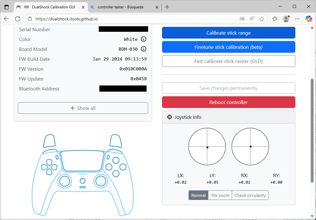

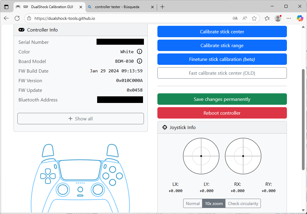

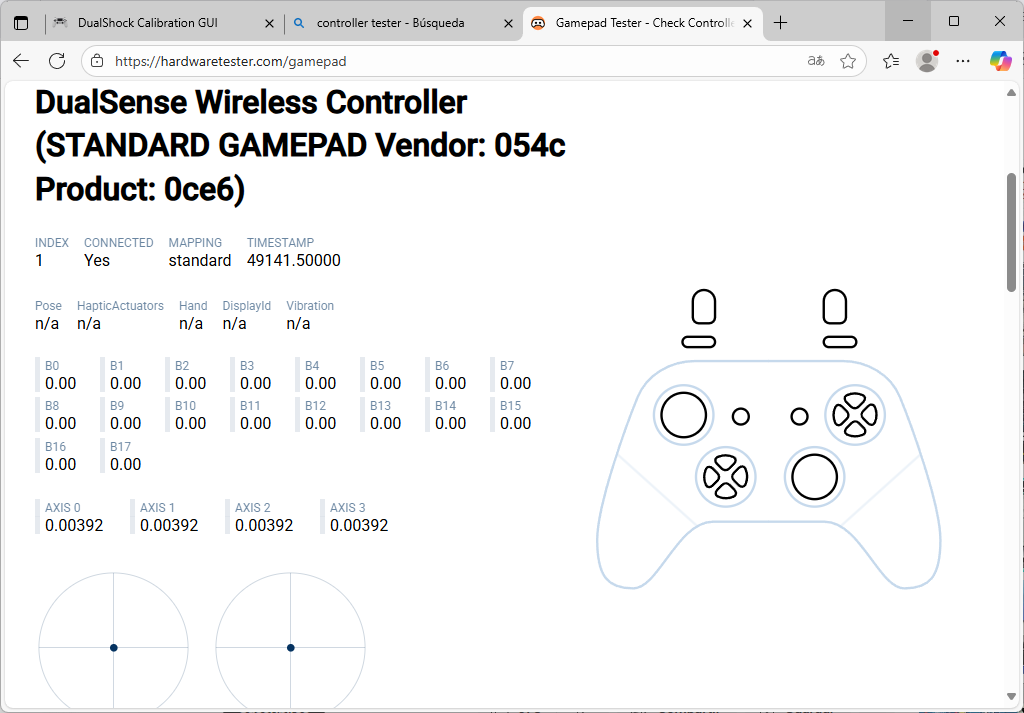

        I just did mine, on that page https://dualshock-tools.github.io/ ; use Chrome or MS Edge, doesn't work on Firefox, click Connect button, select your controller, then click on "Calibrate stick center"
        For calibrating stick range (may or may nor be needed, test moving the sticks in circles), do it with the controller fully assembled
        Follow the instructions, and after you're happy with the calibration, press "Save changes permanently" button, then press "Reboot controller", calibration should be saved
        Here's some screenshots of the process
