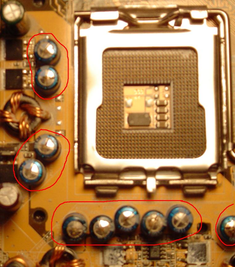

ASUS P5GDC-V DELUXE - Very recent board, bad caps
Re: ASUS P5GDC-V DELUXE - Very recent board, bad caps
I received my replacement board today. It's a newer revision of the same model and the affected caps are all a different brand.
I'm glad they corrected their error, but it would've saved me a lot of hassle if they had used good caps from the very beginning...

my housemate had the same asus MB, and problem!
my pics look nearly exactly the same, so I won't post them.
it all started about about mid summer early this year (Aussie)
system would occasionally crash, bsod etc.
went through all the usual sypmtoms, eventually saw the
caps leaking. He put up with it by adding extra cooling, but that
was only good for a while, then when the heat came back on this
summer, prob back. so I found a suitable repalcement in farnell
and went onto the job of replacing.
I had forgotton about the stackcool layer on MB (essentially just another
piece of PCB attached at critical points to the MB) but it acts like a
big heatsink, and took about an hour to remove (without damage)
by careful use of desolder wick. I was then able to attack the caps in
the normal manner. Just using the standard technique with the stackcool in
place was not possible (too much heat needed and still not melting solder closest to topside).
The caps I used were SANYO 6SP680M (not stocked by farnell anymore).
The end result was board worked again, and all instablity gone
he can actually now OC the board and stay stable.
Andrew

Thank you for this site!!! MY P5GDC-V looks exactly like that. All of those caps are oozing. The thing is with this board, its hard to see those with the heatsink fan on. I didnt even think to check under there until I saw this thread. The on-board video stopped working about a month ago. I bought this board less than a year ago, where is the best place to try and get a replacement? Straight from ASUS?
This is a really pretty pathetic problem. On such a new motherboard!
Here is a picture of my P5GDC-V. These motherboards have a 3 year warranty, so I called the place I bought it from and they are RMA'ing it.
I guess I was lucky the board still worked, except for the onboard video. I could not use the onboard video at a higher res that 800x600, and the picture had bad interference lines running through it. Kind of like an old tv with an antenna. Also, it would randomly reboot when using the onboard video. Switching to external video card worked, but I didnt buy this motherboard to throw away a video card!!!
Purchased December 2004. All 10 caps show signs of bulging or brown gunk. One has it coming out the bottom. I also found a pile of brown stuff sitting on the pci-x connector. The caps appear to be the same brand and type as thatdog's.Last edited by hokieengineer; 11-30-2005, 12:07 PM.
Originally posted by thatdogBetter picture:
The caps are OST brand 680µf 4V. All ten caps of this type are bulging and oozing the brown stuff from the vents. The board was purchased from Newegg in November 2004.
Makes me think that could be the cause. Thus it's possible that Asus didn't use the right cap value! The caps likely are getting overloaded because of the microfarad rating! Also, unlike many of the OST caps, these have a bright blue wrapper! The OST caps on my Asus A7V8X-X next to the processor socket have a dark blue wrapper. And they're probably 3300 uF.Last edited by RJARRRPCGP; 12-12-2005, 06:21 PM.ASRock B550 PG Velocita
> I see something different about these OST caps. They're less than 1000 uF! But are 4V! Most motherboards don't have such cap values, AFAIK.
Normally, the low voltage, low capacitance caps in the CPU/VRM section are Solid-Polymer-Aluminium (SPA) caps, typically from Fujitsu. These are the small yellow caps with a K-vent on many Intel motherboards.
It's possible that Asus cheaped out and went for a less expensive, conventional Al electrolytic from OST, and those can't handle the high ripple currents that the SPAs are designed for. Hence the blow-outs.
Originally posted by AK0RThe 4V rating means that everything (CPU, memory, AGP, etc.) is being regulated off the 3.3V supply.
Most probably the caps are located after the VRM's so the input side on the VRM sees 12v but the output only CPU vcore, i.e. around 1,5v... So the 4v caps should be more than enough... A test with a multimeter would be easy enough to verify this..."The one who says it cannot be done should never interrupt the one who is doing it."
Sorry, I was thinking the caps were filtering the input voltage.
Per's right, the caps should be filtering whatever is coming out of the VRMs, for all their various functions. I think linuxguru hit the nail on the head; a total misapplication of required function, trying to save a few cents per board.
