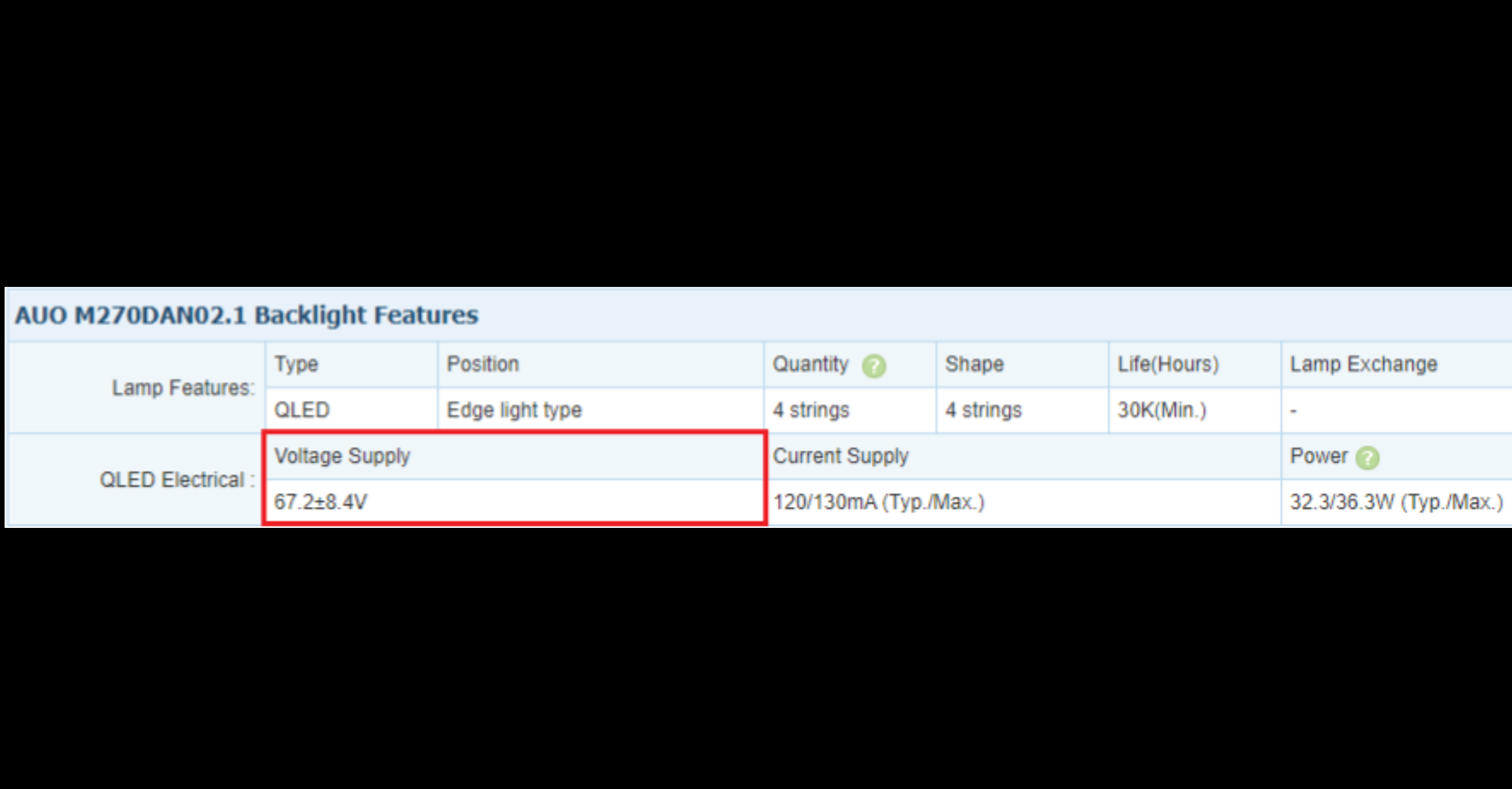

                    I can't be totally sure as it was a little while ago now, chances are if you have some voltage then the PSU is at least working to some degree and probably fine. It will probably be ok because as CapLeaker said LEDS are really current driven. If you are really worried and at a push I could take the monitor apart again and measure the voltages on the pins and let you know. It might be that the PSU is dropping the current which in turn is causing a drop in the measured voltage as it has detected that there is an issue with the LED strip. As CapLeaker also pointed out that:
                    LEDs are current controlled not voltage controlled. Thats how the PSU is able to shut down, otherwise the TV could burn your house down. Fix the LED's. The PSU is fine. Before you look for LEDs you got to be able to get to the LED strips first place without breaking anything else like the screen in the process.

                        ISquishWorms, BenQ tech support replied back with the data!
                        Click image for larger version  Name:	Screenshot_20240903-094239~4.png Views:	0 Size:	235.5 KB ID:	3342644
                        So my measured voltage is half of the nominal...
                        Does it really tell that there is an issue with the PSU board or it's low as a result of the current being cut off?
