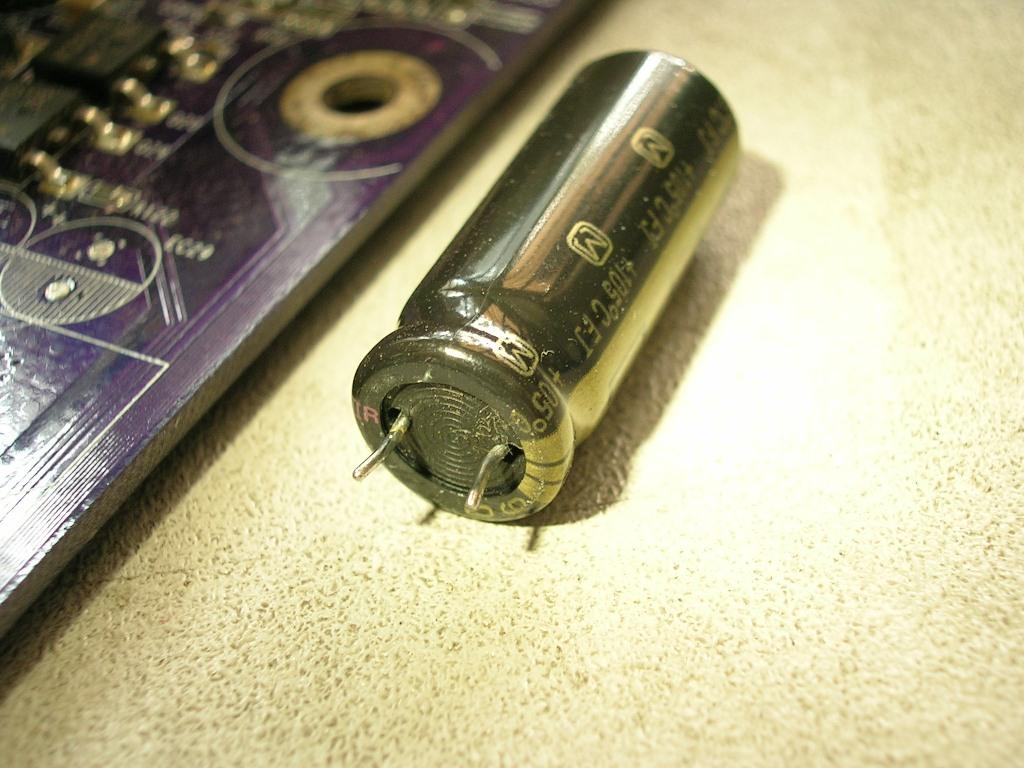

    LGA775 mobo from Acer, with suspicious FJ caps ? The rubber seal is just strange. Could it be counterfeit part ?
    Re: Fake Panasonic FJ ?
    Fake.
    Panasonic rubber bung is very unique and very nicely made. Take more pics in detail of this fake caps including vent top.
    Cheers, Wizard
      I opened this in Paint Shop and messed with it a bit. The vent marks look correct, and you can see the end of the line of the date code next to the left hand leg.
      What is the date code? Roll that cap over a bit more and show the line of numbers & letters in dark red, heat stamped onto it.
      Also, that can has a dent in it. It's now probably bad.

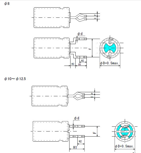

        Taken from the engineering draft on the FJ series. The bung does indeed look wrong.
        Caveat is that it's a draft and no sheet exists in the "real world" to confirm or deny.

            PS, I have looked at lot of capacitors in electronic service, recovering good ones and replacing bad ones (even good ones do go bad eventually.) This capacitor rubber bung design (circular ridges and flat) is not Panasonic's unique design. The engineering drawings and other photos of geniune panny capacitors of these bungs is correctly Panasonic own.
            That flat bung with circular ridges is COMMONLY associated with low quality capacitors. I see this on many funny sounding capacitors as well, including Yublight, etc.
            Reason for the specially designed bungs are to stand up the capacitors and sit upright correctly before soldering process, and to vent cleaning solution/allow flushing out cleaning stuff. The low quality capacitors that does not have this design sits flat and trap stuff, which is not great thing to begin with.

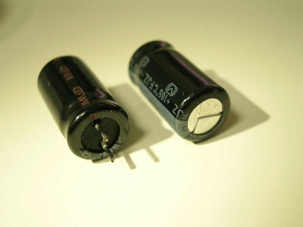

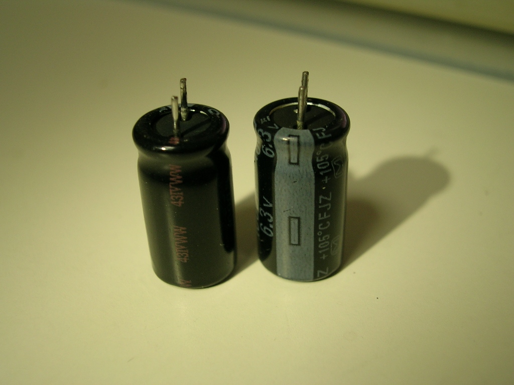

              The DATE CODE:
              The TOP VENT:
                The bung screams fake, but the date code and vent are consistent with some Panasonic FLs that I pulled out of an Asus mobo. Maybe it's some cost-reduced FJ built specifically for Acer - certainly very odd.

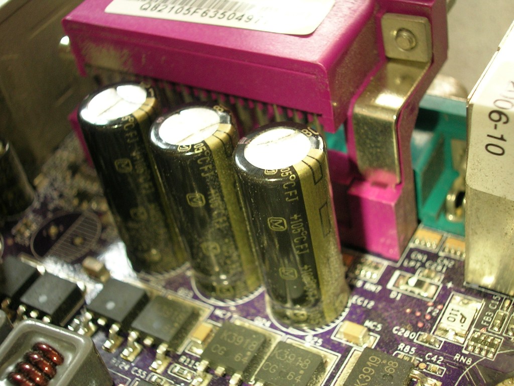

                          Is FJZ an improved version of FJ ? Below is the picture of Panasonic FJZ series ( from MSI K8N-Neo4 ).
                            That's the rumor but I haven't seen anything official.

                              the First picture... looks so fake.
                              FJZ is sort of funny... i gonna de solder it and check out one of the board soon
