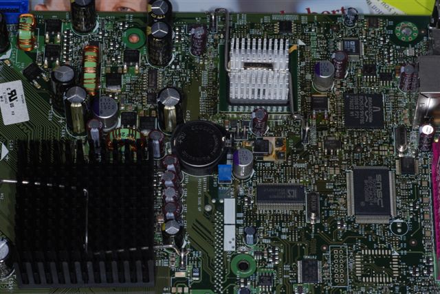

            Just posting a pic of my usff gx620 mobo. Had zero knowledge of caps before stubling across this forum. Was getting erratic usb mouse behavior and other complants. Finally the bsod occured with memory error noted. Replace with known good ram and got same bsod. Read this forum and help topic etc. and decided to pop the cover and found 6 bad 2200/6.3's. Ordered from here and then upon further reading noticed another culpret- 820/6.3 grrrrr.
            Anyway I have notice the prior pics showed three different caps that seemed to be bad are now poly's as of 2007. Just thought I'd post a pic for anyone that cares.
            Thanks all for helping us newbs not trash an expensive item instead of a quick fix (hopefully).

              Wow. Dell is a piece of work. Seems that the "replacement" motherboards that were sent out around 2009/2010 for the GX620's ONLY had the bulging caps replaced. It's funny to see a mix of Rubycon/Nichicon's of the same value on a motherboard and ever funnier to see the data code of the original Ruby MCZ's, because you KNOW they weren't replaced, and you KNOW the majority will fail RIGHT outside of the 5 year extended warranty mark. As for the boards sent out 4th quarter last year all the way until Janurary 2011, seems ALL the 2200uf, and rear 820uf caps are being replaced at the same time...the way it should have been done in the first place. Wonder what changed their tune?
