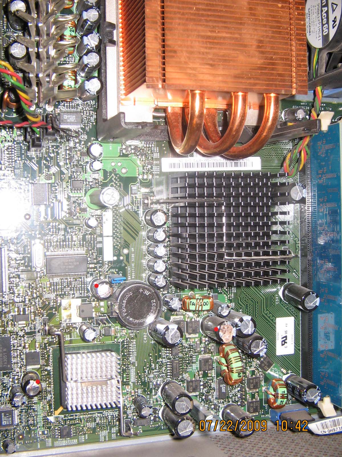

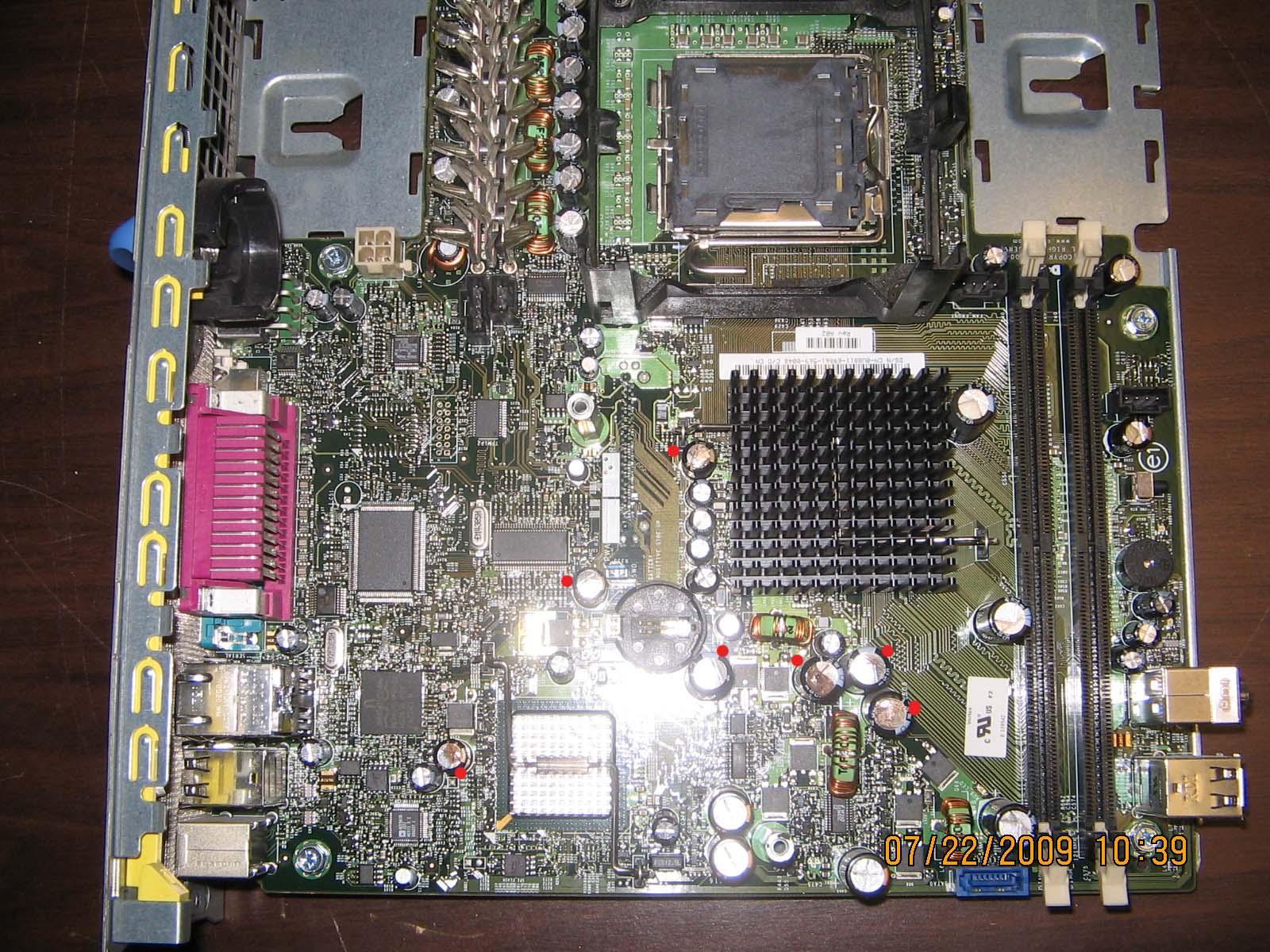

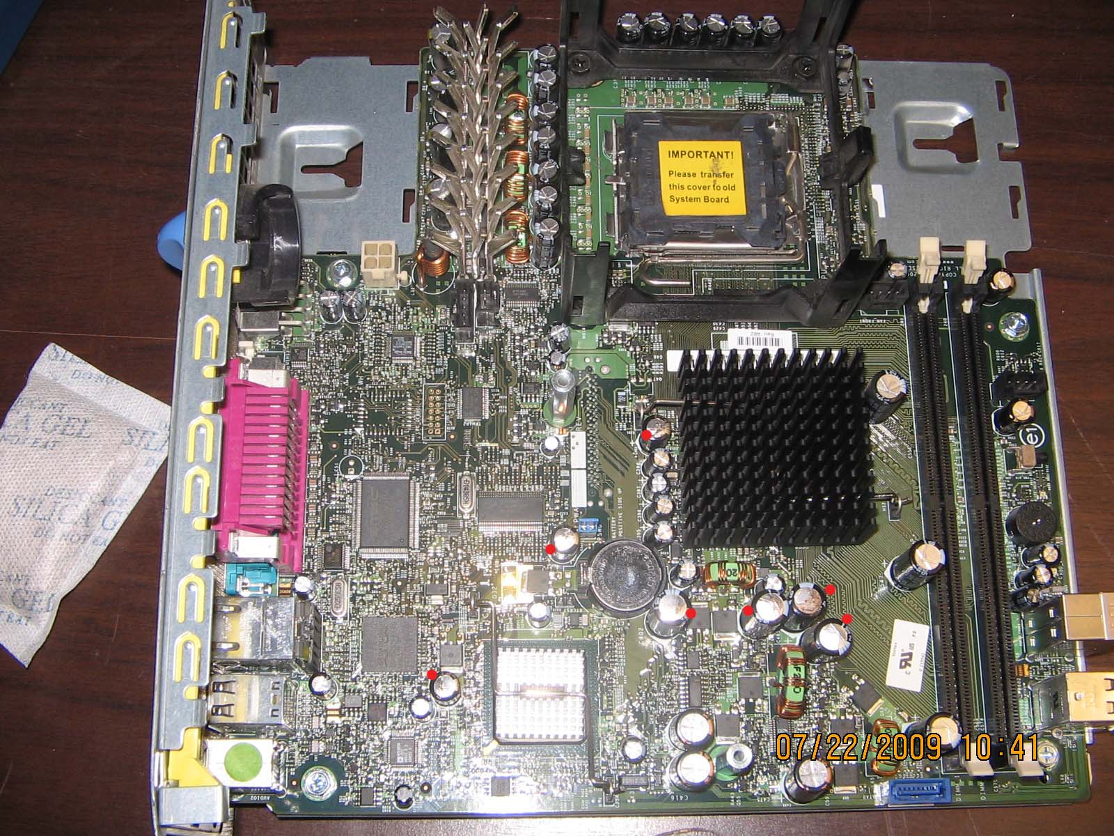

      New to the forum:
      I have 7 Dell GX620 USFF computers in the network. They are all just out of warranty. 3 of the 7 have had the caps blow. I have replaced the moboards in all 3 so far. So I have 3 moboards I want to get recaped.
      Question Can they be capped without the Processor and memory on the board and be sure they will work? The reason for that is that the computers are in use in a business enviroment.
      I have included Pic's of the motherboards and put a red dot on each cap that show signs of leakage and/or bulging. The first two computers would not even start. The last computer would post but hang up and give the message that there was no boot drive.

        Re: Dell GX620
        God those things must get really cooking in order to blow out rubys.
        You should recap without processor, ram, etc... in it. Though a few people have done it with processor in with success.
