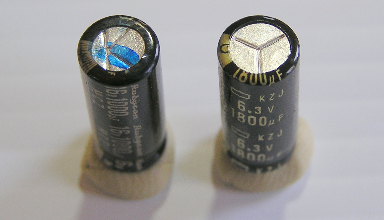

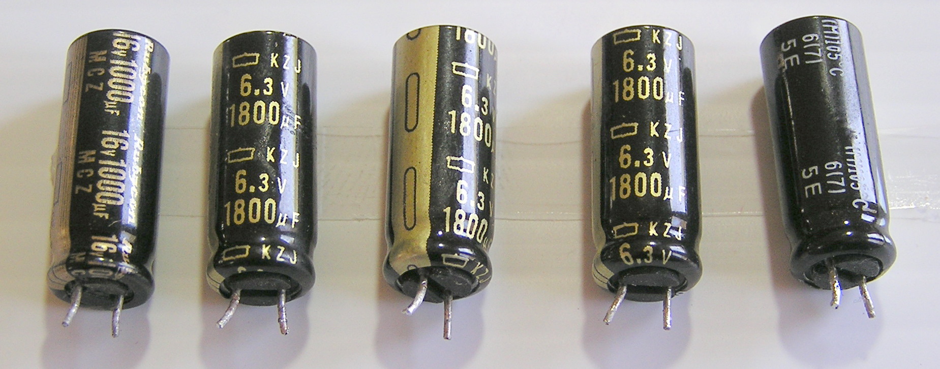

        It seems that this thread has been dormant for a while... Time to bring it back.
        I note that most of the GX620s shown here are the ultra small (external power supply) version. Has anyone had issues with failing caps on the slightly larger SFF chassis version of the 620?
        I have some GX 620 SFF units in an enclosed kiosk application and on a whim I decided to crack a few open and check the caps. Oh and these babies were quite warm as others have stated! 2 of the 3 machines that I looked at each had a single bulged and leaking cap. The first one had a bulged Rubycon MCZ 1800uf 6.3v 105c (PET date code?). This specimen also had some Panasonic 2200uf 6.3v 105c caps a bunch of little Chemi-con 220uf 16v SMG 85c caps.
        The second machine had Chemi-con caps in place of the Panasonic and one of them was bulged.
        These machines were manufactured mid 2006.
        I apologize for the poor camera phone pictures.
        So far these machines still run fine and there are no symptoms of capacitor failure evident. Also there have been no problem reports from the field either.
        What is the prognosis for these machines? Will they go for a while or is death imminent? I note that topcat now has a pre-made kit available for the 620 SFF, so that can't be a good sign right there.
        Unfortunately, there is no good way for these machines to be recapped. They would likely end up getting replaced. I am just trying to get an idea on how soon that would have to be.

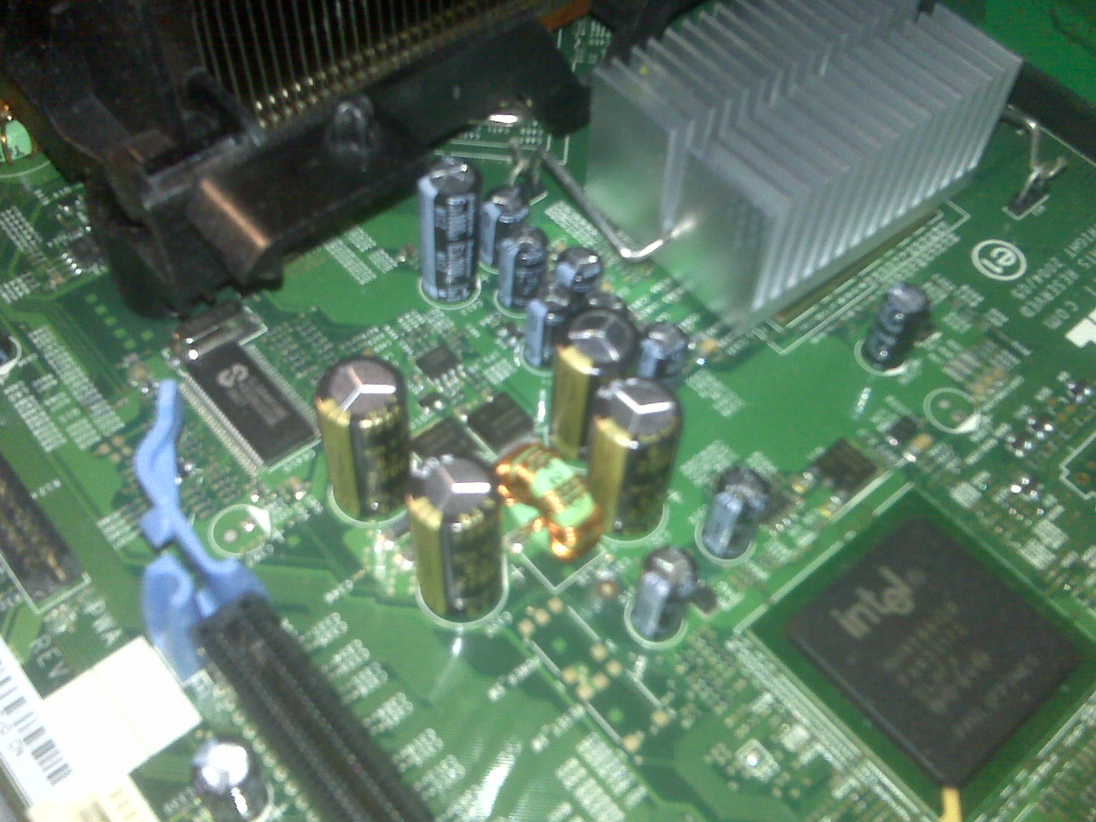

                #67
                Re: Dell GX620
                I want to post this information here, since this forum helped me figure out what was wrong with my GX620 Mini-tower. I also purchased all of my replacement caps from this site as well. This info, I just finished posting on the Dell community forum. I hope it is helpful.
                The other posts in this thread are concerning the GX620 ultra small form factor machine, which I believe has a history of worse capacitor problems due to the heat buildup in the little case. My problem was somewhat different, but it appears that replacing the caps was still what fixed it!!
                This Dell Optiplex GX620 Mini-tower appeared to work perfectly in all respects, except that if it lost power or was unplugged, I would have to continually reset the bios date/time when it booted back up. These CMOS batteries have a very long life, and it is not uncommon for them to last 10+ years, especially if the machine stays plugged in for most of that time. Replacing the battery was the easy try, but that did not fix it for me.
                I replaced the following capacitors around the 12v connector on the motherboard which is labeled HH807: C575, C555, C566, C545. Each of these caps appeared to be a no-name brand and were 1800mf, 6.3v. There were also absolutely no visible signs that these capacitors were bad. Also, C559, which was a Rubycon and 1000mf, 16v, also, no visible sign that it was bad. The 1000mf capacitor had blue ink on the top, like it had been deliberately marked, and I have a sneaking suspicion that THIS was the only capacitor that needed to be replaced. But i've read (on badcaps.net) that the no-names are sometimes very prone to failure. I also replaced C413, which is closer to the center of the board. It was also an 1800mf cap. No visible sign of failure.
                So, I can't specifically narrow it down to which one of those 6 capacitors was causing the problem, but I am fairly sure it was one or more of those. A few days earlier, I had replaced all of 27 smaller caps, and these were all of the 220mf, 16v caps. They looked slightly bulged to me and were only rated for 80 degrees C, as opposed to the other caps which had a 105 degree C rating. In retrospect, it appears that none of these smaller caps were bad or needed to be replaced and I probably wasted my time doing so. They were also a bit harder to cope with than the larger caps, so if I had found a posting like this one before I started work, it would have saved me a significant amount of time.
                I also noticed something else when I was finished. Before I replaced the 6 caps I mentioned, when I would plug the machine back up after sitting idle for a bit, I would see nothing of the power diagnostics on the front of the machine... I think... or possibly I might have not noticed before. I doubt it. I believe that plugging the machine in before the repair resulted in nothing visible except for the amber "aux power" light on the motherboard. AFTER replacing the 6 caps, whenever I plugged the machine in, it would appear to run a quick power diagnostic, which was visible from the indicators on the front of the machine. I push the power button, and it boots up now without begging to know what time of day it is and my bios settings are preserved.
                Thanks to badcaps.net for the assist. I hope this info makes very easy work for the next person to have this problem!

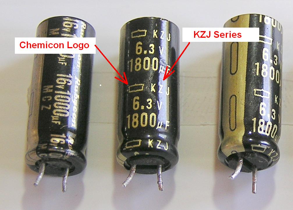

                                  I looked around a bit and found a thread titled "A Look at Caps for Indonesia Market" and found some great photos of Chemicon caps that look exactly like these that I suspect I've had problems with. It wasn't the discussion I thought I had seen on "fake Rubycons". The only difference is in the coloring. These caps look very similar to the Rubycon just in the fact that they have the black and gold coloring. In each photo, the Rubycon cap is on the left for a comparison.
                                  • PCBONEZ
                                    Grumpy Old Fart
                                    • Aug 2005
                                    • 10661
                                    #77
                                    Re: Dell GX620
                                    Chemicon KZJ
                                    Susupected of the same heat issues as Chemicon KZG.
                                    [Chemicon = UCC]
