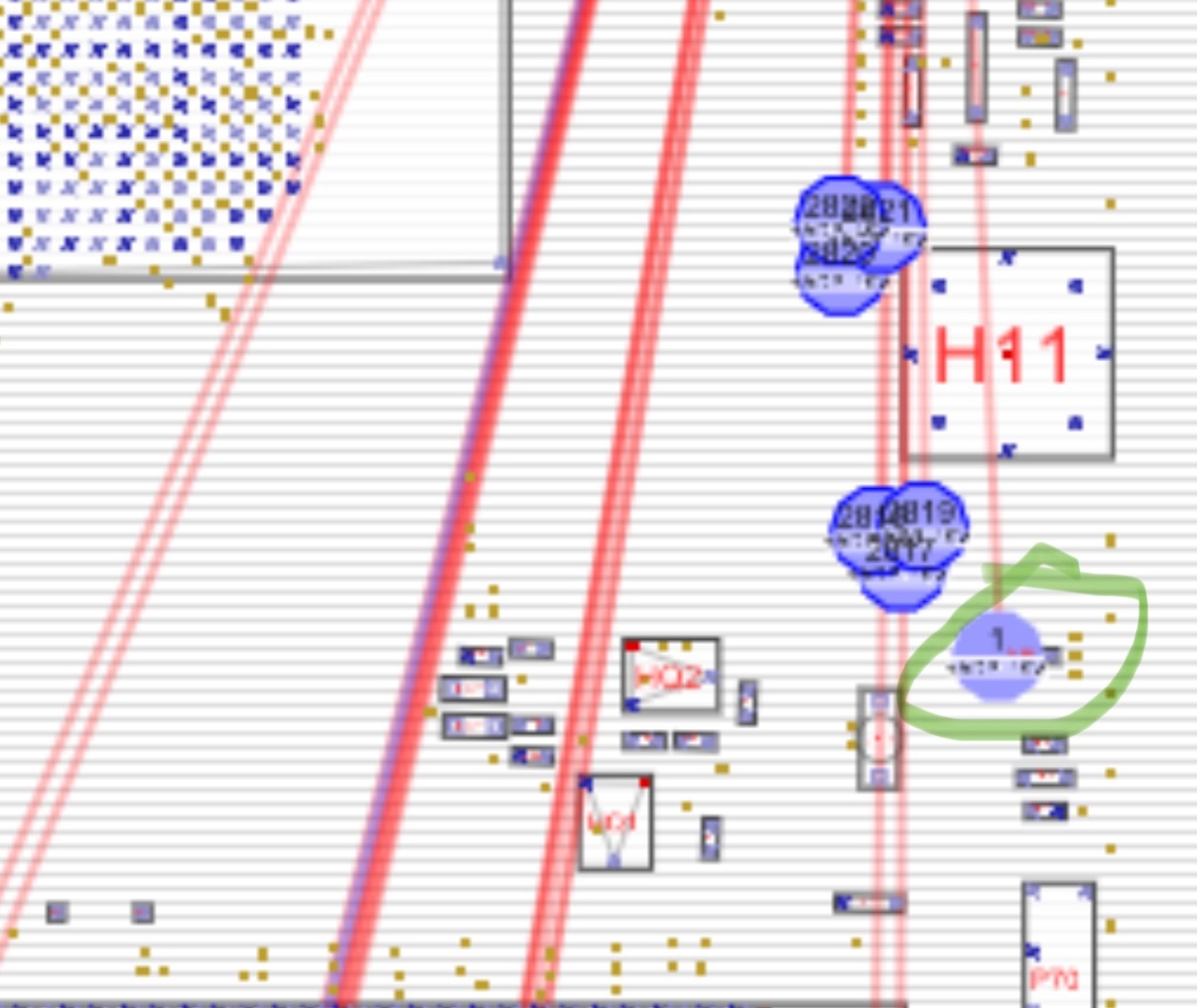

                        Sorry for the delay in checking, was out of town. So I injected power but I don't see anything getting hot. Any other way of finding the short?
                        • Geeker007
                          • Jan 2025
                          • 24

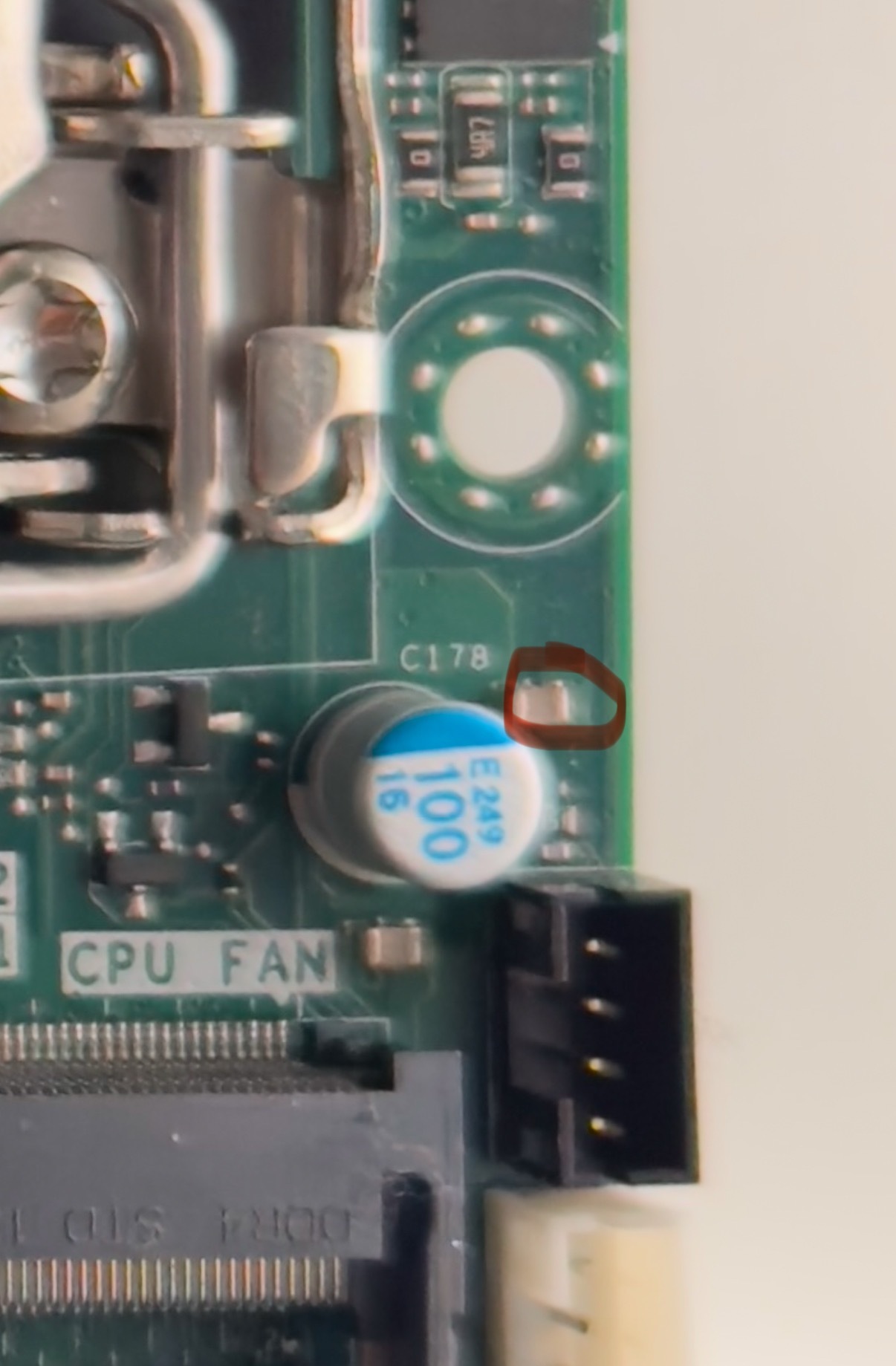

                          SMDFlea and dellxps15 So I was able to find the short. Thank you so much for your help. So it was a capacitor. I removed it and now short is gone. But I don’t have replacement capacitor.
                          Can I use the PC without that capacitor or I need to replace it. Can you please let me know its value if it is needed and I will try to find it on some donor board.
                          Attaching the picture of faulty capacitor highlighted in green circle.

                            I removed this one on the board. C178. I think it is 100uF/16V. So I don't have SMD capacitor. Will a normal Electrolytic Capacitor work here if I am able to find a one? I think this is in fan circuit. Please confirm.
