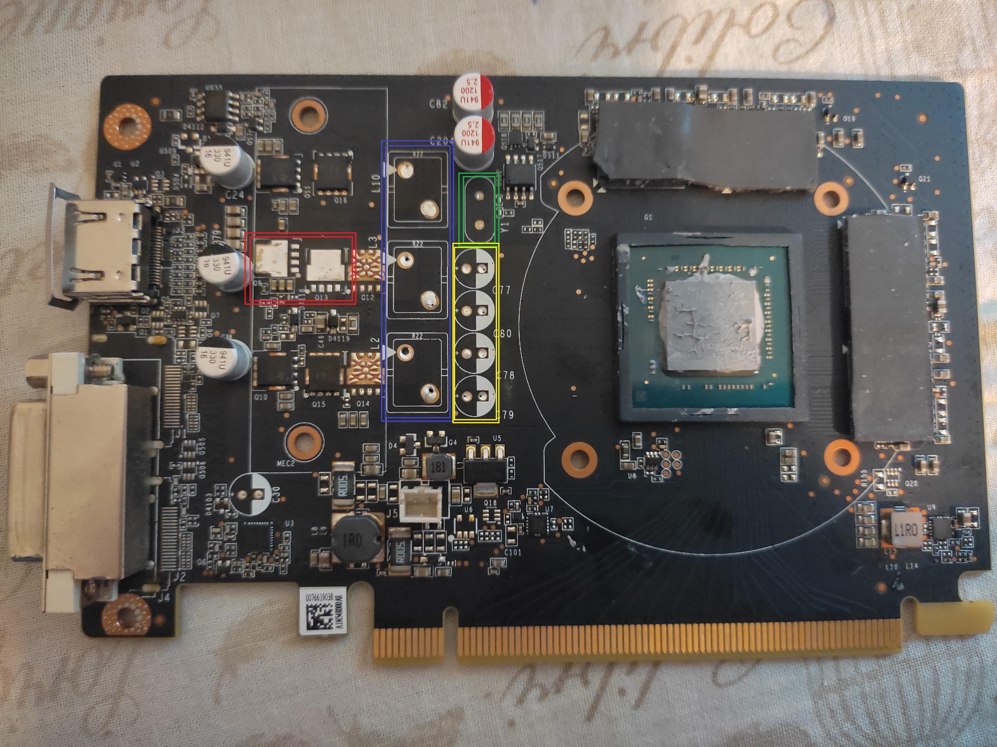

    Recently picked up this GTX1650 at a local flea market for a low price and wanted to use it on my secondary PC. I first tested the card and saw the fan spin for a split second and then nothing. Immediately I thought of a short circuit. Disassembled and found a shorted SMD capacitor, injected voltage into it (1V/4A) and two Mosfets got hot immediately (QN3103 & QN3107). Desoldered these Mosfets and the card turned back to life.
    Bought replacements from Aliexpress and replaced them afterwards. Tried the card but still the saw the fan spin for a split second and then no power. The short is still there! Removed the new Mosfets and tried the card again, still working fine. I can't seem to find exactly where the short might be. After troubleshooting a bit, beeping every SMD capacitor that could see, I couldn't find much. Even pulled some components just in case (coils, capacitors, crystal)
ID:	3255407 Click image for larger version
    To keep it short, my problem is this: When the coils are installed in the card, I get short circuit on both the Source and the Drain of the pads in the PCB where the removed Mosfets were, when the coils are Removed I get a short only in the Source but not on the Drain.
    I'm basically a noob when it comes to electronics repair but willing to learn. I have access to essential equipment (Soldering station, Hot Air station, Bench Power Supply, Thermal Camera).
    Any help would be highly appreciated. Many thanks in advance!

    Remove all power. Meter in resistance mode (not diode). Measure the resistance to ground of each of these removed mosfet PCB pads.
    So measure the resistance to ground of the source (1-2-3) pin. Then gate (4) to ground and finally drain (5-6-7-8) to ground. Repeat for each of these 2 mosfets. Post each measurement.

      Pads of the Mosfet on the left:
      Source: 12.74 kOhm - Gate: 25.7 kOhm - Drain: 17.3 Megaohms and slowly decreasing (open)
      Pads of the Mosfet on the right:
      Source: 0.1 ohm (short) - Gate: 26.64 kOhm - Drain: 12.74 kOhm

        Low voltage rails will have a low resistance reading to ground by design.
        Make the same measurements on the mosfets that are north and south of these pads. The 0.1 ohms is likely the gpu power rail and so will be the other readings.

          Here are the measurements you asked:
          The two mosfets North:
          On the left: Source: 10.22 Megaohm and slowly decreasing - Gate: OL (open) - Drain: 5.6 Megaohm and slowly decreasing
          On the right: Source: 0.1 Ohm (short) - Gate: 18.8 Megaohm and slowly decreasing - Drain: 10.35 Megaohm and slowly decreasing
          The two mosfets South:
          On the left: Source: 12.22 K-ohm - Gate: 25 K-Ohm - Drain: 14 Megaohm and slowly decreasing
          On the right: Source: 0.1 Ohm (short) - Gate: 23.63 K-Ohm - Drain: 12.22 K-Ohm​

            The mosfets are arranged as HIGH SIDE and LOW SIDE.
            HIGH SIDE mosfet Drain pin is always connected to 12V
            ​​​​​​and the Source pin is always connected to the Drain pin of the LOW SIDE mosfet and also to one pin of the inductor coil closer to the mosfet (while the other pin of the inductor coil closer to the GPU core goes directly to the GPU core) if you lifted the coils, the GPU core no longer receives VCORE and will not turn on.
            LOW SIDE mosfet Source pin is always connected to GND.
            To check if a mosfet is dead:
            Measure its resistance from Drain to Source and from Gate to Source. If you get 0 ohm on both measurements, it is dead.

                I measured all Mosfets (the 4x ones that are currently on the board and the pads of the two removed mosfets) and there is no short (Source - Drain, Drain - Gate, Gate - Source)
                PS, I didn't want to remove the crystal oscillator, it just fell off when applying heat on the back of the card during removal of the Coils
                At this point I'm still not sure where my short is. When connecting the coil pads (using a tweezer), thus simulating the coil is still there, I get short circuit from the Drain on the Right mosfets.
                When I connect the coil pads of the second coil from the top (L3), I get short circuit on the Drain of the right Mosfet pad (Q13) (Mosfet was removed as stated previously and like shown in the photo)
                When I connect the coil pads of the third coil from the top (L2), I get short circuit on the drain of the South Right Mosfet (Q15).
                  So the card is working, outputing pictures, without two mosfet?
                  Have you tested these mosfet out from circuit? Both shorted?
                  Have you check path from driver ic to gate? With dmm can you measure frequency on gate? Or on driver ic outputs?
                  Maybe is driver ic fault...
                  It is not helpfull for troubleshooting if you desolder bounch of crucial components... now, you must first confirm that is everithing back again in working condition.

                      Also wanted to add this, I don't know how I missed it, measuring the pads of the four Capacitors I've removed ( C77, C80, C78, C79 ), I get very low resistance to ground. I get 0.1-0.2Ohms on the negative pad (right side, facing the GPU die) and I get 0.9-1 ohm on the left pad ( left side, facing the video output connectors). Is this normal? Thanks.
                      • прямо
                        • Sep 2022
                        • 261
                        • Indonesia
                        I think you are confused and don't really understand what a short circuit is, and what is actually a very low resistance circuit.
                        ​​The VCORE has 3 power phases, hence 3 same cascaded HS + LS mosfets and 3 same inductor coils. They should have a similar measurement.
                        So if one phase is different in measurement compared with the rest,​ then there is something wrong with it.
