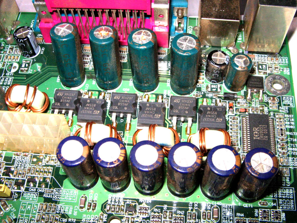

    I have epox 8RDA ... many badcaps ...major caps is GSC. few Teapo and Sulycon??.. i want try to recaps... coz my system restart frequently..
    anyone have sugestion for my recaps project..?

    I know 8RDA/8RDA+ PCB Ver1.x have using the following caps, because i have recapped so many 8RDA series.
    6 x 3300uF 6.3v D10mm
    4 x 2200uF 10v D10mm
    5 x 1500uF 6.3v D10mm
    9 x 1000uF 6.3v D8mm
    7 x 470uF 16v D8mm

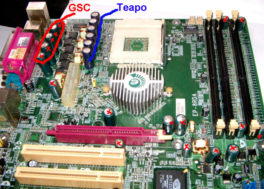

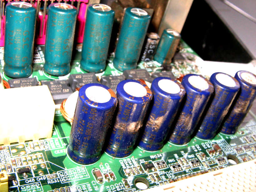

      the pictures is :... i need advise... what best caps replacement that i use for epox..? ..are TEAPO is good? on my board teapo not bugging... GSC is weak..thanks for advise.
      • gonzo0815
        • Feb 2006
        • 1600
        Re: Epox 8RDA Recaps
        Well, read the FAQ and you will probably find out, that we usually suggest one o fthe folowing brands and series:
        Panasonic FC, FM, FK, FJ
        Rubycon ZL, ZLG, MBZ, MZC
        Sanyo WG
        Nichicon (don`t know their series) but not the HM(N) series.
        Some members here have great succes with Samxon too, but as Samxon are not that wiedely known for a long time, there is no longtime experience with them.
        Dependent on the avaliability i would suggest some Panasonic FMs or FC`s for all caps. If you want to improove the board far beyond the specs as it was new (e.g. to archive an higher OC), use Panasonic FM for all inputcaps ( those 4 big GSC ones ) and Rubycon MCZ or Samxon GA for the outputcaps ( the Teapos near the coils).
        All the other caps you can use Panasonic FM.
        I would replace all caps, especially those TEAPOS too. They are crappy too, and can fail without any sign. So if you want to do a lasting rpair replace any bad caps =>470uF.
        If you want to make it perfect, replace any cap.

          Adding to what gonzo posted, Nichicon HD, HE, HZ series usually OK; avoid HM and HN series, as they had a defective batch a couple of years ago, and those parts are likely still in distribution or brokers. Also UCC/NCC KY, KZE, KZH series are good. With Rubycon, YXH and ZLH series are also good; per Rubycon's 2007 paper catalog (got one yesterday), they will stop taking orders for ZA and MBZ series in 9/08.

            I used Panasonic FC, FM, and Chemicon KY to do my 8RDA. Ran out of caps so I left the Sanyo ones by the CPU socket alone (you have something else there I'd replace though).

                      You can use those 6.3v caps without any problem. There is simply no voltage between 12v nd 5v in a usuall PC system. There are other reasons, why the vendor initially used 10v caps.

                        Thanks gonzo....i have been tried with no problem... my project successfull ! thanks ...
