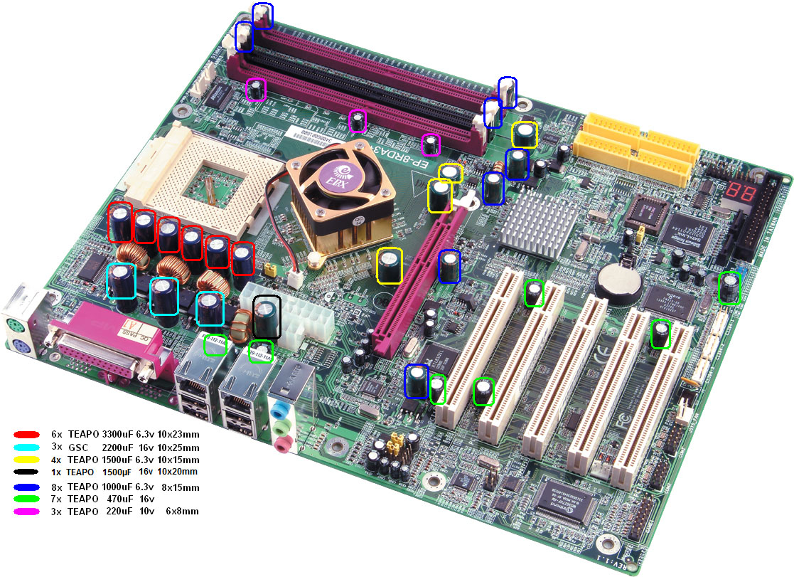

Hi to all out there,
as i experience some heavy fluctuations in the VDD line of my EP-8RDA3+ Rev.1.1, i searched the web and found it to be *bad caps*...
After reading that, i even had to look up what "cap" meant and finally found this site.
The boardmember "Sticky" had the same problem:
https://www.badcaps.net/forum/showthread.php?t=1027
Unfortunately, i cannot (yet) identify the bad caps by looking at them (no *bulged*, no electrolytic pouring out etc.)...
Hence i need to identify the capacitators responsible for the VDD supply line.
There are some nice pictures with capacitator values for the 8RDA3+ shown in:
https://www.badcaps.net/forum/showthread.php?t=1969
But the relevant caps are still to identify, as i don't want to replace all caps on the mainboard.
I'm going to try and replace the faulties (have soldered on normal electronics before) but i'm a bit scared on fiddling with a mainboard (size/compactness, frying the parts and thelike) although the FAQs in here made me much more confident.
Anyone to help me identify the correct caps out there?
TIA, Firefox
