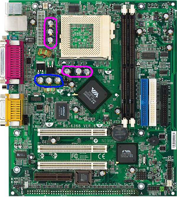

        Do you need a really high resolution picture, or will MSI's website overview picture of the board be adequate to tell?
          ok just any pic but mark the cap values on it

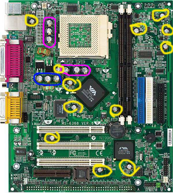

            Ok... in the picture the ones circled in pink are the only ones that look bad, and the only one's I am interested in replacing. They're all identical, as mentioned in my original post:
            Manufacturer: Chhsi
            Model?: WG (M)
            Temperature Range: -40C - +105C
            Voltage: 6.3v
            Capacitance: 2700uF
            The one's circled in blue are (I *think*, can't check for sure at the moment but my memory tells me...)
            Manufacturer: Chhsi
            Model?: WG (M)
            Voltage: 10v
            Capacitance: 3300uF
            Is that good enough info to go by?

              Re: Recapping MSI MS-6368
              yes that is great, i would be suprised if each set you circled was not connected in parallel.
              to replace only the pink would be a mistake, Chssi is an incredibly crap brand which i have had pleasure to deal with on several occasions on my systems. The blue must go also.
              it would be prudent to check also what the yellow i have circled are also. I prefer to do the best job and then enjoy the mobo without issue for the remainder of its useful life.
              considering the pink, if you wanted to have the same or excess capacitance you could have one cap of each three to be a larger value and then use the 2200s for the other two.
              there is even possiblilty to fill only 2 of the 3 spaces with larger caps and if they are indeed connected with parallel then it should work fine.
              anyway if you check this image
              you can see how to deal with using larger new caps. it is ok to lean the caps or even have them lying down. this board is still in use at an office today.
                The yellow one's look scary like the Chhsi ones going by the blue and silver stripe colour scheme.

                  anyway make your decision when you have time to check the comp. they are probably 1000uf and if they are from a crap brand i recommend to replace. Generally we recommend to replace anything 470uf and above (recommended) and 1000uf and above (definitely recommended) from the badcaps list.
                  Is there any kind of technical reason which makes it absolutely necessary to replace these
                  basically YMMV with the badcaps, they are inconsistent so you might have 1 or two caps going bad out of a selection but enough to cause problems. any cap 1000uf and above is a definite candidate for failure. Based on my experience even having the major caps being good brands like on some boards doesnt stop the 1000uf from going bad. your choice anyway, you might be lucky if you replace only the major caps.
                  Considering the quality of the original capacitors, do you think it's going to be ok for me to replace say, the 2700uF capacitors with high quality 2200uF capacitors and still be perfectly stable?
                  yes
                  So if I tried filling only 2 of the 3 spaces would it be good to have atleast 4050uF (4700uF probably closest?) per capacitor?
                  yes, as long as they are connected in parallel
                  I read somewhere that it's good for the leads to be as close to the board as possible for some reason
                  experience has shown you can get away with it. its best to minimise the lead length. there are other considerations also like the esr/ripple of the cap values you chose also. differs across the values of each series.

                            I took a quick look at the yellow circled ones today. They're all 1000uF 6.3v by the looks of things. I think I will order a bunch of 1000uF rubycon's and have a go at replacing those too, as advised.

                              looking at your photo. The pink circle devices are at the VRM output so I would use the 3300u 6.3V caps there. Being MCZ caps you will end up with a very low ESR.
