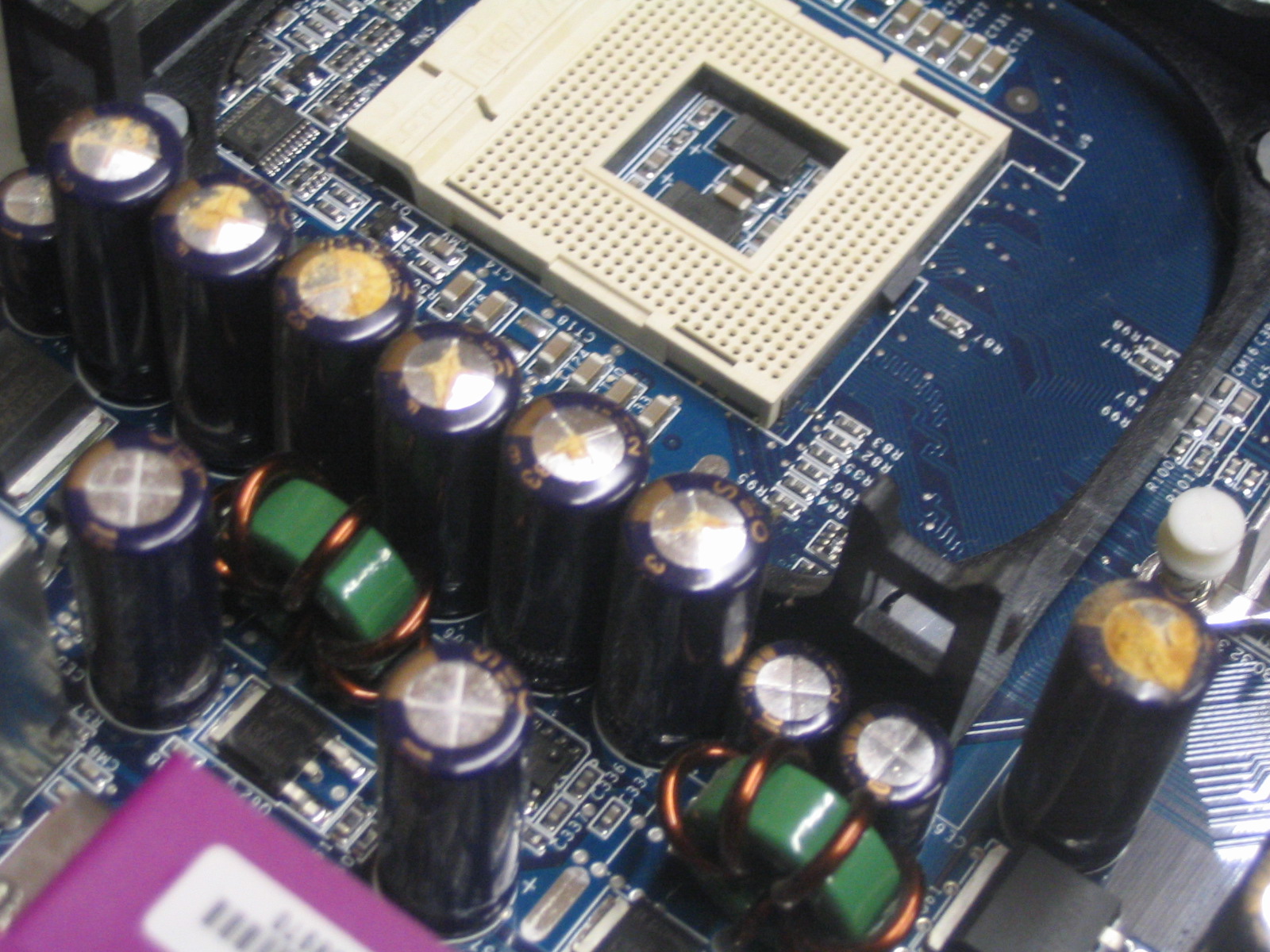

    This puppy had two strikes against it from the get-go IMO (see: First International Computer) and the kicker was the GSC caps. Symptoms were extremely slow boot & the occasional freeze. Manufacture date was April 2002. FIC didn't get the memo, and continues to be a bottom feeder as far as I'm concerned. Every capacitor on the board was a GSC. These caps were fed by a seven-dollar PowMax "400" watt PSU. I will offer the board to anyone who wants it for the price of shipping.

          I recommend you recap that board ASAP. In your picture 7 bad GSC caps are visible and it only takes a few caps to bring down a board. It may work fine now but will not later.
          If you don't want the board ship it to the guys on this forum that want it.

            Thanks, but that was the plan. I pulled the FIC, snapped a photo of the caps, and replaced it with a Tyan board. In a previous post I offered it to anyone who wanted to pay the shipping. Out of personal preference I refuse to spend very much time (e.g. recapping) on anything manufactured by FIC.

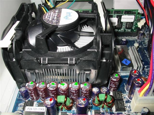

                      Interesting, I have the exact same board (mine is VIA brand and VIA boards were being produced by FIC) and the exact same caps were leaking. I replaced them with KMG capacitors and it is completely stable now. I know that KMG is not recommended since they are not ESR, but I did not want to spend more than the board worth while fixing it. Apparently KMG is not ESR but still better than those junk capacitors, board is working completely stable since several months under constant load 24/7.

                        i missed your post, so if you pass by again we are glad you liked our info.
                        GREAT you got your board working perfectly again!
                        KMG are not so bad i guess, digikey cross references them to panasonic NHG which is an ESR cap at the lower end.
