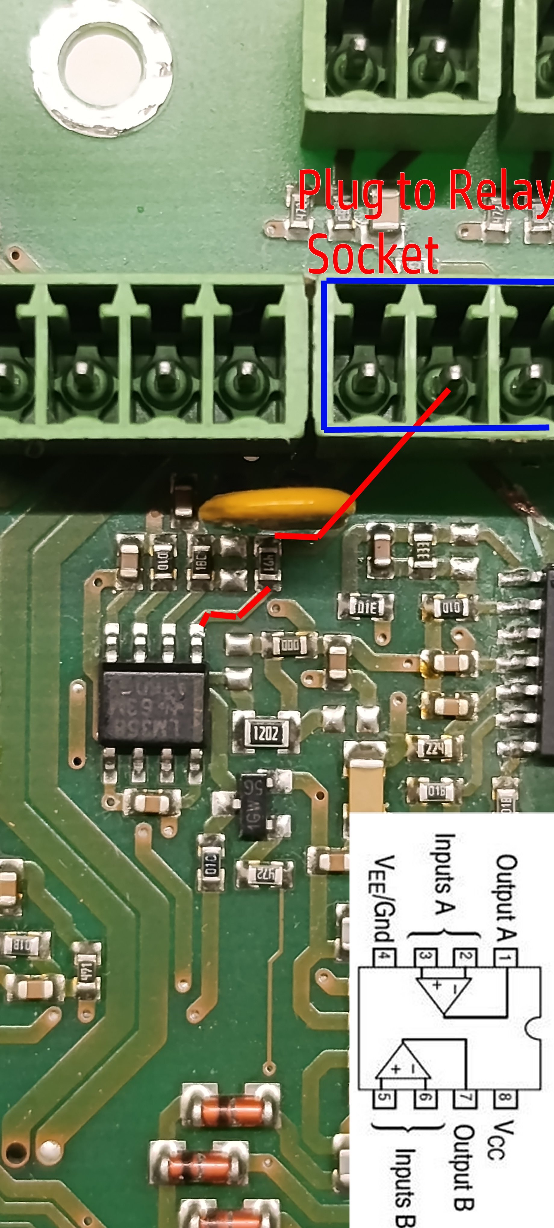

    Hi all!

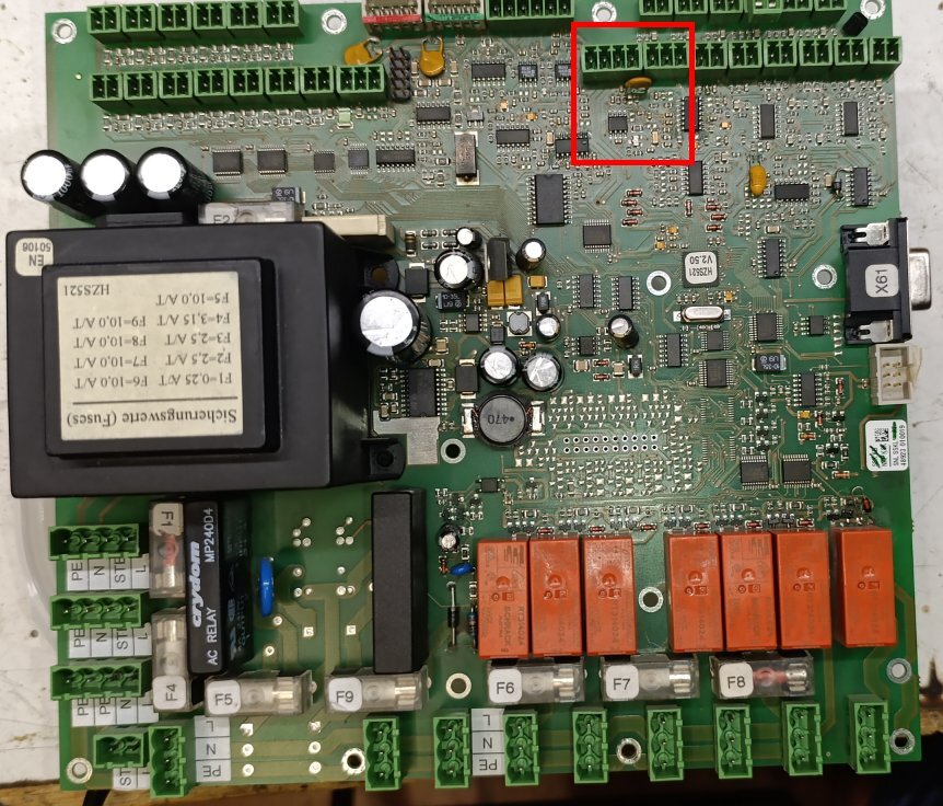

    A friend asked me to repair his biomass (pellet) heater. This heater has a pellet feeder powered by a relay that's not switching anymore
    I measured the voltage at the relay coil socket while entering the individual tests procedures and it has 6-7v while the relay is NOT on the socket, and drops to 0v when the relay is plugged in the socket, like the source is providing nearly 0 mA. I measured the relay coil and it is correct and not shorted so the issue is in the board, fed no amps to this output
    I checked the board at home and this output is driven by an dual OpAmp LM358 (see pictures). This IC uses pin 1 to output to the relay socket and pins 2&3 for inputs. I checked voltage supply to this IC and Pin 4 (V-) has -12.6v and Pin 8 (V+) has +14.8V. Not balanced but I guess this is normal (?).
    As the owner has only partial interest in the board to be repaired (pellets price has gone x3 in the last years in Spain) I don't think a quick repair can be done here.
    • Option 1: Replace IC LM358, a little out of my scope as I don't have much practice with SMD IC's and my poor sight won't help...
    • Option 2: Weird solution, as this output still has some "power", providing 6-7v while no load, would you apply something here (maybe a darlington Q) to increase the power to feed the relay and have a "patch solution" for a while?
    Or can you suggest another way to solve it with my limited skills?

    Measure the voltage on each side of the 470 ohm resistor.
    • lotas
      • Jan 2016
      • 4598
      • Russia
      Something strange connection, for the operational amplifier LM358 to directly control the relay coil, there must be at least a "key" transistor or something like ULN2003 (DARLINGTON ARRAYS)

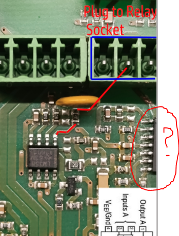

                        Here, maybe, on these contacts, as you say, not only the output through the resistor lm358 is suitable. What is the marking of this chip?

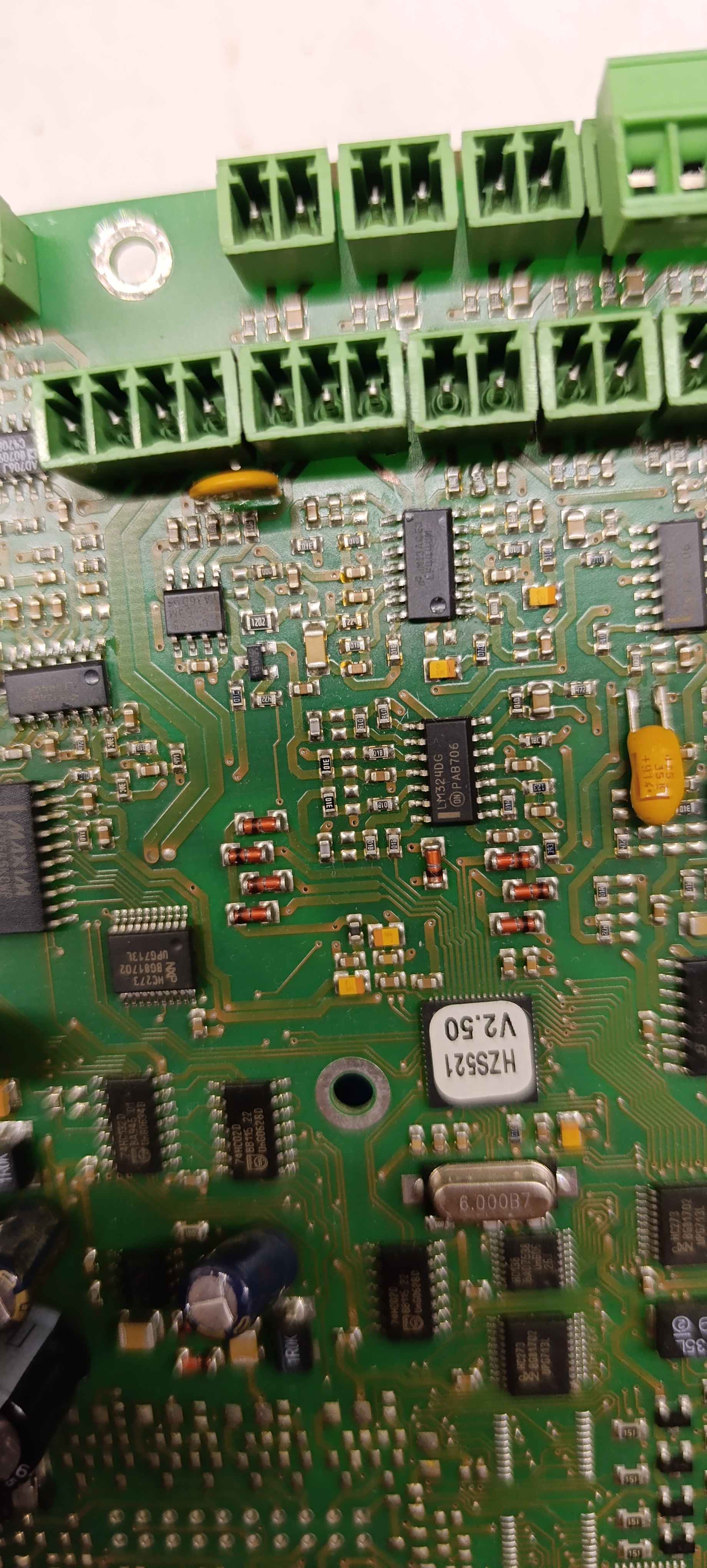

                        That IC is an LF444 (Quad OpAmp), I already checked it before, it has some inputs connected to some other headers (I guess sensors) at the board, it seems like one track is connected to the same header (see scratched varnish) but I removed the header and this track goes across to another header on top if it. I checked and there's no electrical connection at all between this LF444 and the pellet feeder output header

                          It is clear from it that it has already been soldered or replaced (not factory soldered).
                          Maybe there is some kind of opto relay there (a 470 Ohm resistor limits the LED current), and not a regular one with a coil.

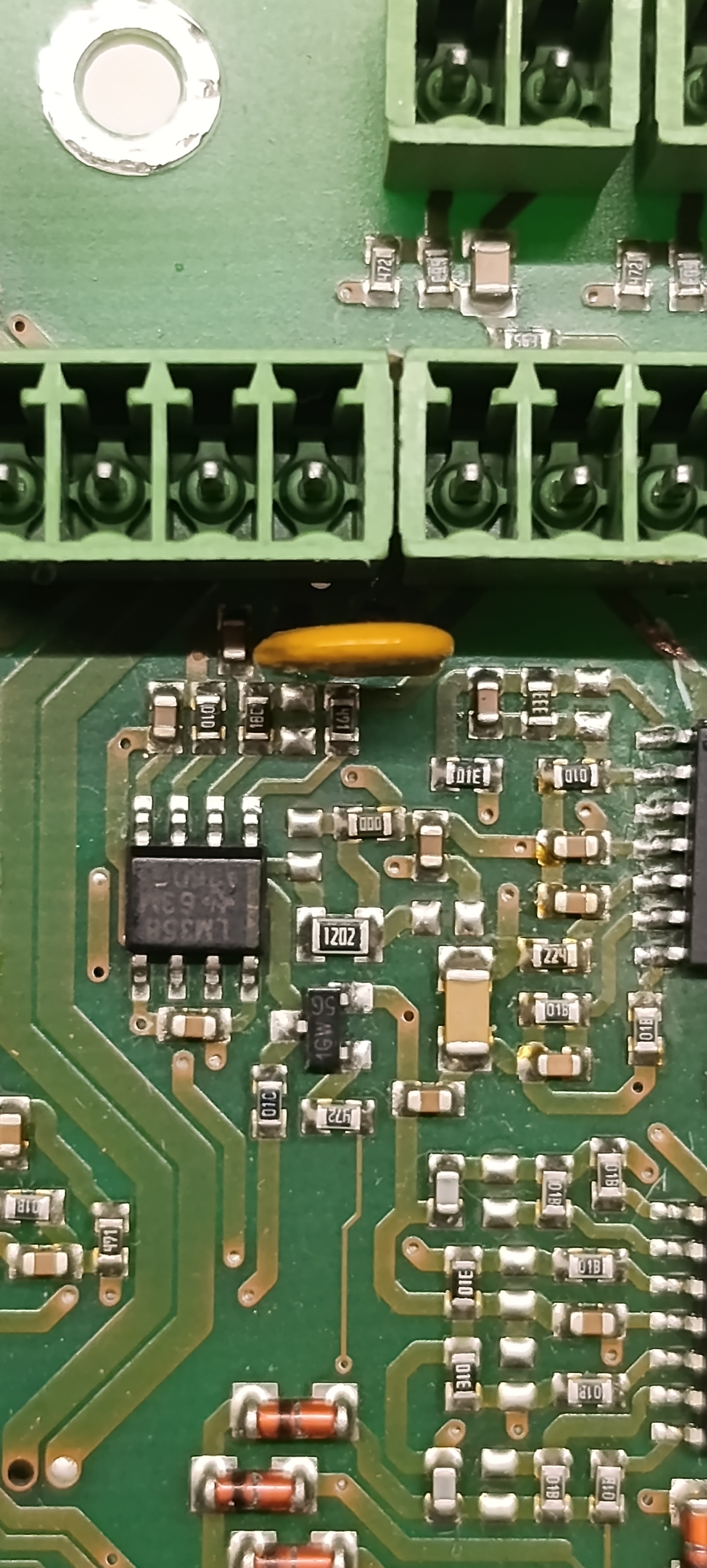

                            I think what you are seeing is the remain of flux from when I desoldered the header that drives the relay for the pellet feeder, right on top of the LF444, but I didn't touch that IC at all, and I am the only one who has touched this board. No, I don't think this IC has anything to do with this function, which seems to solely relay on the LM358, the LF444 is used for INPUTS, as it is wired to other headers for detectors.

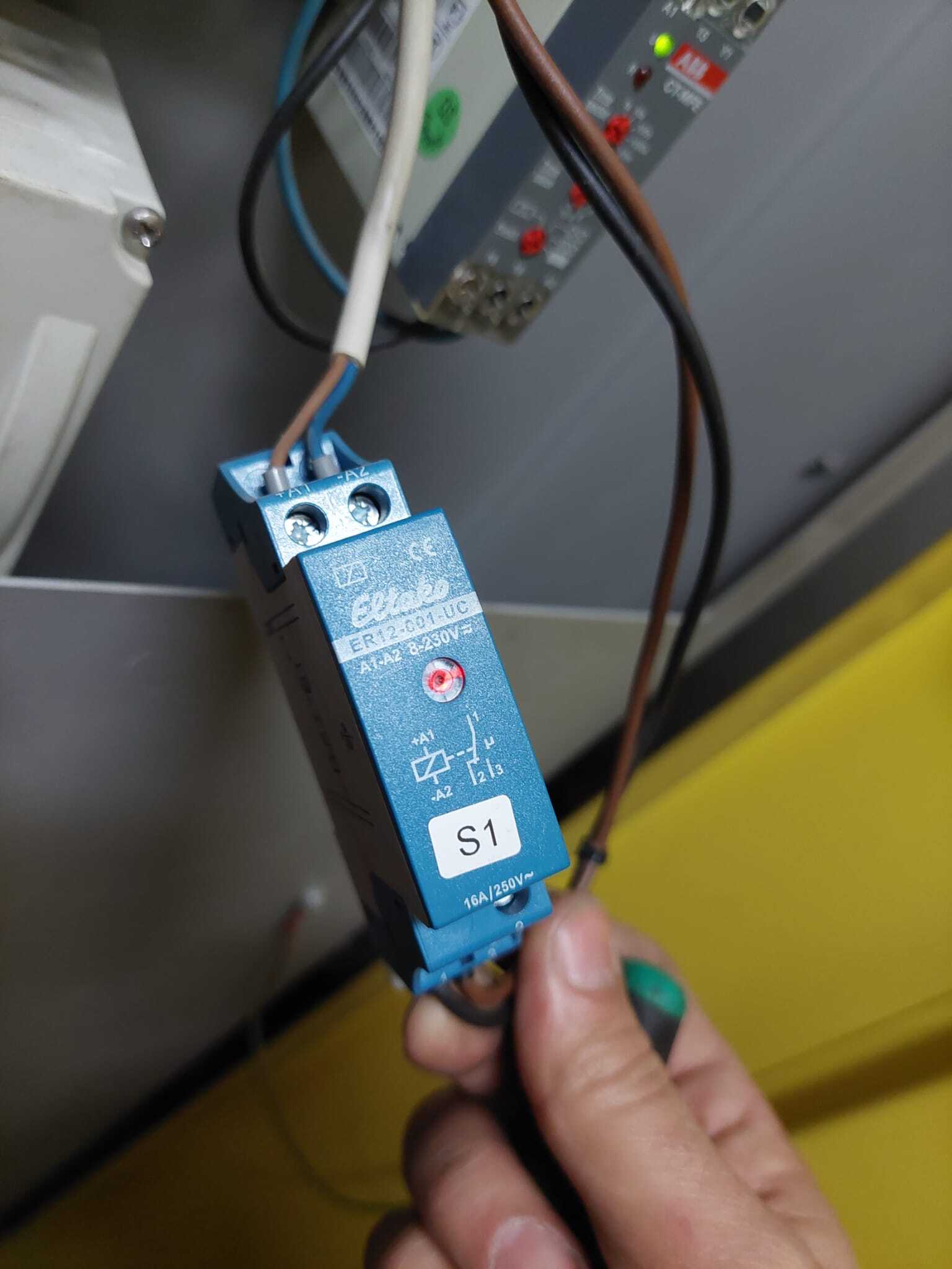

                            • edugimeno
                              • May 2017
                              • 581
                              • Spain

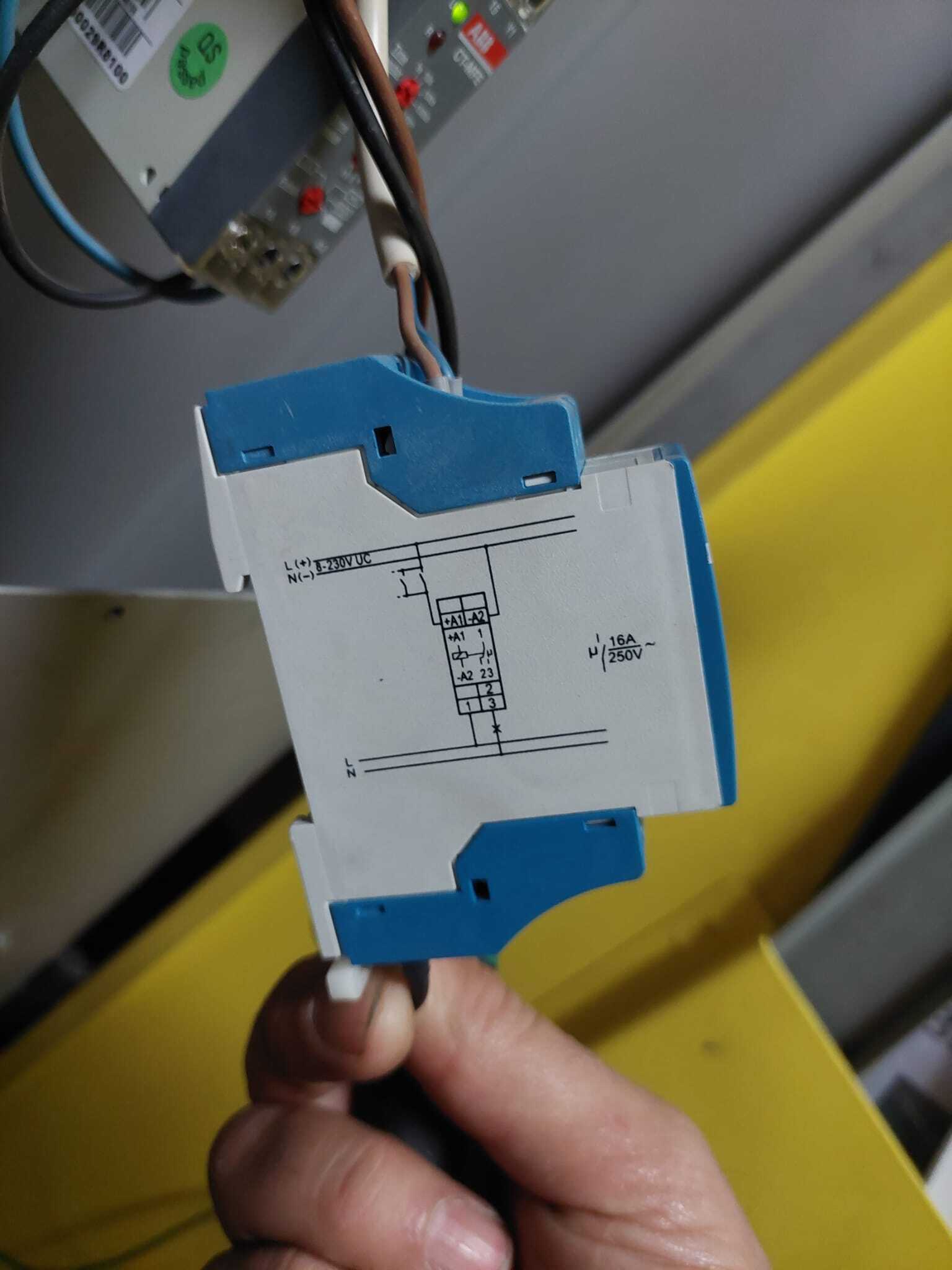

                              Ok, we got a reply from the electrician, this is the relay he removed, it looks like he swapped the socket as well...
                              Eltako ER12-001-UC
                              So GPT states that this is NOT a SOlid State relay but it is electronically triggered (darlington inside?) so it takes really low power and also it says it works by pulses (toggle??) so it won't take current while ON...does it make sense?
                              • truclacicr
                                • Apr 2019
                                • 316
                                • australia
                                https://www.eltako.com/fileadmin/dow...nternet_gb.pdf
                                State-of-the-art hybrid technology combines advantages of nonwearing electronic control with high capacity of special relays.
                                Universal control voltage 12 to 230 V UC.
                                Low switching noise. Contact position indicator with LED.
                                Integrated free-wheeling anti-surge diode (A1 = +, A2 = -).
                                By using a bistable relay coil power loss and heating is avoided even in the on mode.

                                • edugimeno
                                  • May 2017
                                  • 581
                                  • Spain
                                  Thanks. The owner is going to find another relay, same part number this time, and see what happens
                                  Will keep you all posted. Thanks
