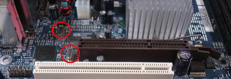

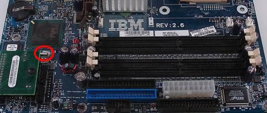

                      After some digging, I find that the 4 beeps on an AMI Bios are "Timer Fault".
                      Is the timer a physical piece of equipment that I can remove and replace from the board?

                          The timer is a crystal and the related circuit.
                          If this board was recapped a bad choice in substitution [or a bad joint] could louse it up.
                          So could a random splat of solder.
                          As per a note I found, 4 beeps on an AMI also includes the 2 beep problems as a possibility. The 2 beep problem is a problem with RAM 'somewhere'. It might be video RAM or it might be system RAM.
                          This follows as the timer syncs the RAM with the CPU through the chipset.
                          If the RAM is not at the right speed it could be the RAM -or- the timer -or- the BIOS doesn't recognize the SPD data on the RAM modules.
                          Probably the tube shaped crystal in photo that shows RAM slots but that's a guess.
                          Your RAM may be good but not good in -this- board.

                            I will try removing the two crystals circled from the board I damaged and try them on this board.
                            The beeping board has not been recapped. I don't see any solder anomalies.
