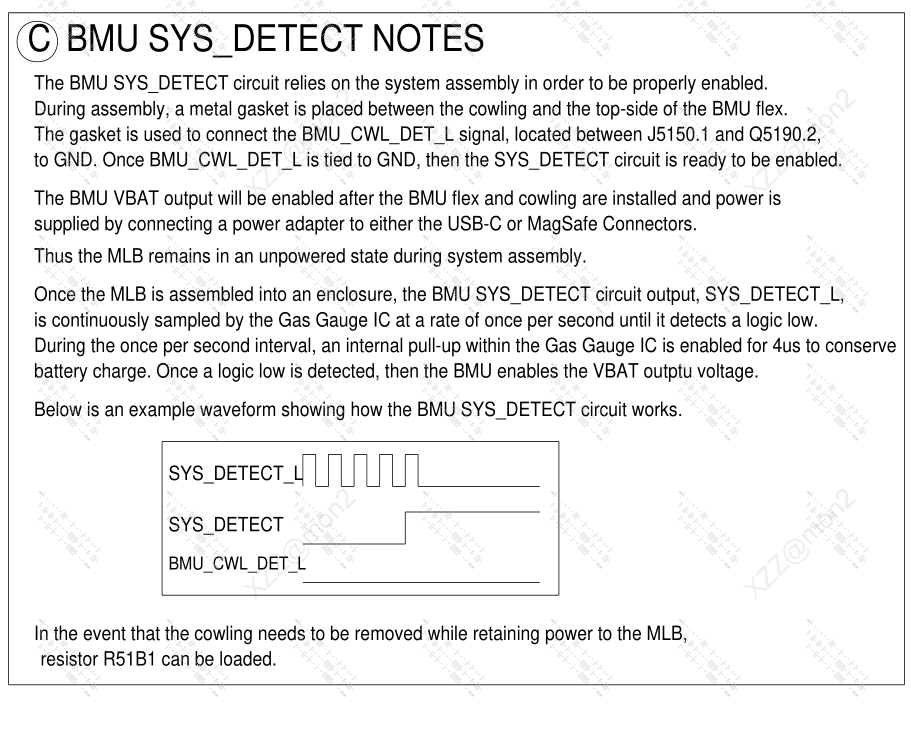

                Also, yes, you are chasing a different rabbit hole now. Earlier, the fault may be the same as what a number of techs have faced about a week ago. After replacing the LCD display, this laptop was unable to charge the battery across 3 units. LCD assemblies from different vendors (XJS & Seven Puppy).
                Do you recall if the laptop was able to power up with only the battery? That puzzle is still being solved. Master Liu noted that he swaps out only the defective LCD with an original LCD from the same model - does not swap out the whole display assembly. That solution works.
                Has this laptop had the LCD assembly replaced?
                Review the notes in the schematic on page 24 as follows:

                    Previously, the client came in with liquid damage, I found a lot of shorts on the battery area that needed to be replaced, now those shorts are gone, the screen did turn on before hand and the screen has never been replaced since this is the first time its being worked on. LCD has never been removed or changed so it is the original LCD.
                    The laptop would only power on with power connected, battery would display charging at 1% but never increasing and instantly dying when unplugging power, now the board doesn't turn on anymore. Complicated board I tell you!

                      It may be too high. Can you short your meter probes? What is the baseline for your meter for '0 ohms'? This measurement should be 1+1 = 2 ohms.
                      I do recall the ohms dropping on that line. It did go below 3.0 ohms and steadily dropping across both points. Let me check again
