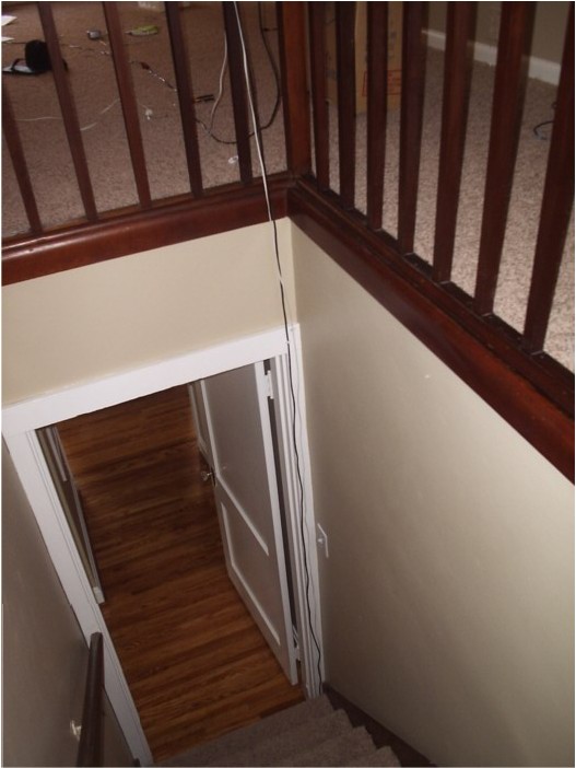

                            some pics of my work:

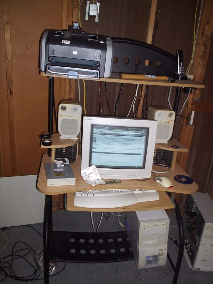

                            first, i ran a LAN line and a phone line from the basement to the attic, as the modew that gives us phone service and internet access is up there (strongest cable signal). pics of how it was run:

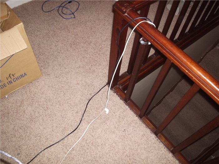

                            my desk will be against the handrail once all is moved in. the computer desk there now (my dad's) is on the other side of room, the phone cord and lan cord are extended using inline couplers and extra cables- the phone cord had two jacks on the end, so i just took another 4 wire cord and ran it to the modem.

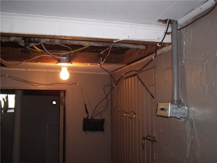

                            how it is actualy ran:
                            i only had to drill one hole using this method. however, there was a second layer to go through in the basement (celing), but it already had a hole 10" away.
                            anyway, the new phone line (white), the new LAN line to the attic (black), the server LAN line (off-white), and the existing LAN line (blue):

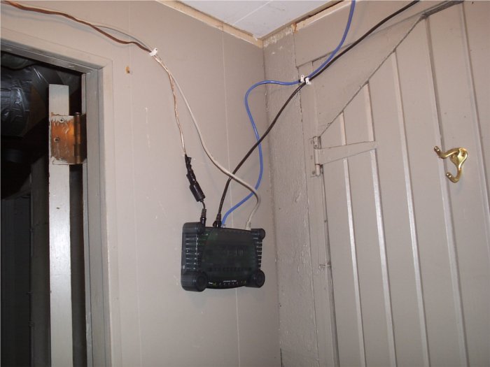

                            a close up of the hub:

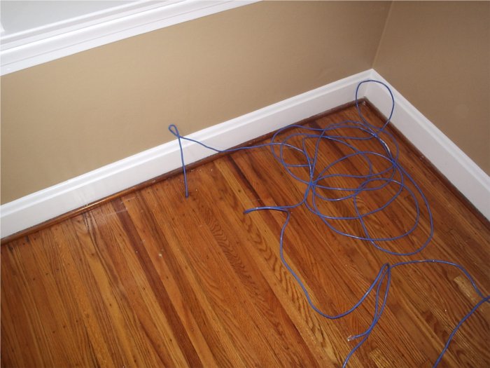

                            the other end of the existing LAN line (goes to the computer room, as you will see, they used PLENTY of cable, which might be nice)
                            what is on the other end of the server LAN line i ran a few weeks ago (on the other side of the wall):

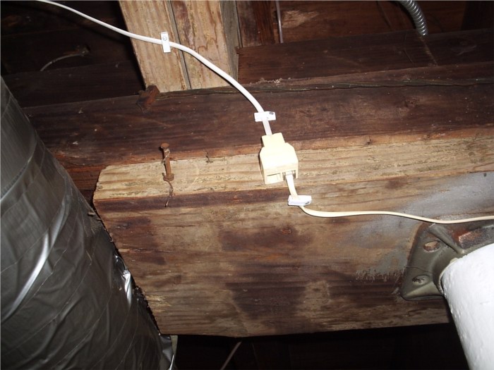

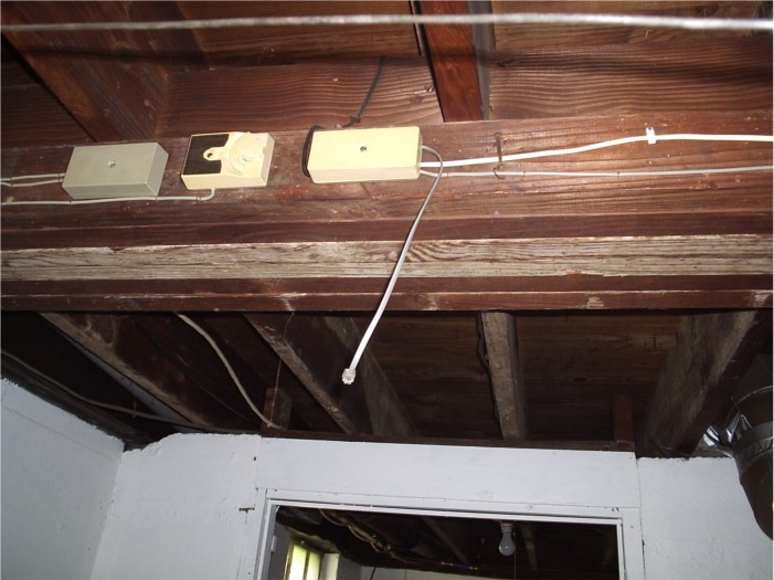

                            i also had to add a new phone cord out of the main phone splice to connect o the new line to the attic (beige):
                            and i made a makeshift phone jack where the two cords meet:

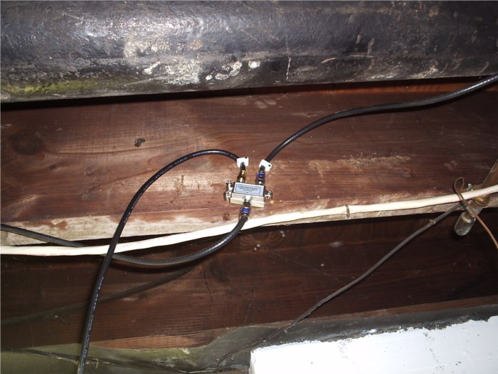

                            i also added a cable splitter (1000mhz) for where another line will be ran. it will either go to my parent's bedroom or the fitness room in the basement, depending on where our other tv will fit. for now, the splitter is mounted and the line is in, but nothing else yet:

                              i finished it off today- adding more cable clips to make it look nicer and kep the wire where it should be. I also added a clip, restraining the line in the computer room so the wire doesn't fall though, onto my rat cages below..

                                looks a bit ghetto but it will work and probably cheap

                                  what is ghetto? it's better than it was... the pre-existing line was flopping all over. now, the runs are properly restrained.
                                  you could be right, but i was not in the mood to rip out a bunch of old plaster and lath and crap to run a few wires. if tv lines are done that way in old retro-fits, then i thought the one line is fine once tied down right and the other two are good. the server kine and the attic line are good, i'm posting from the server now. i tested the old line briefly with my netbook, the room has no grounded outlets and it will not be retrofitted for a few weeks.
                                  if you want ghetto, you should see how the icemaker and gas dryer pipes are secured, tho nails on each side of the pipe, or a wire romex u-nail. the icemaker line is unused (my fridge is form the 80's), the gas line has the nail heads dug in and making little dents and scrape marks in the line, we are having it replaced soon as well... it's useless anyway, nobody ever put an outlet by the dryer hook up anyway, all there is is the gas pipe and a 240v electric dryer hookup, no 120... morons!

                                        it may be worth pointing out that fone cable should be kept a minimum of 3 inches from mains cables to avoid 50/60Hz induced hum on the fone line.
                                        that's official in both u.k. & french telephone co wiring reg's
                                        also, i'd keep UTP distanced from it because the fone rings at 90v and that could link through inductance into your network and cause packetloss.
