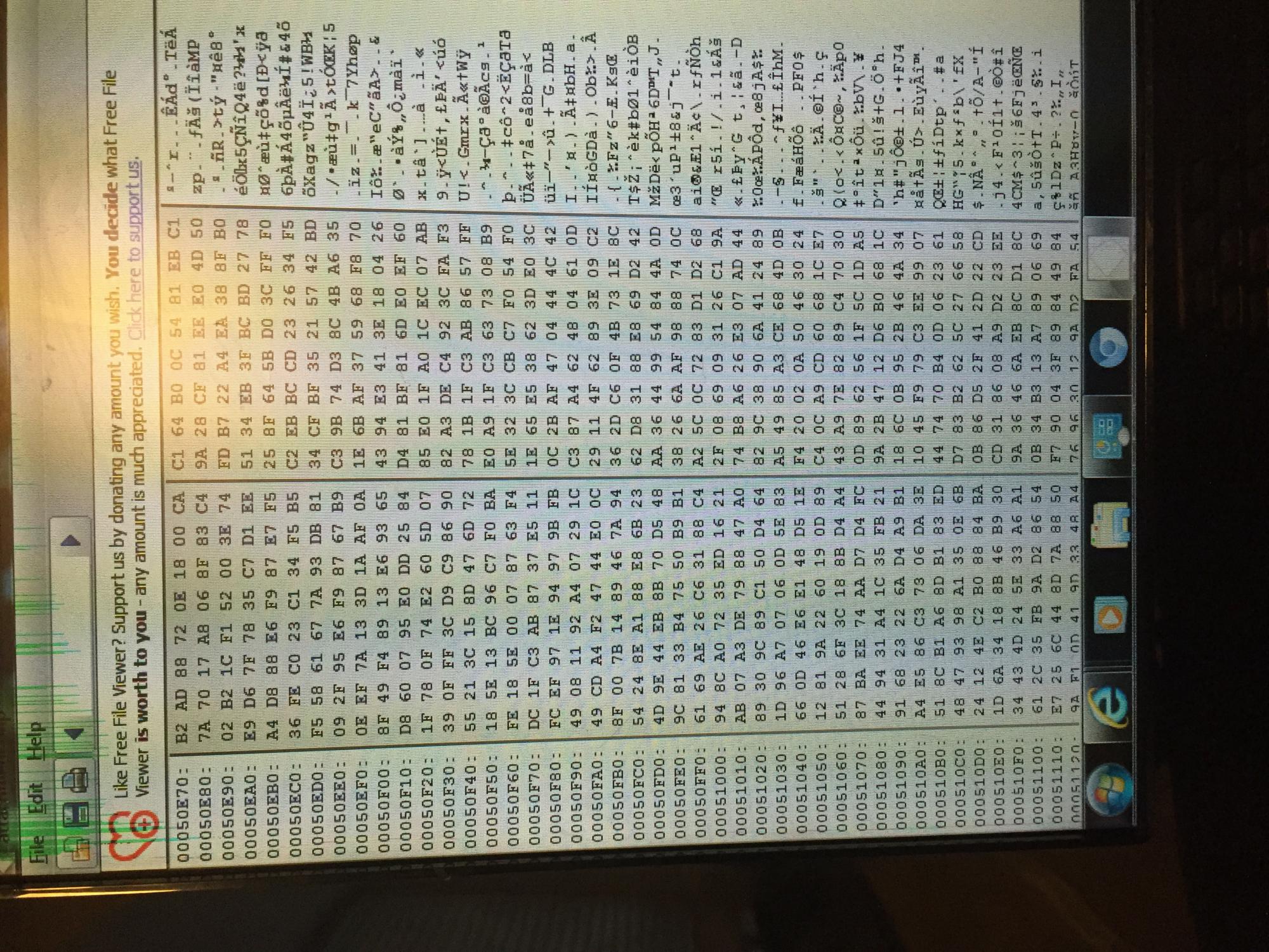

                            I unzipped the file file it was a php file i was able to view it but how to i install that program
                            • ricosavy
                              • Jul 2012
                              • 457
                              • united states
                              Re: How to check configuration on a modem
                              This all i get
                              • ricosavy
                                • Jul 2012
                                • 457
                                • united states
                                Pic
                                • ricosavy
                                  • Jul 2012
                                  • 457
                                  • united states
                                  I downloaded the terminal that was linked but when I open it all it brings up is a bunch of code. Is there a specific way I am supposed to open it up?
                                  • SteveNielsen
                                    Retired Tech
                                    • Jun 2012
                                    • 2327
                                    It is a windows/dos executable file. You must Run it not View it.
