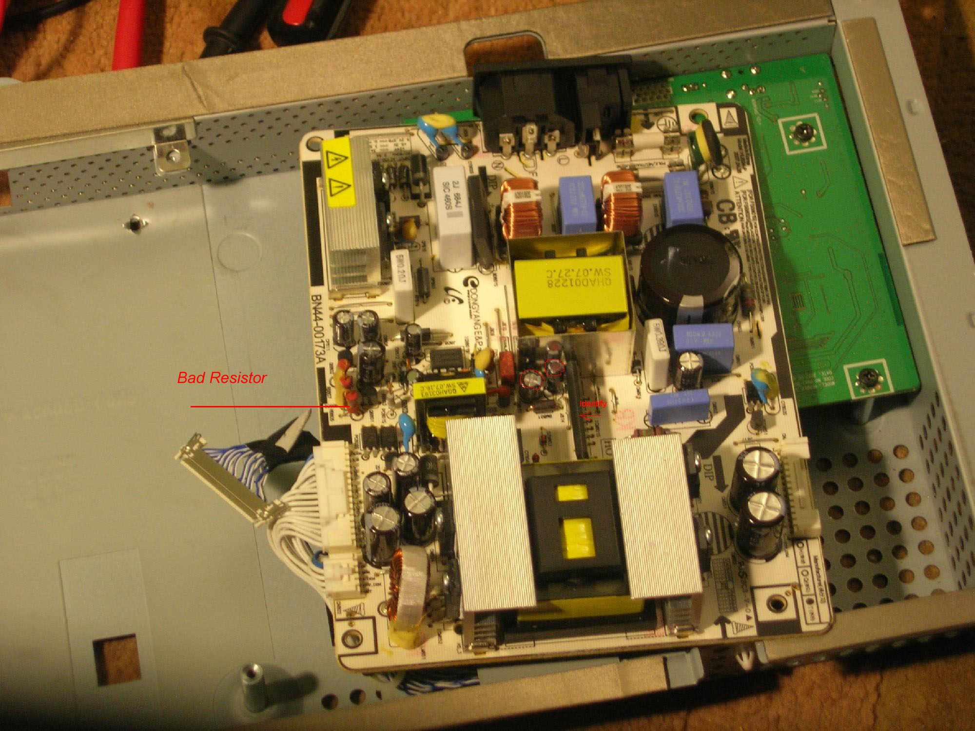

            New here! I found this topic via Google and boy am I happy I found you! I had the same symptom as a few of you here... blue light, but no screen. After reading through this whole thread I was about to replace all capacitors and resisters using a kit for the 245BW which can be found on Amazon. A few said that the culprit was one bad resister, so I started with that. BOOM! My monitor works!!!!! Thanks so much!

              Here is the pic of the culprit!

                Well done G Sup - you may want to consider why the resistor went bad - was it because of the caps not functioning correctly?. To extend the life of your monitor you should
                think about changing the caps anyway.

                  Great point! I will later on for sure since I have all of them. I really need to buy a better solder though. My wife uses the monitor and she doesn't use it as frequently as I use my computer, so I'll do it in the near future.

                    Samsung, model# 245BW (LCD Monitor)--
                    Symptom: no backlight, no grid; and there is no significant bias voltage going to the inverter board.
                    Cure: RB805 (68 ohms; open) located on power module.

                      I believe that was the resistor I was explaining?
