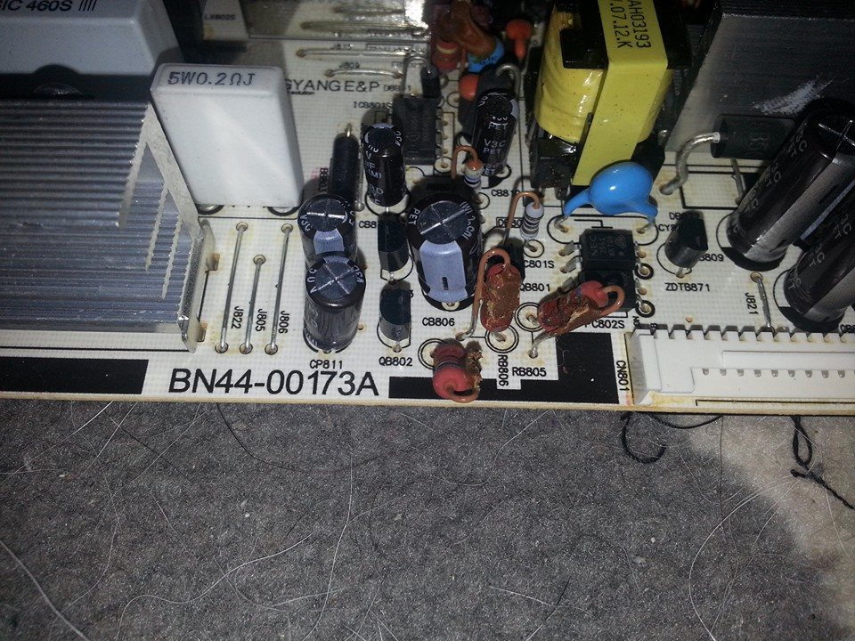

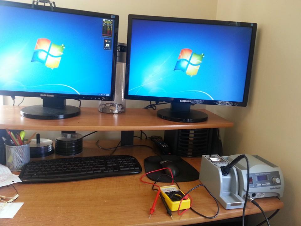

                Just wanted to drop a quick thanks. I have 2 245bw's and 2 weeks ago one went out. Rather than trying to use my cheapo 30 watt ratshack iron, I waited and ordered a ratsjack temp controlled station. It did a much better job. I lifted the 2 pads which run the 3 resistors in parallel. Luckily the important pads didn't get damaged. I was able to solder bridge the 2 center pins joining the resistors and all went well. I replaced them with much larger 3 watt resistors. At .69 cents USD each it was worth waiting on them.

                  Forgot to post pics LOL. Sorry here they are

                    It also appears this forum doesn't allow you to add / edit your reply.... Sorry for the multiple posts in a row. I did notice that the monitor I replaced the blown resistor in runs a bit warmer on the back for some strange reason. I may add a couple 12V fans to both screens later.
                    One more thing to note. On the first photo I posted showing the original resistors, none looked visibly blown. I had to take out my multimeter ( yes analog..... dont ask... I just prefer them LOL ). The brown stuff in the photo is just the factory glue which I had to separate. Definitely check rb805 806 and 807 manually. I replaced all 3 and as others have posted... there's TONS of free room to add higher watt resistors.
                    Thanks again everyone and good luck to you all =)
                      #670
                      Re: Samsung Syncmaster 245BW
                      Good job, just make sure to remove ALL the glue, otherwise the wires and leads of the component will be damaged, the glue is also conductive which will cause shorted circuits.
                      BTW, those 68 Ohms resistors are connected in series.
                          As far as the glue goes, I replaced all 3 resistors No more glue. I meant to say series vs parallel. My apologies there and thanks for catching it for me. Running the multimeter across all 3 shows more resistance vs less resistance which running in parallel would so. I posted the first post on my cell and I didn't read before hitting submit lol.
