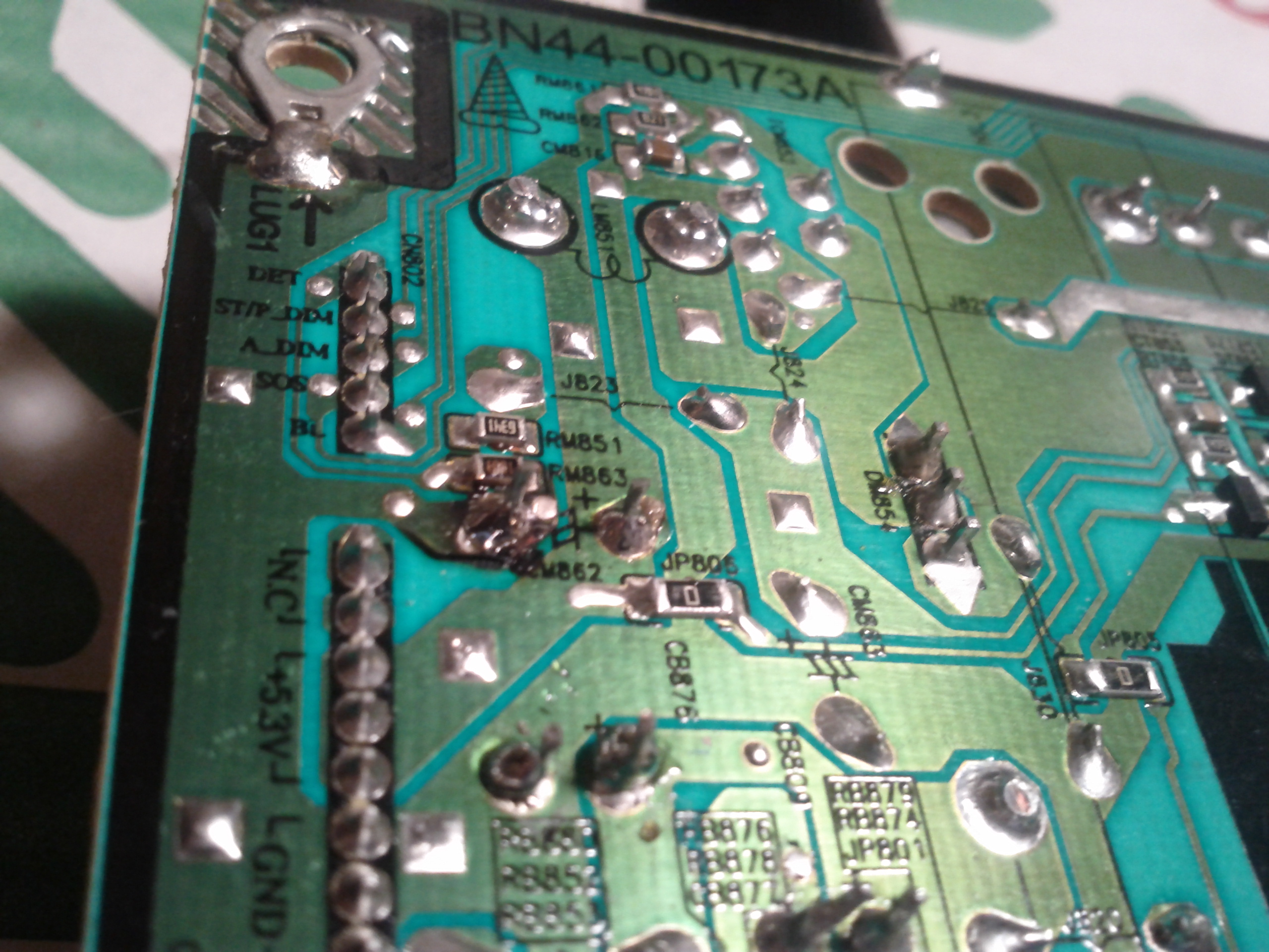

            That said, I got one of my two 245bw's working! I believe it was the resistors that made the difference. Tested before resistors were replaced, with no luck. Tested post-replacement, voila! (note the somewhat shady mcguyvering after I accidentally burned and ripped out the circuitry on the board)
            Should I bother buying a new board for my second monitor? Just found one on ebay, but I worry that the caps may be of subpar quality and I may need to replace them soon anyway.
            I burned out a part of the circuit board on my other PSU board (see 3rd pic) and I'm not sure that it's worth making the investment in replacing the caps/resistors. Thoughts?
            Thanks!

              You should also remove those glue on the component, they are conductive and also corrosive.
