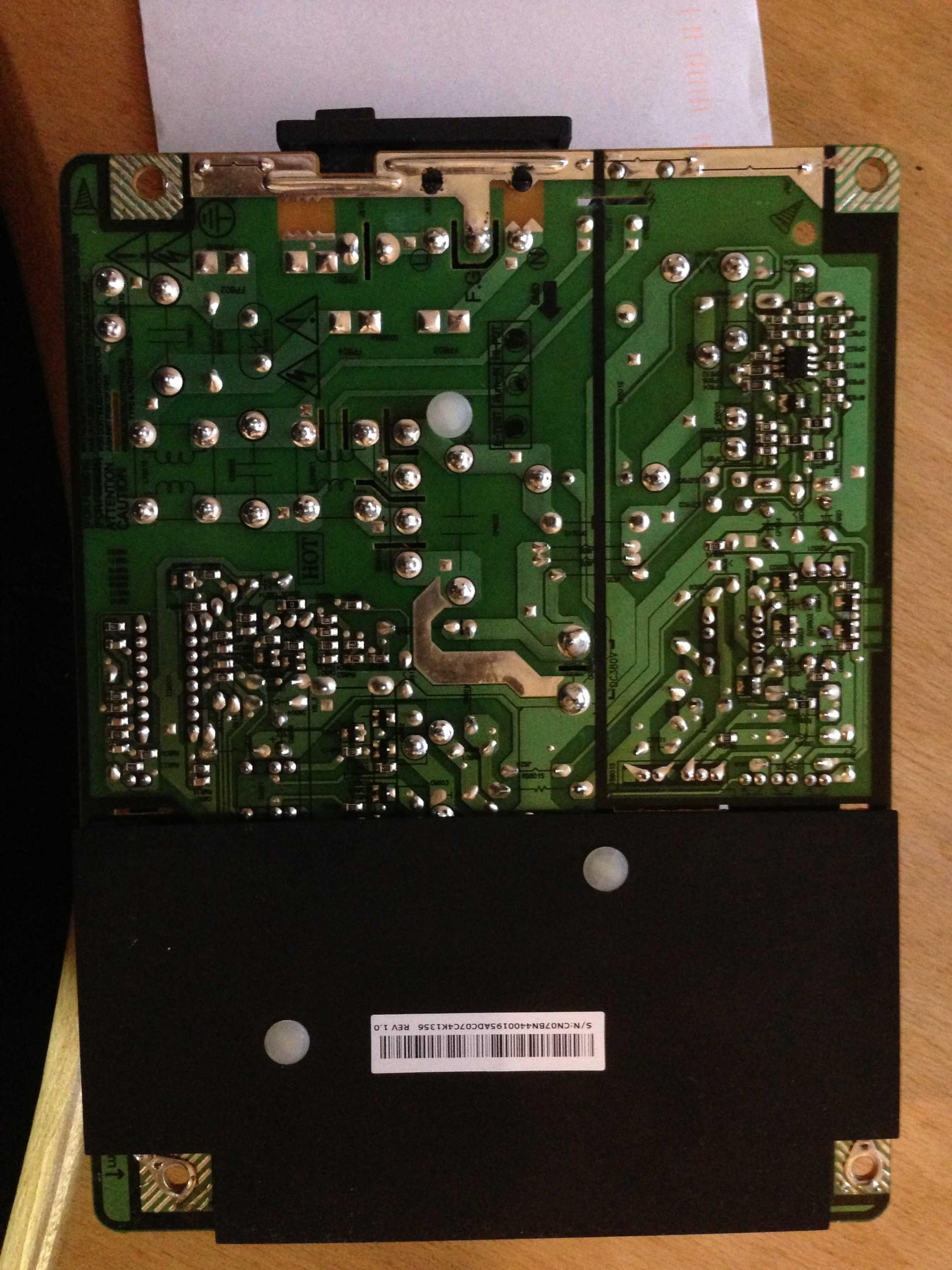

              • Doloras
                • Feb 2013
                • 4
                #587
                Re: Samsung Syncmaster 245BW
                for the beginning i must say „thank you“ . One of my two Samsung Syncmaster 245 B is now working.
                My first Monitor is a 245B with the three bad resistor. I changed and now it works.
                My second Monitor is a 245B Plus. I bought three resistors, but when I opened it, i don´t find the three bad resistors. It´s a little bit a different typ.
                My problem is now, i don´t know which resistor i can change to solve the problem.
                I bought for this a capacitor-Kit and replaced all caps.
                I made same picture.
                I hope anyone had an idea what I can do.
                Thank you.
                • tibimakai
                  • Jan 2012
                  • 3680
                  #588
                  I have fixed one of these, by just removing the glue. It was arching between a little blue capacitor and transformer.
                    #589
                    You need to remove ALL the glue first, hopefuly the arcing did not damage the component, I can see blackened glue due to arcing on the cap in the picture.
                    • Doloras
                      • Feb 2013
                      • 4
                      #590
                      I do my best in removing the glue. But it still not working.

                            • Doloras
                              • Feb 2013
                              • 4
                              #594
                              I read now a lot of threads about this board. I dont find a solution, i´m now very perplexed.
                              i read many of the RB801, RM801 or CM... and many more.
                              I´m not very the best in electronic and i dont what to do now.
                              I cleaned the board and watched the PDF from budm.
                              Can i solve the problem if i replace all the resistance?

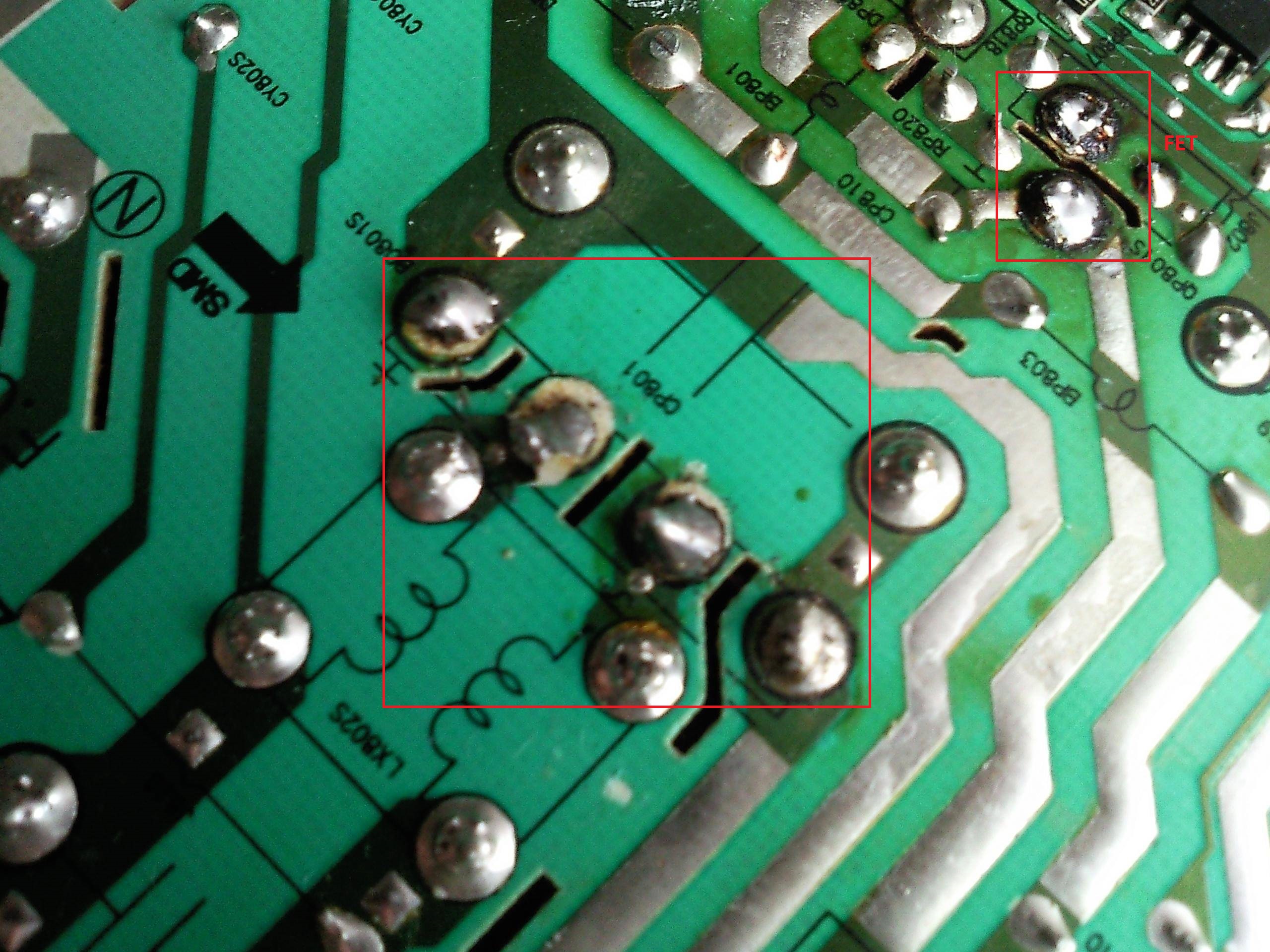

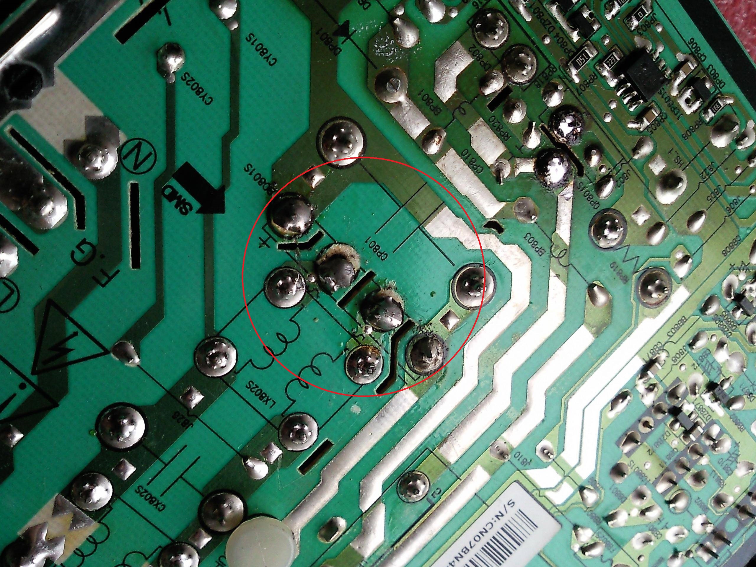

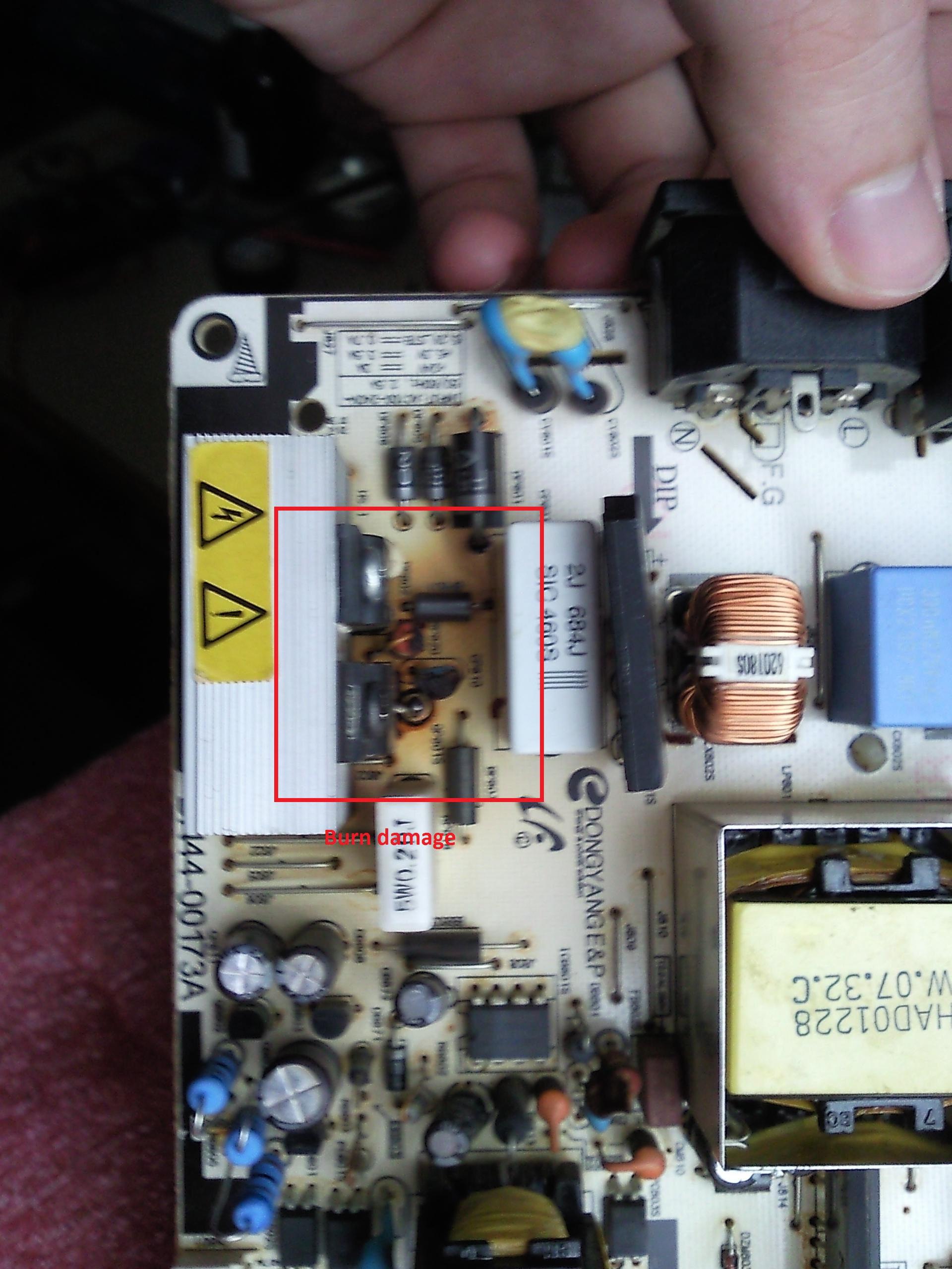

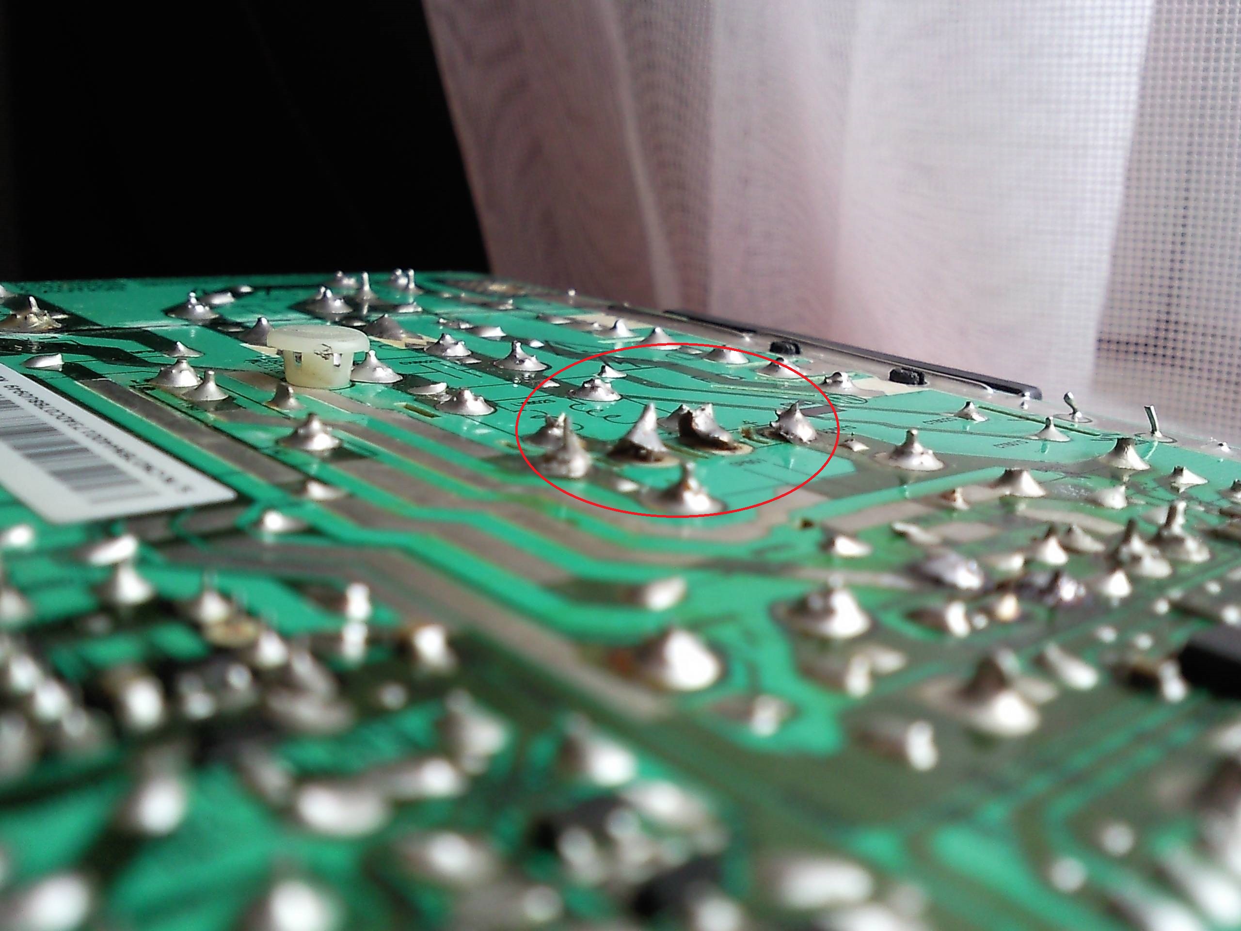

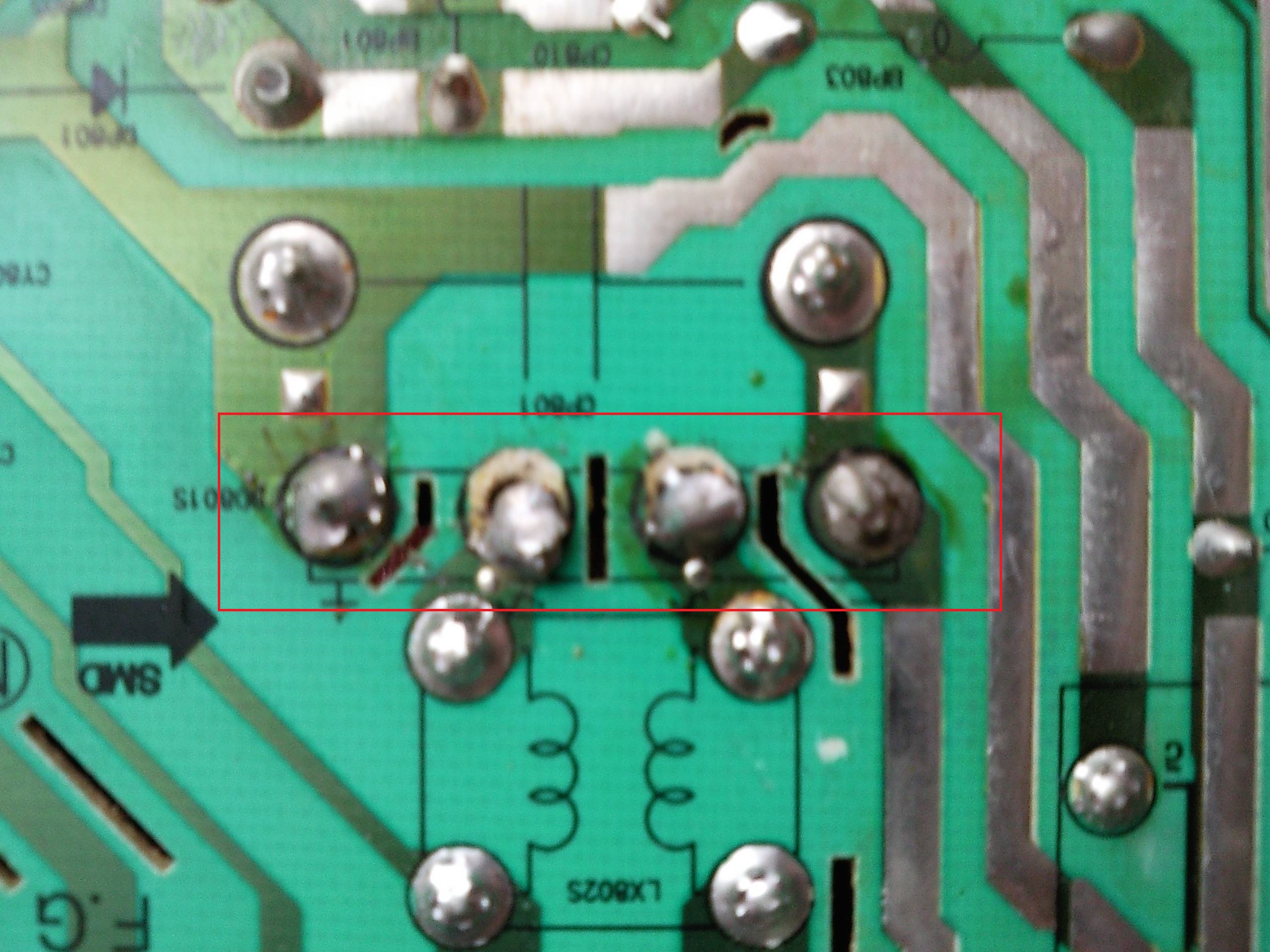

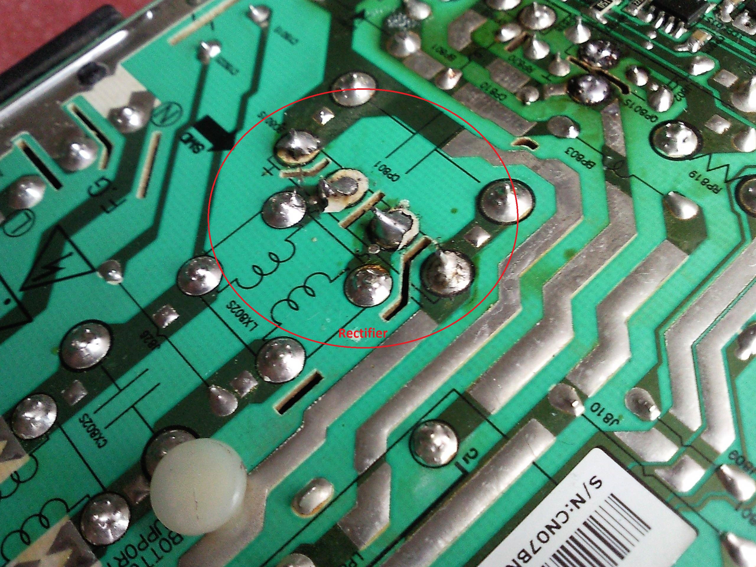

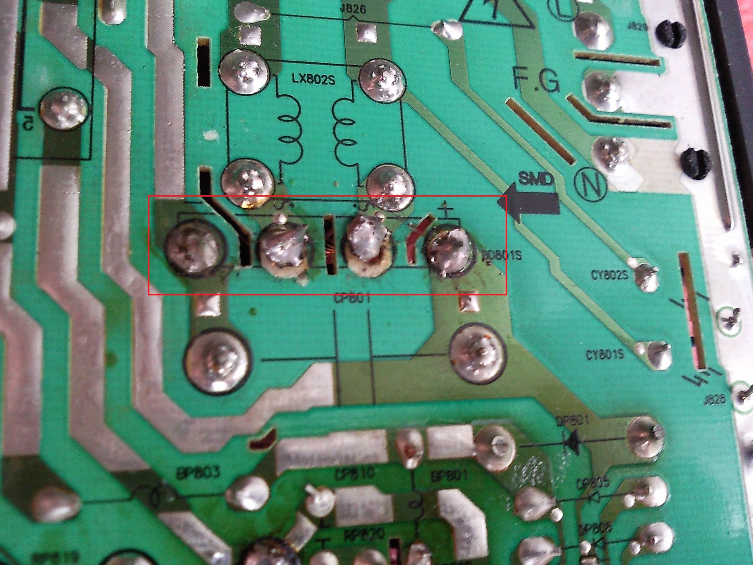

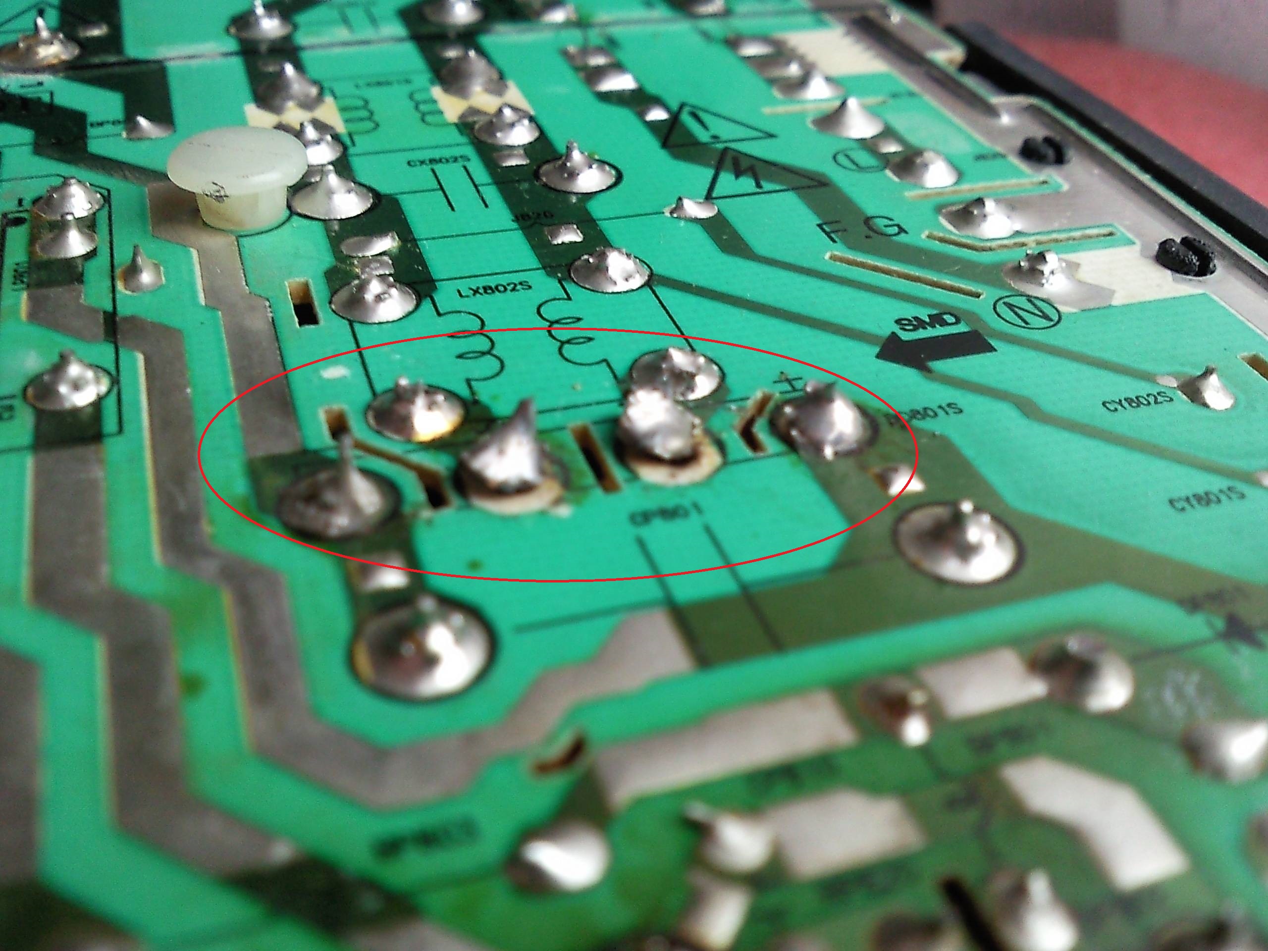

                                    #597
                                    Hi there!
                                    I also got a bad Syncmaster 245B.
                                    It had the most common problem: the 3 resistor. I've changed them and now it is working perfectly, but i have a little problem with it: it is buzzing like a bee.
                                    I have recorded its sound with my phone, its quite good quality and you can hear the buzzing actually (sometimes i hit the case with my phone accidently thats why you can hear knock-knock a few times).
                                    You can check it CLICK HERE.
                                    Its not that loud it would disturb me, but if i lean at the back of the monitor, its quite loud and makes me nervous. The power supply board has many clues of burn damage, but the amazing thing is that it is still working... I can see burned solder joints around the two fets and some other components, nearly on the entire board. But its still working!
                                    Now im explaining an another serious damage, I ask for your forgiveness because of my lack of english/engineering skills:
                                    the Bridge rectifier visual problem is the following:
                                    If i am flipping the board and taking a look at the PS panel's back, I can clearly see that the solder joints are loosed, it has solder on it but looks like the joint has been tore off from the PCB, lifted about 1mm high from there, but it is still connecting to the circuit. Looks really horrifying, too bad i did not take any picture of that before the assembly. If you find this important and my description is not enough then i will take apart again and take more pics.
                                    Here are some of the pictures that i took from my board.
                                    http://imgur.com/a/qIQ9R#9
                                    If you can tell me what can cause such a buzzing voice, i would change some of the components, but if you say that its safe to use it until i get an image on this then ill get over it.
                                    PS: Now im using this monitor for half an hour and it its back cover is hot like hell. (Not burning my hand, but much hotter than any other LCD monitor ive ever met.)
                                    PS2: On maximum brightness the buzzing is more noticable and louder a bit. On lower i can still hear but the sound is not that sharp.

                                      #598
                                      All the electrolyte caps in the picture
                                      should be changed (before they leak). I have used 3x3300uF/6.3v (same as for my computer mb) and 1x470uF/35v caps there, but original values are fine too.
                                      About the sound, if it changes when moving mouse (or scrolling web page using scrollbar on right edge) the reason is probably a small 10uH smd power coil on video board, which is located under a metal plate.

                                        #599
                                        Those are not caps, thats the rectifier. And it has some seriour damage on the circuit, but im not sure this cause the buzzing noise... Also hile im moving mouse/windows on the display, buzzing is not changing. I've uploaded the pictures with marks so check these out.
                                        Please help me to find out what could make the buzzing noise because im afraid of an any time self destruction.

                                        • selldoor
                                          Slow Learner
                                          • Dec 2010
                                          • 7870
                                          #600
                                          This is a DOUBLE POST !!
                                          His bridge rectifier is hanging loose on the board and he doesnt seem to want to try and fix it
                                          to see if that is cause of the buzz.
