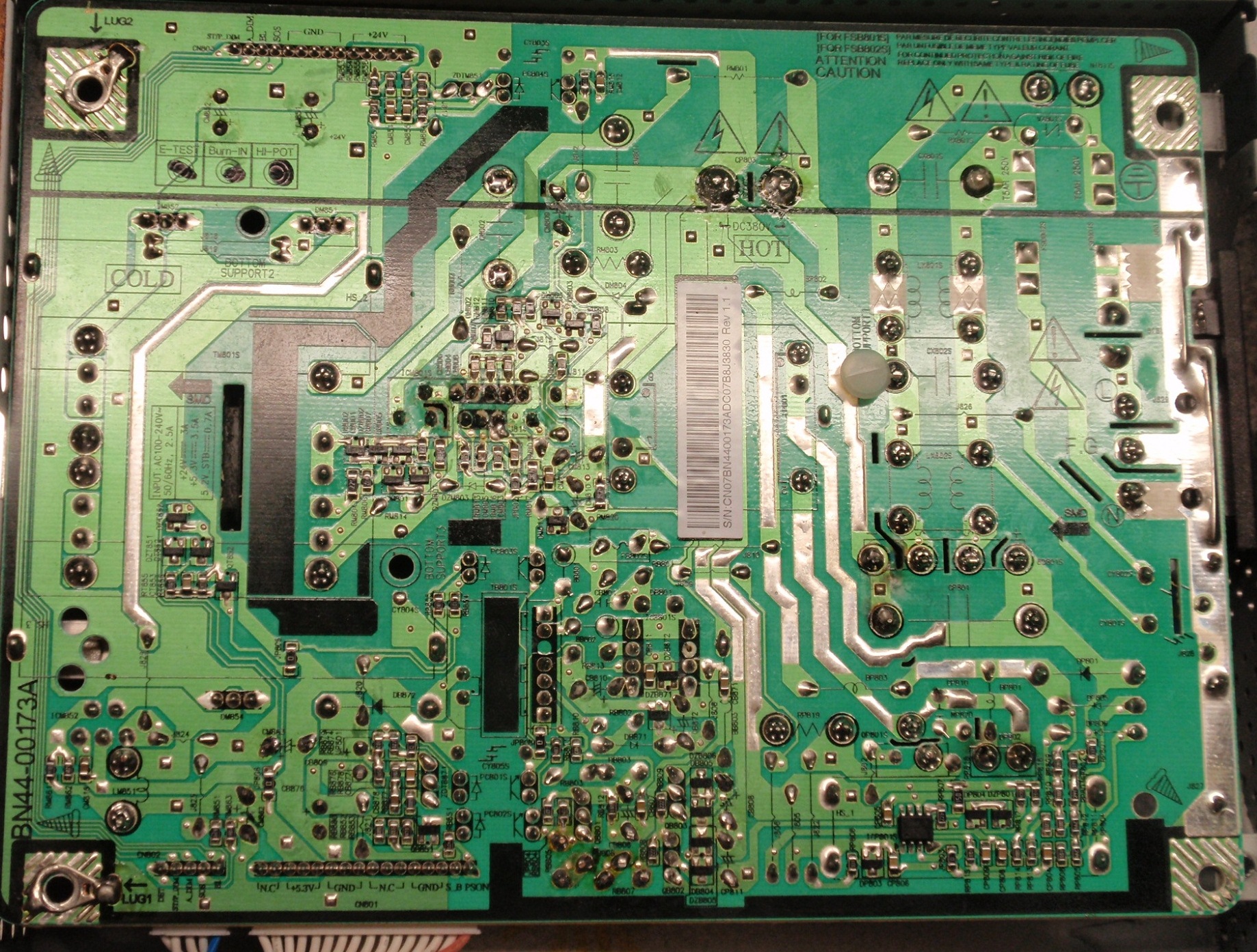

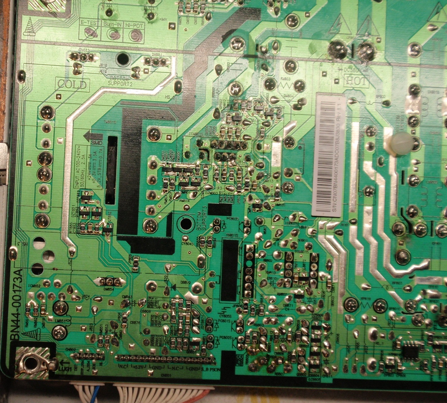

      CLEAR & BIG Photos of the back of your board please.
      Back of board, AC power connection to the right, lower-left 1/4 of board from the transformer to the edge with the 2 connectors.
      T

            Re: Samsung Syncmaster 245BW
            Here they are.
            The IC 801S I have changed and I didn't do a "nice job", some of the pads have lifted off, but they make contact.
            Since these pictures I have replaced that capacitor(470uf/35V) and reinstalled QB802 and everything is back on how it was.
            I have measured again the CP805 and it measures 3.3ohm(with or without it).
