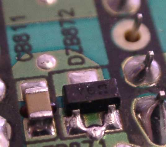

                Can someone with a Samsung Syncmaster 245BW identify on the power supply board the following two zener diode marking on the part ?
                - DZB871
                - DZB872
                Both are SOT-23 packages and start with the "Y" prefix. The next one or two
                digits is what I need.
                Thanks in advance.

                  #128
                  Re: Samsung Syncmaster 245BW
                  I quickly took the back off my 245B. My camera isn't good enough to see up that close without going blurry so using a magifying glass and torch, I could just make out that DZB872 says Y63* on it and DZB871 says Y11. *the 3 appears to be turned 90 degrees forward so it's like the top points to the 3 on a clock face.

                      #130
                      Actually after looking again, the 3 is turned 90 degrees backwards so the top points to the 9 on a clock. It probably doesn't matter which way it points anyway...

                        #131
                        After Googling SOT-23 Y63, I found this PDF: It has the marking codes and type numbers.

                          #132
                          Thanks for looking this up.
                          Regarding DZB872 which has the Y6 marking and a 3 laying down on its side,
                          I'm thinking that it is a Y6 (18V, 0.3W, 5%) zener. The 3 on its side may mean
                          a different code like the batch number. Why would you intentionally print the
                          "3" sideways if there is plenty of space to print it in the same orientation as the
                          Y and the 6 ? By the way Y63 according per the chart is an 8.2V zener.
                          DZB871 with its Y11 marking should be a 30V, 0.3W, 5% zener according to the
                          chart. Need to get these parts and report back.
                            Here are the close ups from mine:
                            Y6 and

                              #134
                              Y6 and
                              Y11
                              Thanks Lucky13 ! We now have confirmation that they are Y6 (18V) and

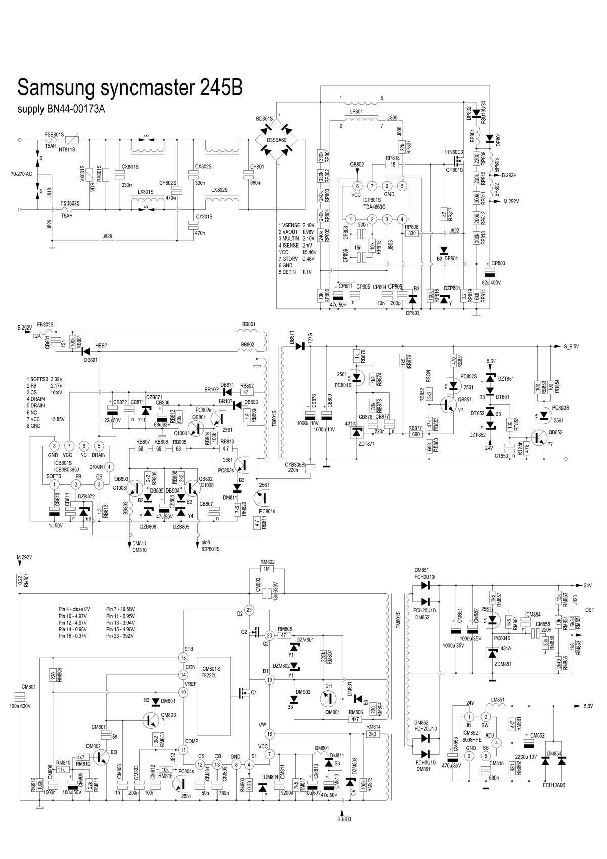

                                        #139
                                        Thanks to Cloepula.
                                        My monitor is fixed.
                                        In my case only QM802 an resistor RB805 defect.
                                        I have drawn the cuircuit by my own.
                                        It missing something because i can't read or meassure the parts.
                                        Somebody to complete this?
                                        Cheers

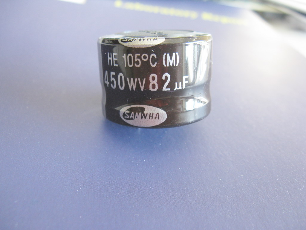

                                          Me to take it apart completly and measure all component one by one. There was somme example in my repair history when even this last resort metod didnt push the piece of equipment to work, but if you dont do it you will never know. One time when i was repairing cheap 350w pc power supply thet have a problem in +5v output, was unstable from 5.3v to 6v and everithing else was ok. After taking all measurement on the component inside this power supply and didnt found anithing wrong, i let it apart and give up . Then maybe in 10-15 days on another diferent pc power supply without any signs of activity found a npn transistor burned and a electrolit with hi esr. When changing transistor and electrolite was done, the supply was alive, but the +5v was unstable just like on the first supply. The joy of this was thet i didnt have exactly the same transistor and i put inside the supply one similar. When change this similar transistor with exactly the same as was the original the +5v become ok. Changing on the first supply the +5v otuput transistor with new one the +5v become ok to. The old transistor i test and was ok when testing with dmm but didnt work corectly when was used in circuit.
                                          We are back ! Was busy at work so this monitor had to wait. For those that have not given up I have good news to report. If your 245B monitor problem is not related to QM802 or RB805 and you have a flickering monitor then the following might help you.
                                          I did not have the 82uF, 450V bulk cap or sometimes referred to as the hold-up cap that allows a line dropout of maybe a 1/2 cycle to go by without
                                          you noticing there was a line dropout but decided to remove it today and
                                          measure it. I do not have an ESR meter but do have a cap meter and
                                          surprisingly it measures 0 uF. I was able to find a 270uF, 450V at hand and
                                          installed it on the board at location CP803 and the monitor turned on with no
                                          more flicker ! This 82uF, 450V cap is from "Samwha".
                                          now that the monitor is working correctly I measure a solid 386VDC on this
                                          cap and my power factor meter shows the power factor is 0.97 versus 0.65
                                          when it was flickering. The 24V output is also measuring a steady 24V.
                                          Another success story regarding BAD CAPS.
                                          Thanks to everyone's help here.
