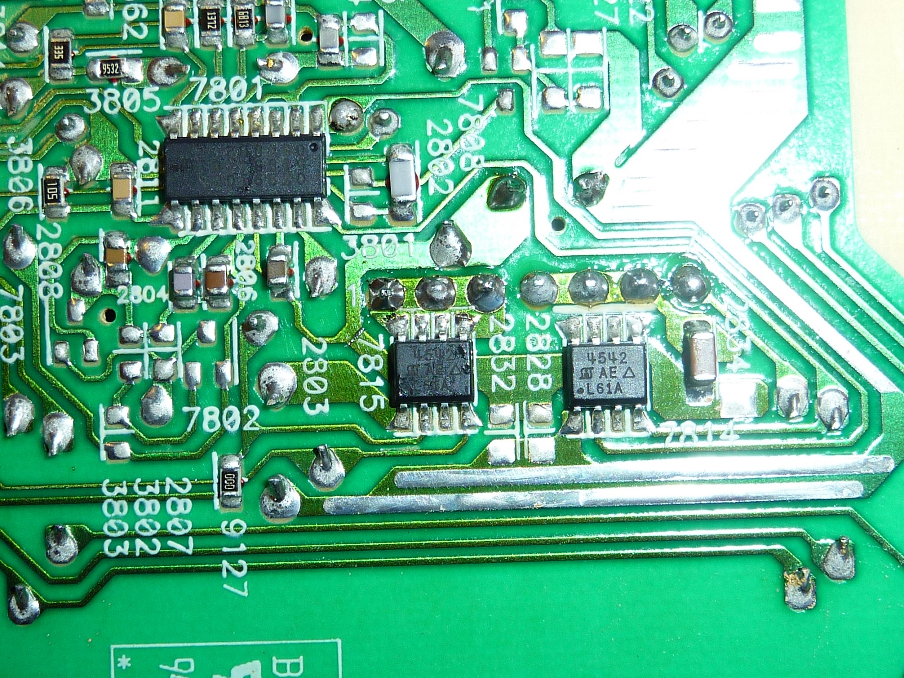

    Check this out
    http://pdf1.alldatasheet.com/datashe...LD/SI4542.html

      bobdee you rock dude i think you solved my problem with that all data sheet link for the complimentry mosfet 8 pin ic
      YAY

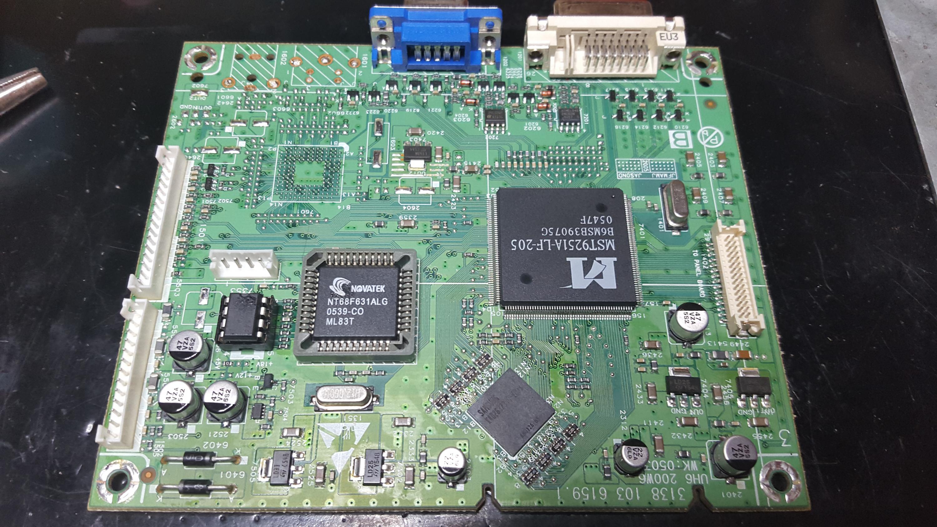

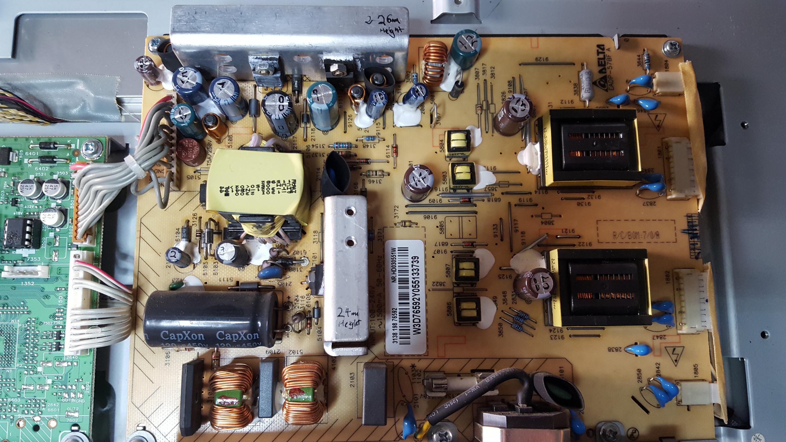

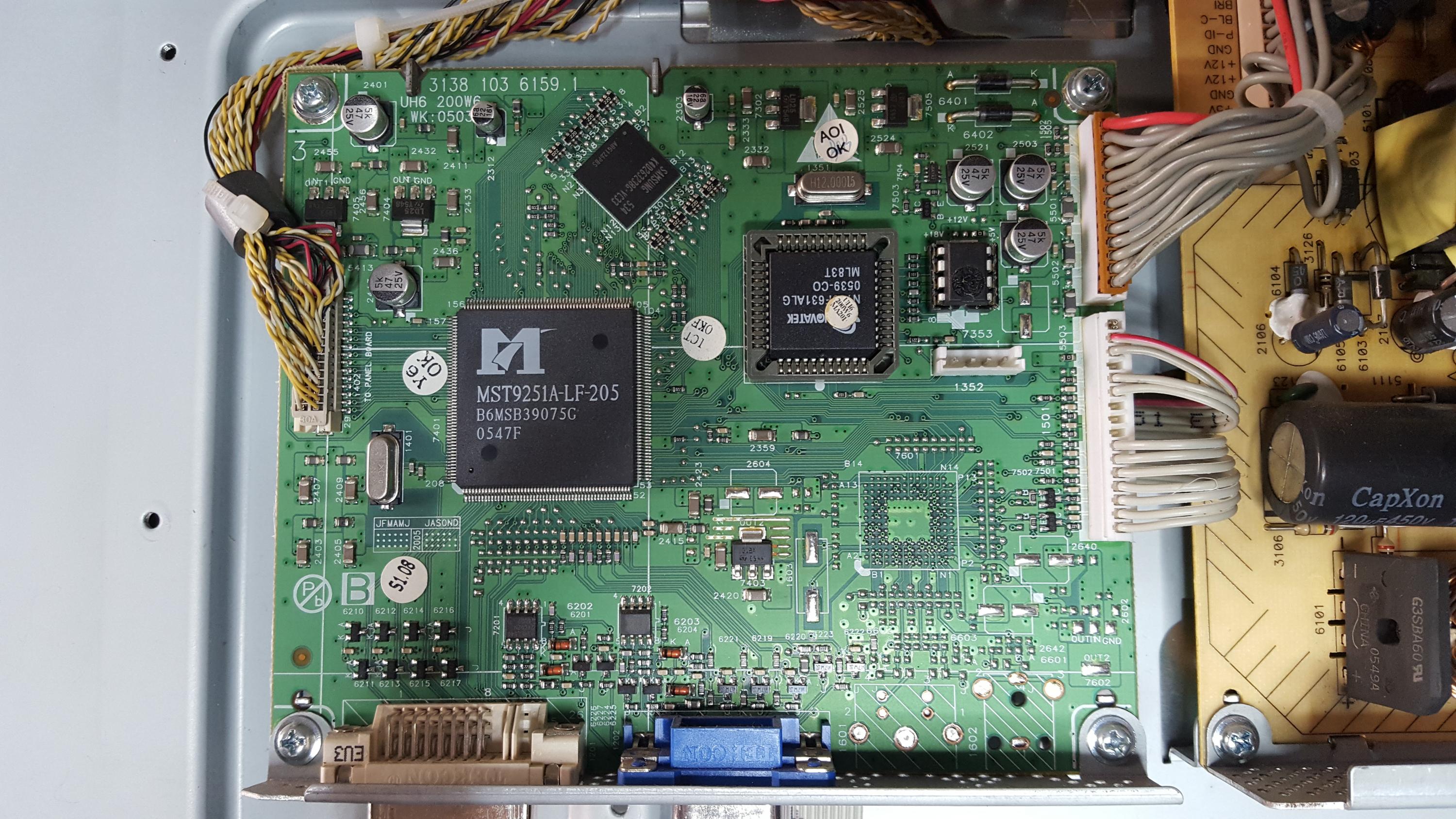

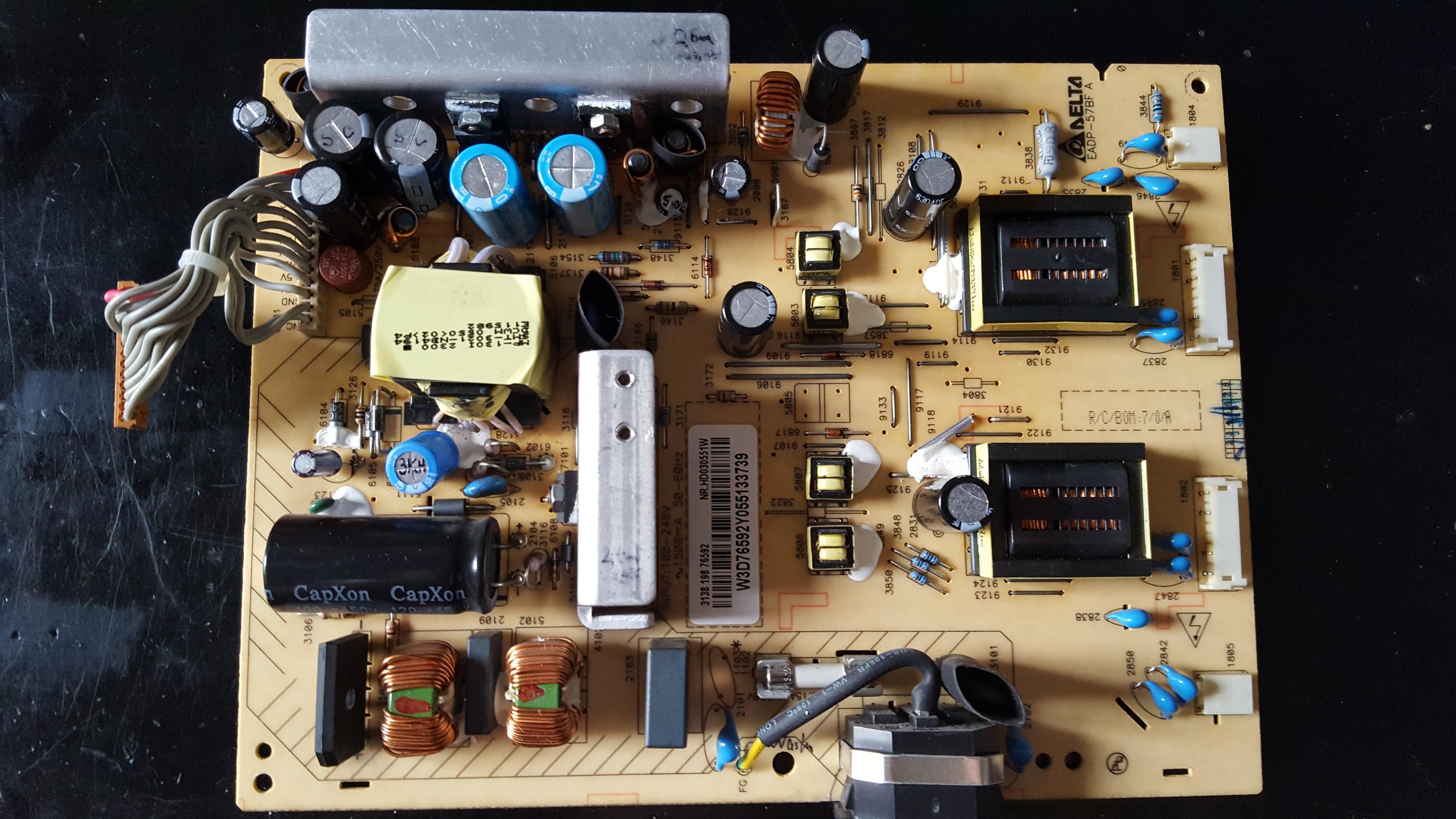

                  I also have a Philips 200W6 monitor - it has been in use since 2006.
                  Recently it stopped working abruptly - so changed all but one of the Power Supply Capacitors (the remaining 120uF 450Volt capacitor is meant to be delivered by the end of this month).
                  It is working again but with an intermittent glitch of image distortion triggered by the moment the BIOS screen gets replaced with the Windows 10 log in screen (DVI input resolution changes?) - sometimes the screen loses a couple of inches in a column on the right hand side with the remaining image compressed but otherwise perfect OR only a one inch column showing a highly compressed Windows log in prompt with the rest of the screen entirely black except for that one inch column - either intermittent glitch can be cleared by power cycling the monitor Off & On which immediately produces a perfect picture - which then stays perfect for several days of boot ups and then the glitch comes back!
                  Can anyone help identify the Seven SMD Capacitors on the Logic Board?
                  There are 5 Marked:-
                  "5k
                  47
                  25V"
                  and 2 Marked:-
                  "6a
                  22
                  16V"
                  Do those markings mean 470uF at 25Volts and 220uF at 16Volts? Or perhaps something else?
                  Any ideas what make and model those 7 SMD's are?

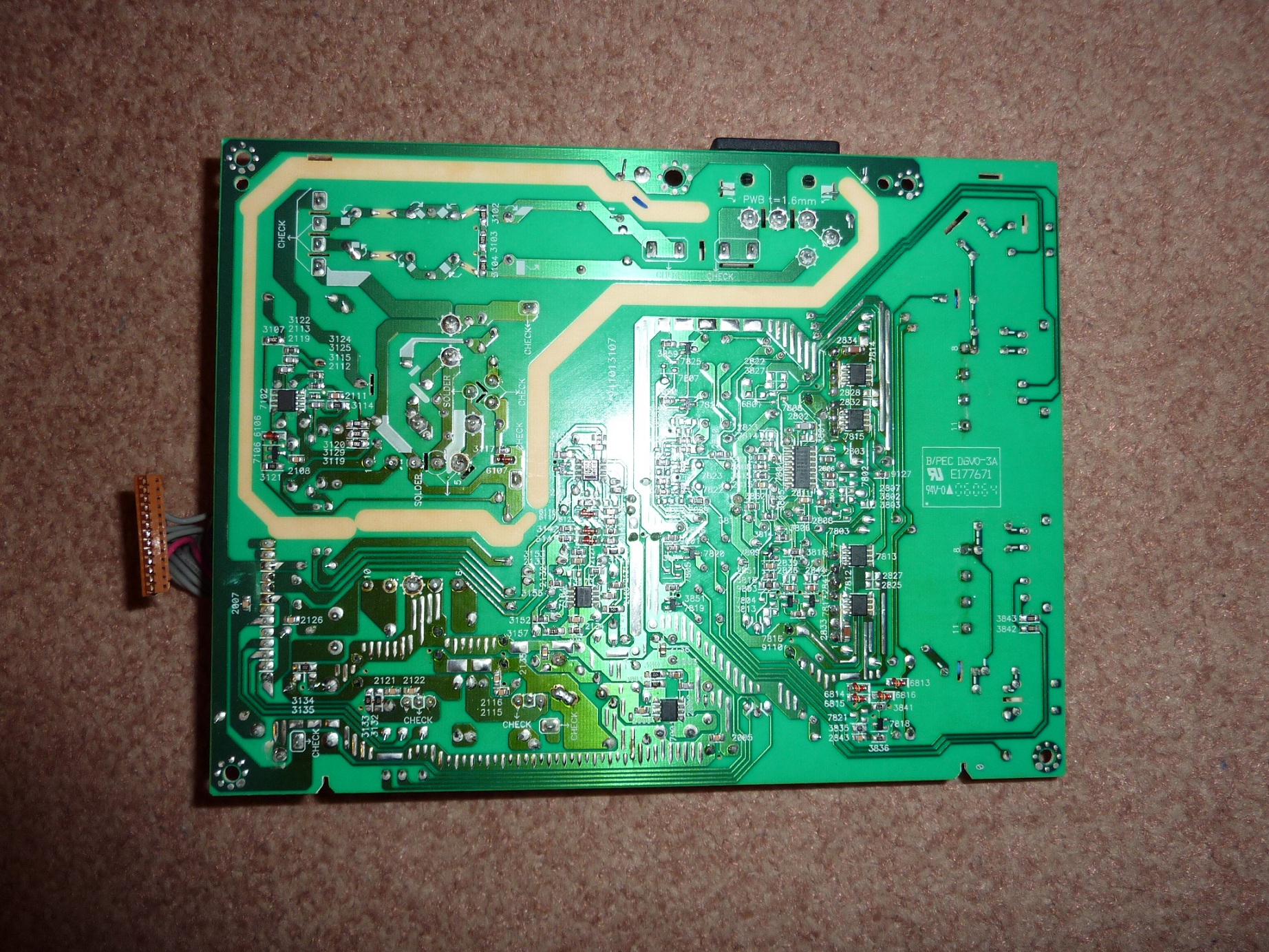

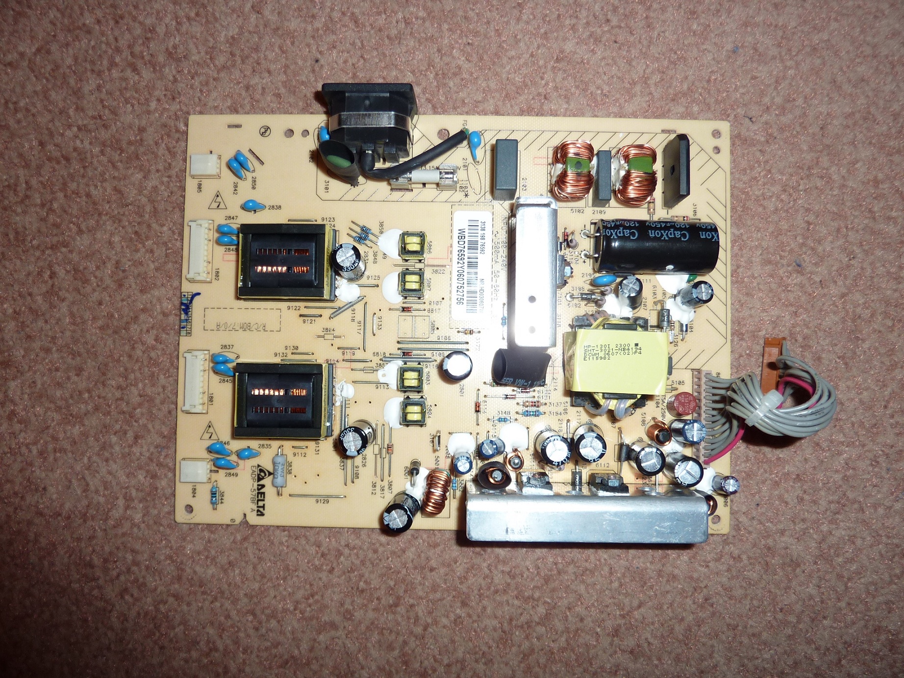

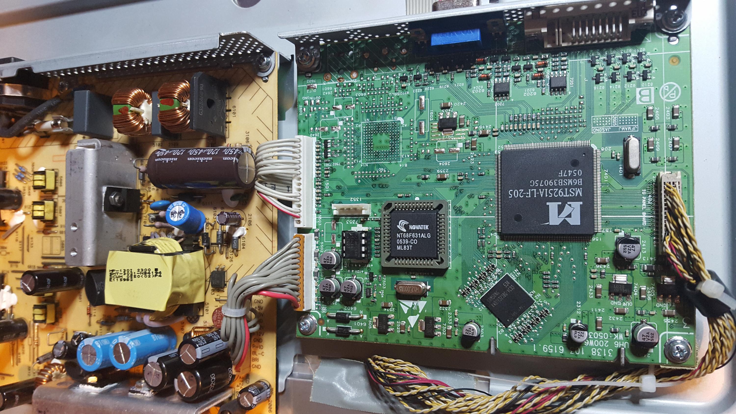

                  Have included a Photograph of the Logic Board - intend to swap those 7 SMD capacitors, re-solder the DVI connector and other suspects (suggestions welcome) if changing the remaining PSU Capacitor still leaves the glitch.
                  Will also re-solder the heavier connections on the PSU and the ones factory marked as "Check" on the solder side of the board when I take it out again to fit the remaining capacitor - see the thread starters photo of the back of the PSU PCB.
                  Have posted up before and after Photos of my PSU (I think the thread starters PSU photo is a before photo as the white glue seems intact) - it is noteworthy that the Capacitors I have numbered 3 and 8 are 125 Celsius capacitors the rest all being 105 Celsius capacitors - Looks like Philips changed the capacitor specifications during the production run as it became aware of premature failures. I changed Capacitor 9 to a 125 Celsius version also.
                  Ideas and suggestions for fault finding are welcome.

                    Re: Philips no Backlights
                    Those caps would be 47uf/25V & 22uf/16v
                    • UHU
                      • Sep 2016
                      • 35
                      Thank you R_J - you were absolutely right about those capacitor values.
                      Took it all apart again to finish the job - it was still working when I disassembled it - just with random bouts of mangled garbage display (but no more missing image) at power on (power cycle to clear) - then discovered the top right hand side (next to PSU) screw holding the Logic Board to chassis was loose and as I had not touched anything else yet tightened it and tried power on - thinking it was only intermittently earthing and that was causing the weird problems (have had similar issues on some odd designs of PSU's) - instead now it is dead as a doornail!
                      A feeling of doom washed over me - how could tightening one screw render a monitor dead? By now couldn't care less.
                      Took it apart and fitted the replacement mains inlet capacitor - finally completing the PSU rebuild.
                      Then removed the Logic Board and changed the seven capacitors, re-flowed the solder on the following parts:- two hefty diodes, all the board edge multi-pin connectors, DVI socket and just for good measure the unused VGA socket.
                      Reassemble and it immediately powers on - seems fine - plug into PC still fine - actually the picture is now so sharp/vivid it is almost too much - literally eye-watering.
                      There I was suspecting I might need glasses for computer screen work - NO my vision is in fact still perfect!
                      Turns out just the monitor logic board capacitors gave a strange intermittent blurriness - like a slight ghosting blur around letters on screen - all gone now.
                      After an initial week of enduring a thermonuclear style of monitor display either I got used to it or the parts/repair burnt in and calmed down.
                      About a month has passed since then and the monitor has not misbehaved or skipped a beat even once.
                      Here are some photographs
